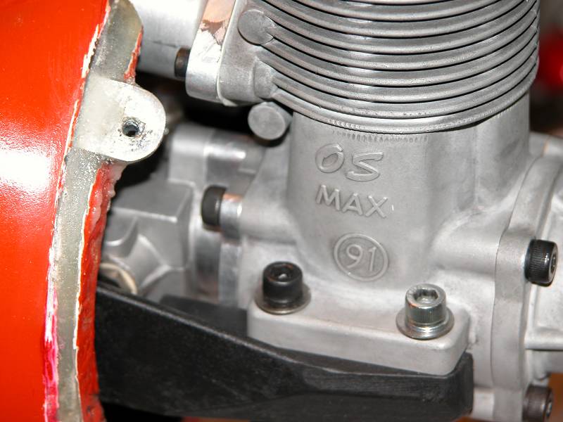

good call on the ca hinges And the nylon screws - but would only want flush or low profile heads
Hey Chris - after a few cycles and the cowl gets beat to #%*@ then any further abrasion won't worry you so much
Just start painting your new cowl now - Make two
