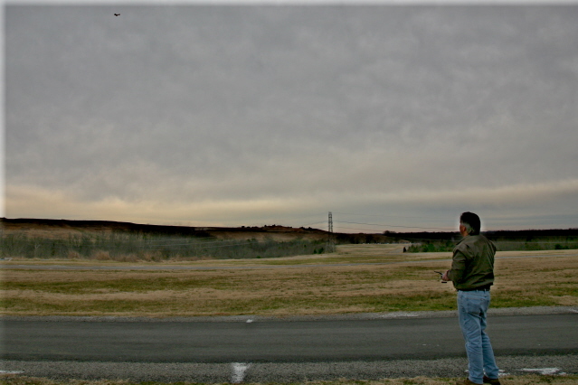

I assembled a Phoenix Models Strega with a Tower .46, Jett remote needle valve, Jett muffler, Jett bubbleless tank and 10x6 prop. Weight w/o fuel is 5.35lbs. Here are a few photos of the initial flights at Lowes Motor Speedway flying field. For time savings, I kept the original orange color. The plane would look much more eye-appealling with almost any other color in my opinion. The time to strip and recover would be worth it in hindsight. There are a few adjustments I need to do. I had to add a Great Planes 2oz. spinner weight to get the CG right. I don't like the idea of a spinning weight on the nose, so I'm planning on removing and adding dead weight to the firewall. The 4-cell 700mAh NiCd rx battery is as far forward as it can be mounted. Also, need to tone down the throws and add more expo. Seems pretty sensitive with manual recommended throws and 40% expo. Any suggestions for a different prop size?
If the plane can survive my flying skills, I plan on flying it at the May 15, 2010-Julian, NC -Old Julian Airport Warbird pylon races. Here are the rules for this class of pylon planes:
http://www.rcpro.org/html/rules/warb...cing_rules.htm

Great looking Flying Pumpkin. I like my Strega in Orange, all three of them, and all my SRMII's are Orange but, I am getting old eyes and with the white trim I put on them they are easy to see.
I would try a 9X6.5 or a 9X7 depending on the wind and let the motor scream. You won't be able to pull the pylons as hard with the 9X7 but the extra speed might be worth it. It would be like taking the high line around the track at a NASCARSuper Speedway.
Anyway Dave, you will have fun.

We run an APC 9.5x6 or a 10x5 on the T-34s we race out here. The 10x5 is for the guys that run right on the pylons and the 9.5x6 is for the guys that try to make a smoother and slightly wider turn. We use the 46 AX stock and it's a 650' two pole course.

I think I have some APC 9.5x7 Pylon props here. They would work on that setup. If it doesn't get up on the pipe, just trim the tips down to 9.25" or to 9". Remember, there are no prop limitations in RCPRO Warbird Racing. I wouldn't go smaller than 9" on that airframe though.
You have to get used to the tuned mufflers. You might not have gotten it fully on the pipe yet.

Thanks all, Once I get the spinner weight/CG issue settled, then I'll tone down the throws. Chris, I thought I'd start at 1/2 of the rec. throws and gradually decrease as needed, and then I saw your post. Bingo! I have several different 9" props that I'll put through some test flights. What type of spinner are you all using? The plastic cone-type is not my favorite. Tru-turn or spinner nut?

I tested two props today. Results: 9x6=17410, 9.5x6=16600. Did not try the 10x6, but I'd guess it be just short of 16k. BTW, I felt the 9x6 performed better for me in the air today than the 9.5. These are all APC sport props. Any reason to use or not use an APC "pylon" or competition prop?

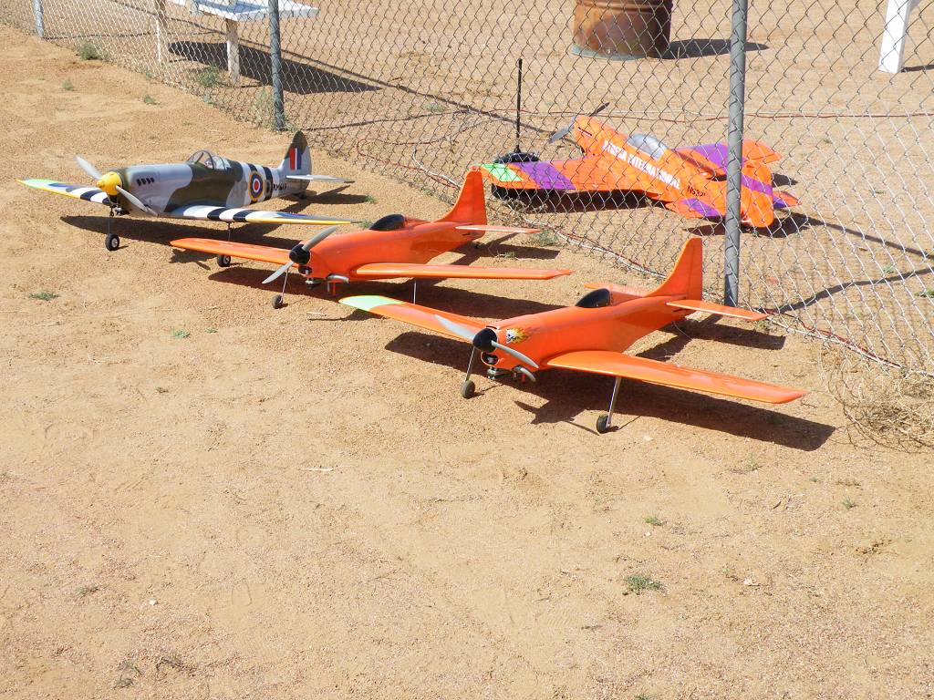

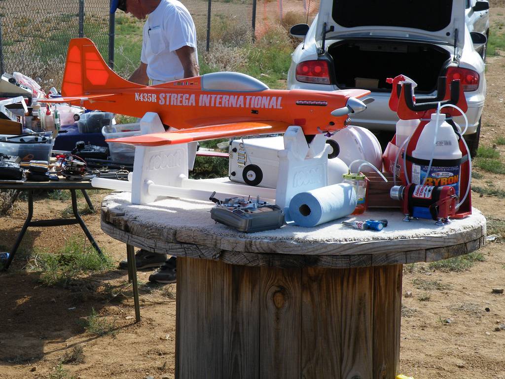

My PM Strega with a TT PRO .61 w/Ultra Thrust pipe is a great Silver Class Warbird. I just built it straight and it is a runner. I see lots of them at the RCPRO Warbird races and they run great in all three classes but, I think for Gold they have to be reinforced a bit in the wing and the horizontal stabilizer. My next three are all Stregas and the last two will be modded to look more like the real Strega and one of them will be a Gold Class plane.

Hey Barry,
For those who care, in the your picture on the left are Carry Buschbaum's planes. The spitfire on the left is a Phoenix models spit and he won the Silver class with it last season going away. He even missed the final two races and still easily won. The Strega in the center is what he won the gold class with the year before. The Strega on the right has a custom wing and Tucker, Carry's son would have won Gold with it last year if he hadn't missed the final two races when they moved to Texas. The Stregas will move well and they groove on the race course very well, especially with a YS 1.10 in them.

Default RE: Strega Warbird for Pylon Racing
Thanks Terry, I knew you would be along to tell the reall story on those planes. I do remember i shot those pictures at Kingman. I wish we were coming out West so i could be racing with you guys this year.
