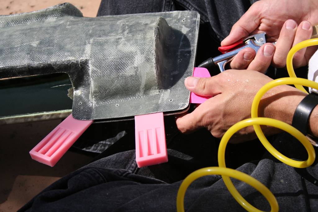

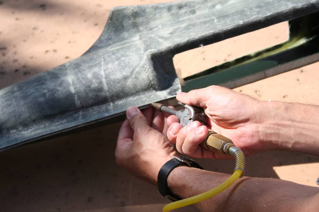

Old 04-29-2010 | 03:20 PM
  #158
Iron Dog's Avatar
Joined: Feb 2009
Posts: 1,354
From: Sacramento, CA
Default RE: Warbird Racer Trinity-build
#1. Here you can see where the part has begun to separate from the mold but the PVA is still stuck tothe part.(darker green), and where the PVA has separated from both the mold and the part (lighter green).
#2. Getting the wedges in there.
ID:	1427866   Click image for larger version
Old 04-29-2010 | 03:22 PM
  #159
Iron Dog's Avatar
Joined: Feb 2009
Posts: 1,354
. . . and running them all around the outside of the molds, while continuing to utilize air pressure.
Old 04-29-2010 | 03:25 PM
  #160
Iron Dog's Avatar
Joined: Feb 2009
Posts: 1,354
#1. "This one is being really stubborn, Casey!"
#2. Finally, it is coming loose.
BUT, I heard a crack that didn't sound good!</p>
ID:	1427876   Click image for larger version

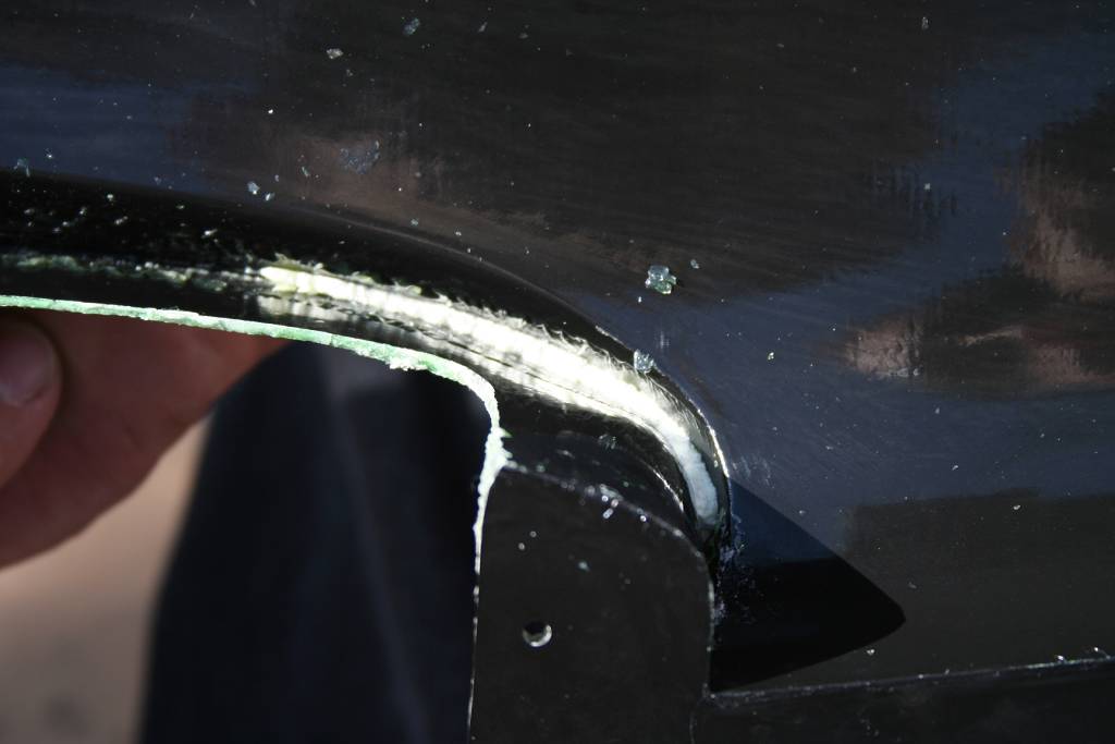

Old 04-29-2010 | 03:29 PM
  #161
Iron Dog's Avatar
Joined: Feb 2009
Posts: 1,354
That crack was my wing fillet breaking. Okay, that is frustrating! But it is time to free this thing once and for all.
ID:	1427881   Click image for larger version

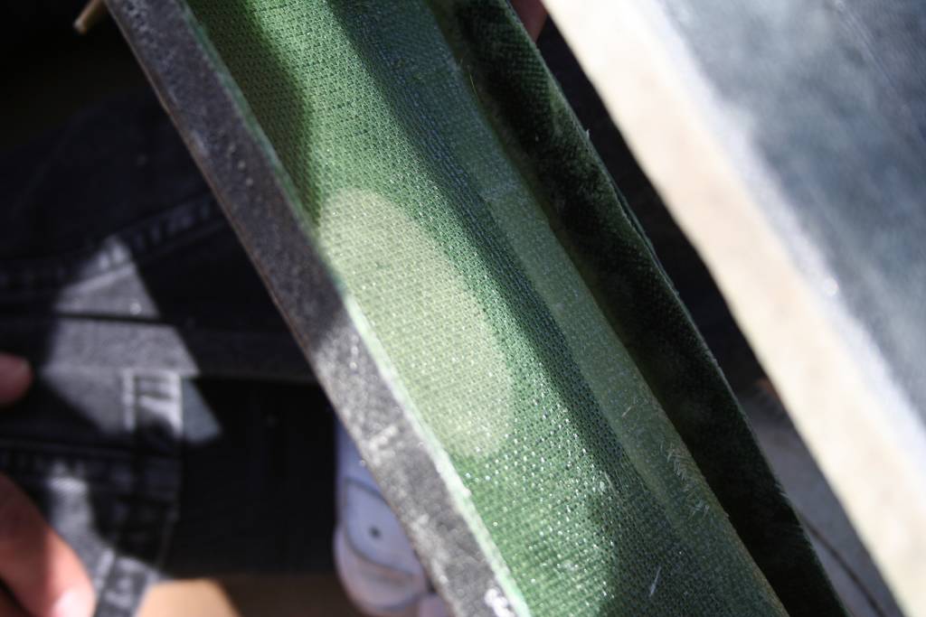

Old 04-29-2010 | 03:36 PM
  #162
Iron Dog's Avatar
Joined: Feb 2009
Posts: 1,354
Yeah, Ifound that I did not get enough PVA into thenarrowest part of the fillet. Thiscaused some distortion effects(called either "alligatoring" or "orange peeling")and broke the other fillet off inside the mold, too!
This is why when I re-do the P-39 mold I am adding a third part to the bottom. That should help with getting the fillets out in one piece, consistently.
ID:	1427883   Click image for larger version
ID:	1427884   Click image for larger version
ID:	1427885   Click image for larger version

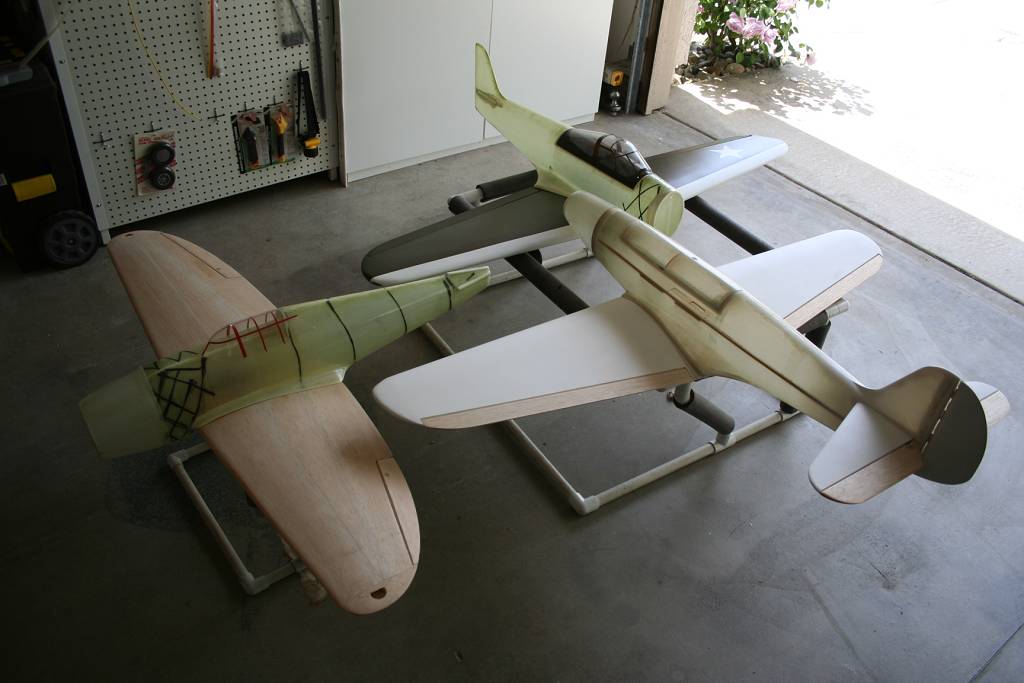

I've got a friend coming up from out of town, so I won't be able to make it to the swap meet. (I've still never been to one!)
Old 04-30-2010 | 01:09 AM
  #166
Iron Dog's Avatar
Joined: Feb 2009
Posts: 1,354

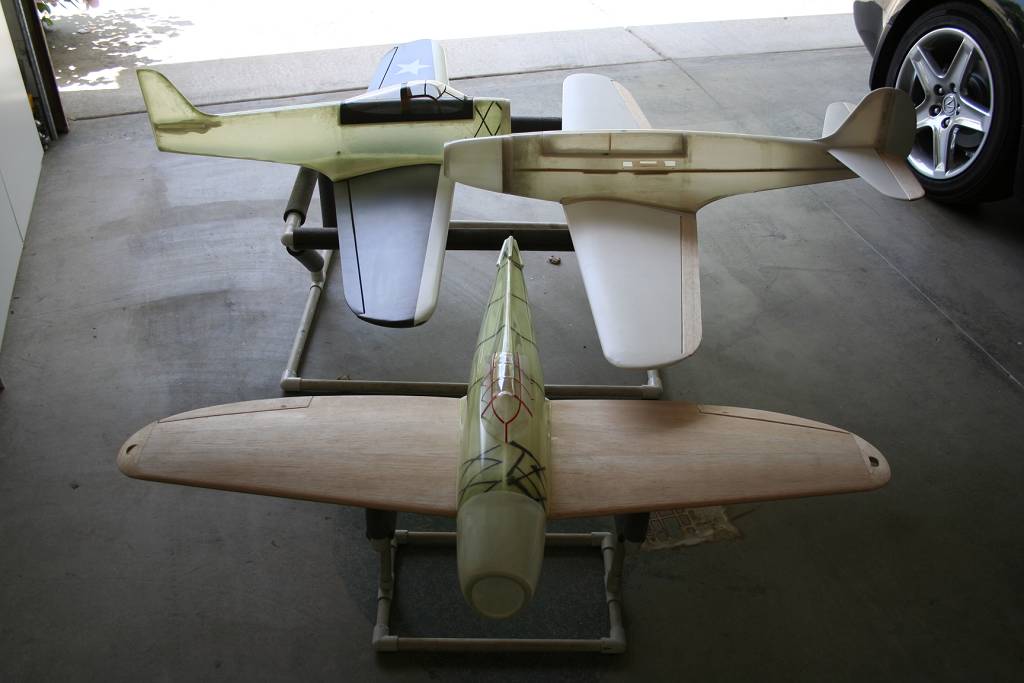

Not quite the correct "Trinity", but a trinity nevertheless. Here is the P-47on its brand new, ready-to-coverwing. The new P-39 fuse is in the background, on an old wing. (I cartwheeled the last P-39 and only the wing and the hatches survived, so I am puttingthemto use with this fuse.) I also have another P-39 that I've had just aboutready to paint for almost a year now. I just have to cover the ailerons and elevators and glue them in, and fabricate the rear hatch cover. All three of these will be olive drab, so I was hoping to prep and paint them all together, at the same time.
The newP-51 (still in the mold, so it is not pictured) will be modeled after the Red Baron, but because Ron (fromDowntown Hobbies)and "Bushman" already race multiple Red Barons in its traditional markings, I am going to do a custom color scheme so they can be distinguished from each other.
It has sucked not having a plane to race for the last two years. My goal with this build was to assure I wouldn't find myself in that position again. Assuming I don't crash any in the meantime, when I am done, I will have 2 P-39s, 2 P-47s, and 2 P-51s. That ought to keep me in raceplanes for awhile, so I can start working on new projects, without worrying about not having a plane to race.
ID:	1428260   Click image for larger version
ID:	1428261   Click image for larger version
Old 04-30-2010 | 01:26 AM
  #167
Iron Dog's Avatar
Joined: Feb 2009
Posts: 1,354
Back to the last model of the true trinity of this build . . . the P-51:

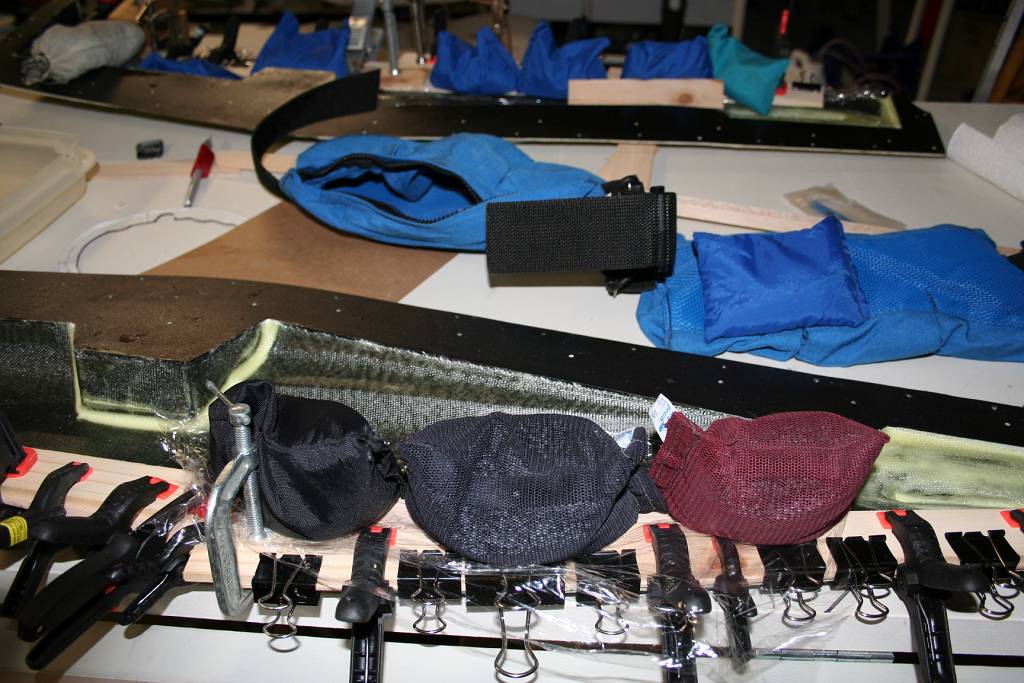

The P-51 has different construction being a U-shaped fuse with an open bottom. I need to glue cross-grain balsa on the bottom to close it up eventually. But, this means that I need something more substantial that 2 layers of FG cloth to glue it to. So, it gets a piece of 3/32" balsa sheet, followed by another layer of FG cloth. This sandwich construction makes it very rigid, and also absorbs the stresses of the wing saddle during hard landings, beings there are no fillets on this model. (Without a fillet, the edge of the fuse side would be so sharp it would cut through the wing sheeting.)
Here, I am clamping &amp; weighing down the sheeting to the sides of the fuse after applying epoxy, to ensure a good bond. Also being a scuba diver, I found another use forthe ballast from my weight belt. It comes in handy keeping the top edge of the balsa sheet in contact with the fiberglass fuse sides that are too far from the bottom for my clamps to reach.
I put plastic wrap over the top so I don't accidentally glue my ballast to the side of the fuse. Otherwise, I can just see it now, "Gee, this planeflies like a brick!"
ID:	1428269   Click image for larger version

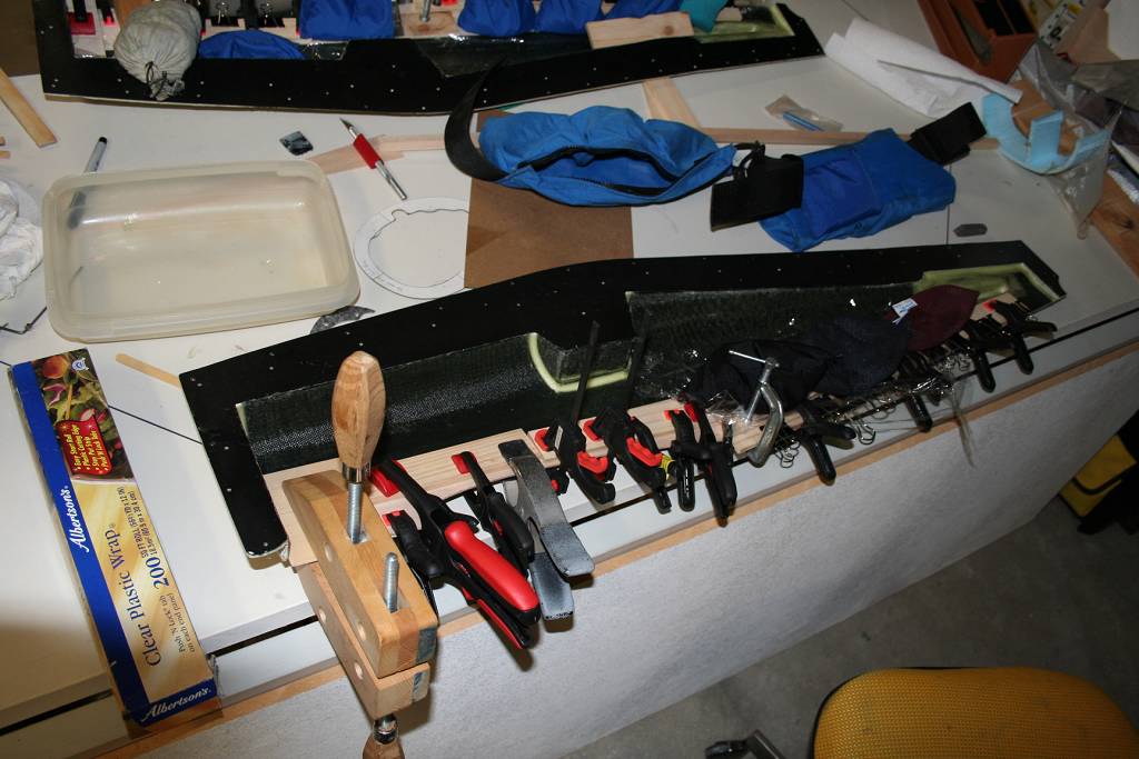

Old 04-30-2010 | 01:35 AM
  #168
Iron Dog's Avatar
Joined: Feb 2009
Posts: 1,354
Unclamped, here goes the other piece of glass over the top of the balsa sheet, to complete the 'sandwich' structure.

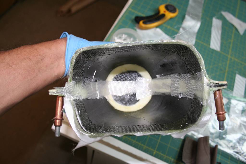

While the last layer of cloth on the P-51is drying, I start laying up the cowls.
It follows the same basicprocedures as with the fuses, so I won't bother to repeat myself in outlining all the steps . . . aside from stating that I like to wet out the cloth from the middle of the strip, working outwards.
This is the P-39's cowlreceiving its second layer of cloth.

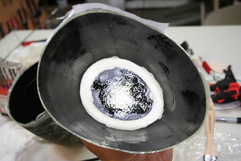

Old 04-30-2010 | 01:44 AM
  #170
Iron Dog's Avatar
Joined: Feb 2009
Posts: 1,354
Here's the fabrication of the 2-part RedBaronP-51 cowl. Notice the relief cuts and the overlaps at the spinner backplate area.
ID:	1428276   Click image for larger version
Old 04-30-2010 | 01:46 AM
  #171
Iron Dog's Avatar
Joined: Feb 2009
Posts: 1,354

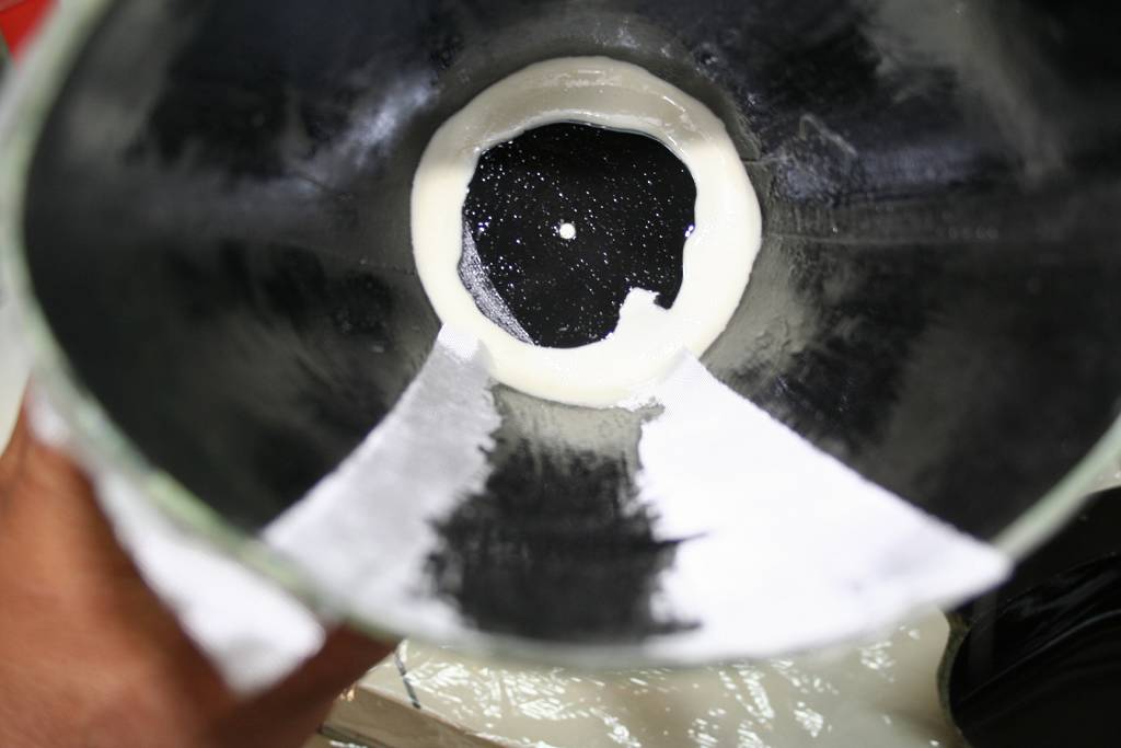

Next, the P-47 cowl receives its layers of cloth, while the P-51's layers start to harden.</p>
ID:	1428278   Click image for larger version
Old 04-30-2010 | 01:51 AM
  #172
Iron Dog's Avatar
Joined: Feb 2009
Posts: 1,354

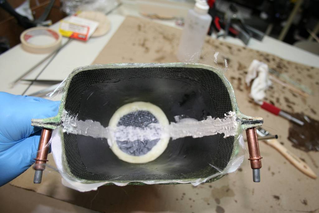

After it is tacky, I mix up another batch of resin.
I pour half into another cup and mix in microballoons. (I keep the other half to use later, when wetting out theseaming strip of FG cloth.) I skip the chopped fiberglass this time, because it was a pain in the butt to work with when I did the fuses!
I install my Klecos to hold the halves of the mold tight.</p>
ID:	1428280   Click image for larger version

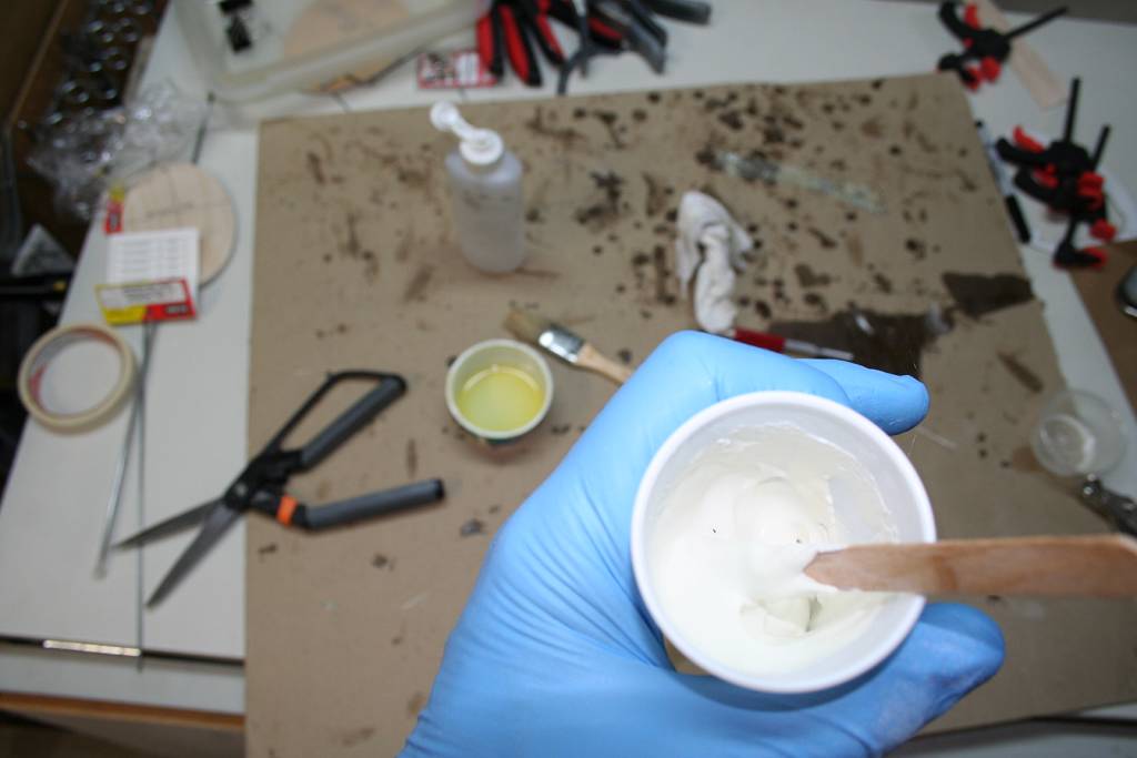

Old 04-30-2010 | 01:53 AM
  #173
Iron Dog's Avatar
Joined: Feb 2009
Posts: 1,354
Seal up the gaps between the cloth on the halves and the line/gap where the two halves of the mold meet with the mixture.
Old 04-30-2010 | 01:54 AM
  #174
Iron Dog's Avatar
Joined: Feb 2009
Posts: 1,354

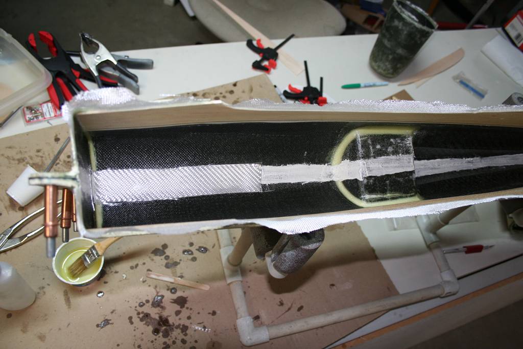

Apply cloth strips and wet them out.
ID:	1428283   Click image for larger version

Now, do the same with the P-51 fuse:
Klecos . . . microballoons mixture . . .apply cloth strips . . . wet them out.
