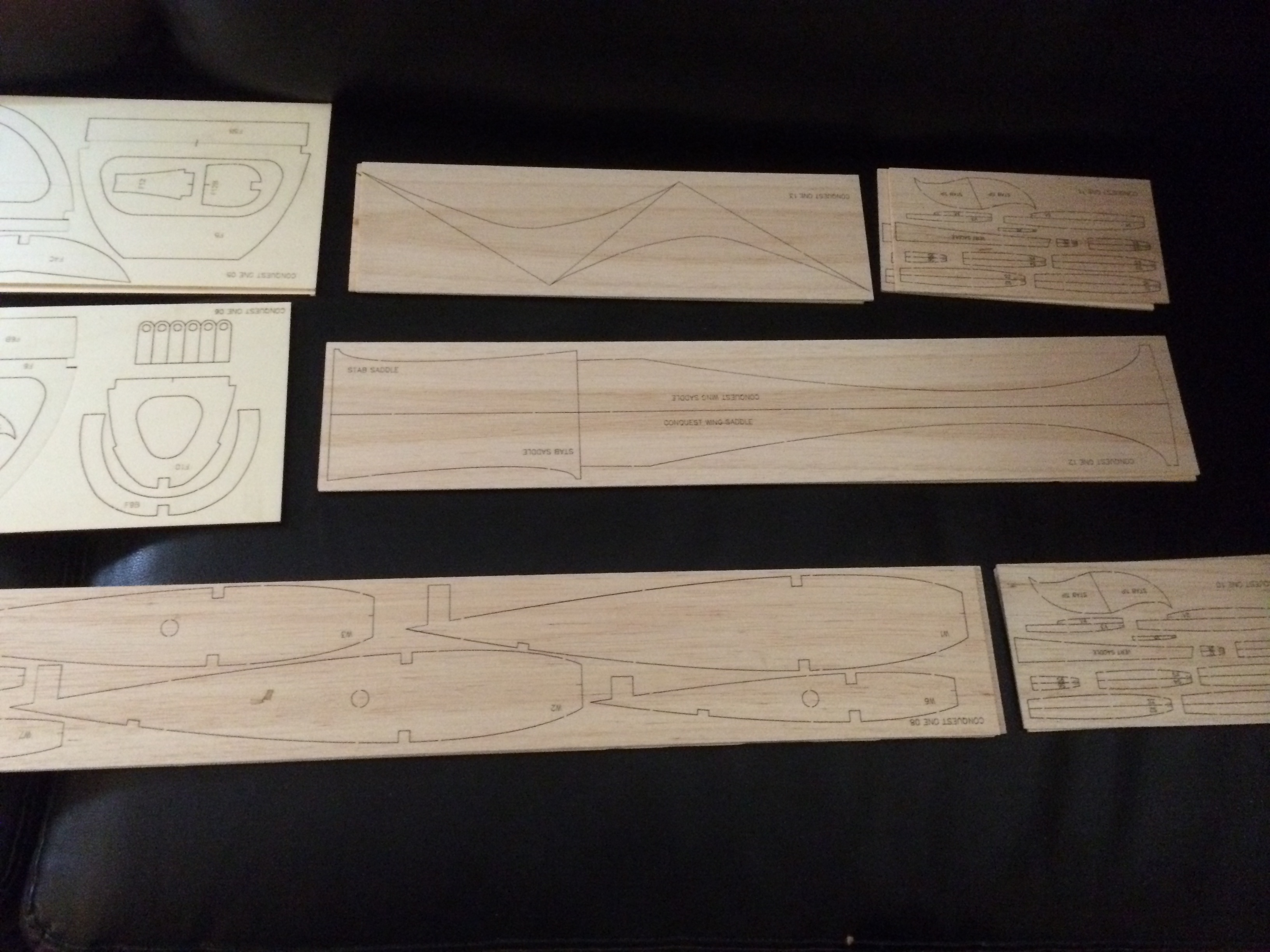

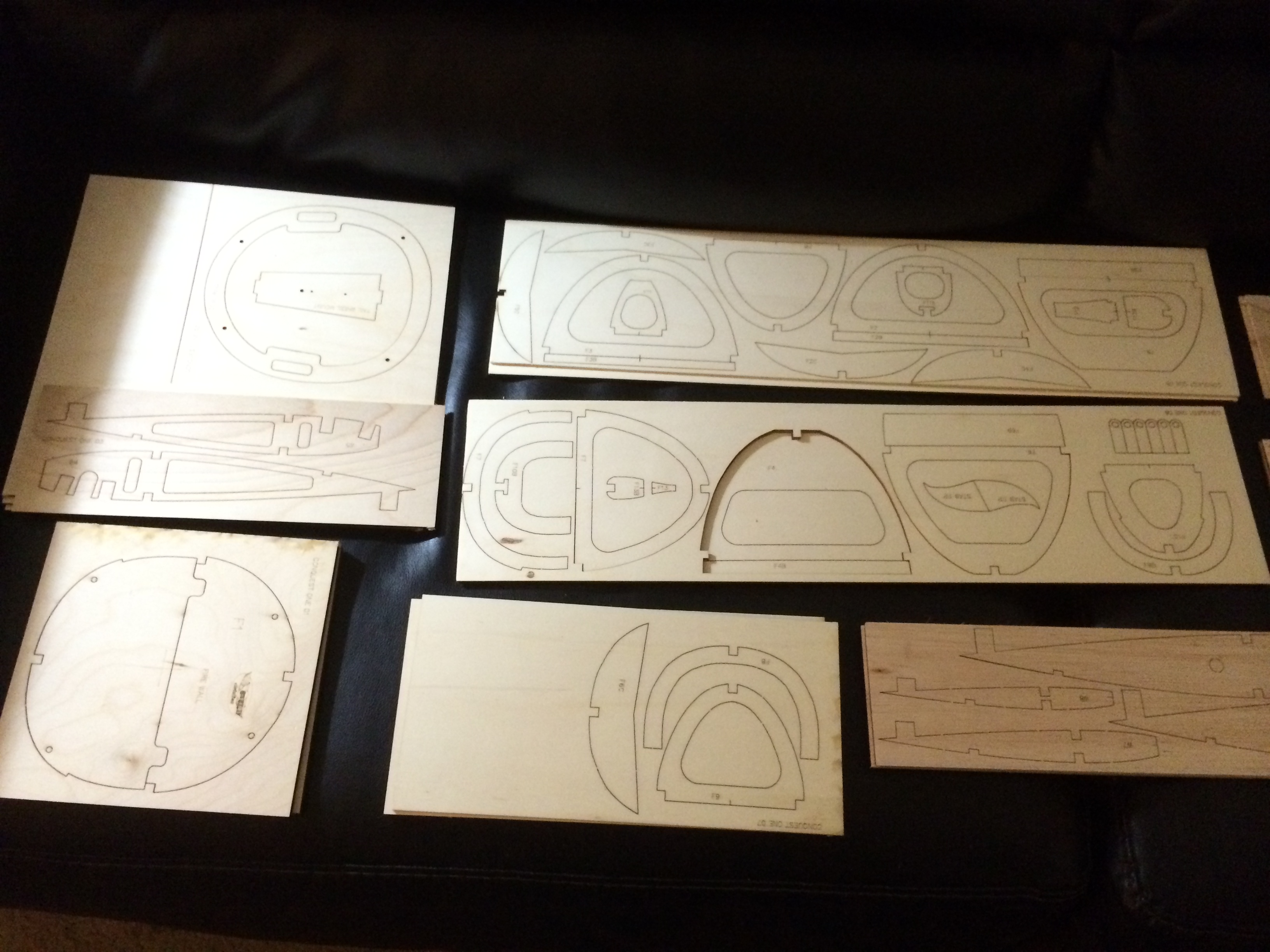

The Conquest 1 is underway. I should be ordering parts by Friday.
Here are some teaser pics..http://www.rcuniverse.com/forum/atta...mentid=2014570http://www.rcuniverse.com/forum/atta...mentid=2014571
Tim

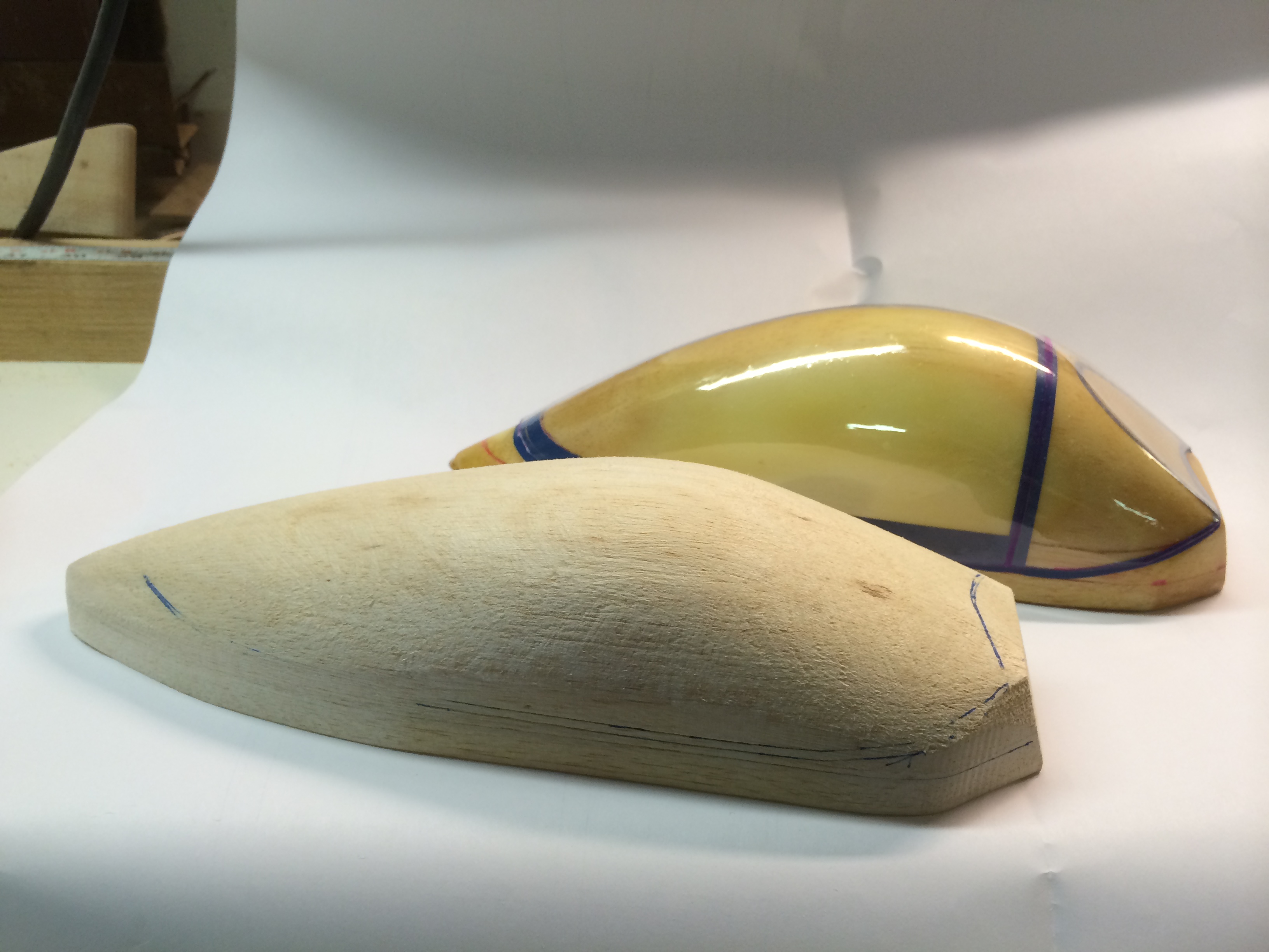

Working on the canopy plug. Yes it has been a long time
pjakew 06-21-2015 11:01 AM
Geez, I thought I was a slow builder!

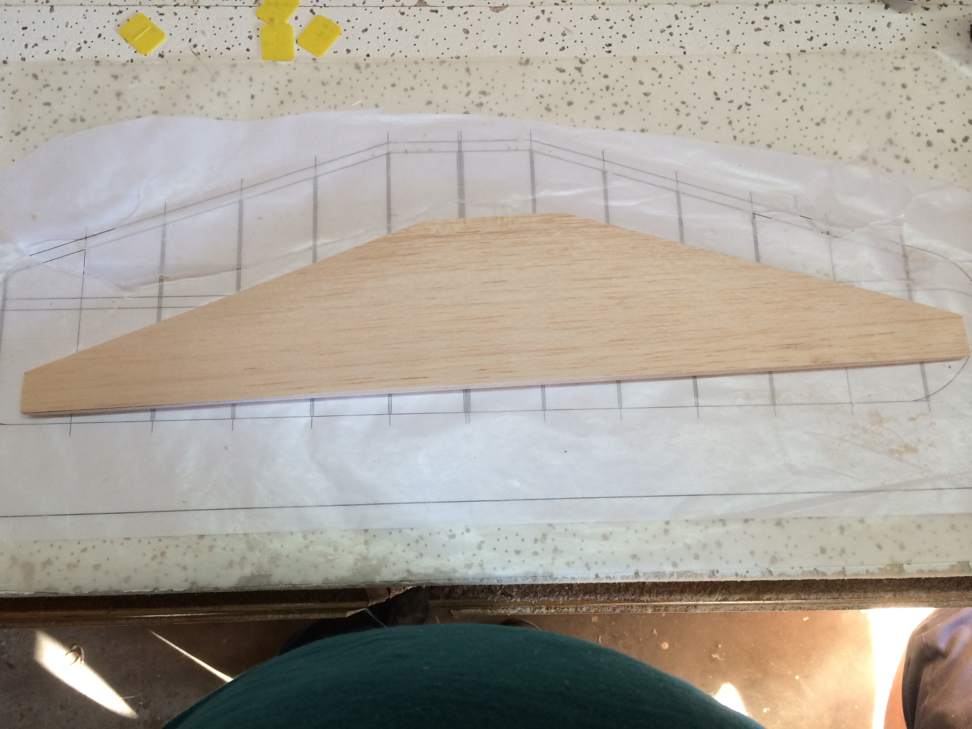

tdstaf 12-02-2015 05:46 PM
5 Attachment(s)
Ok. After working on getting the Czech Mate ready as well as Jeff's smaller size Tsutonami I had a few minutes Sunday during the time Eric Jaggi was getting caught up on the Czech Mate group build ( Found on another thread here) to do some work on the Conquest 1.
http://www.rcuniverse.com/forum/atta...mentid=2133595

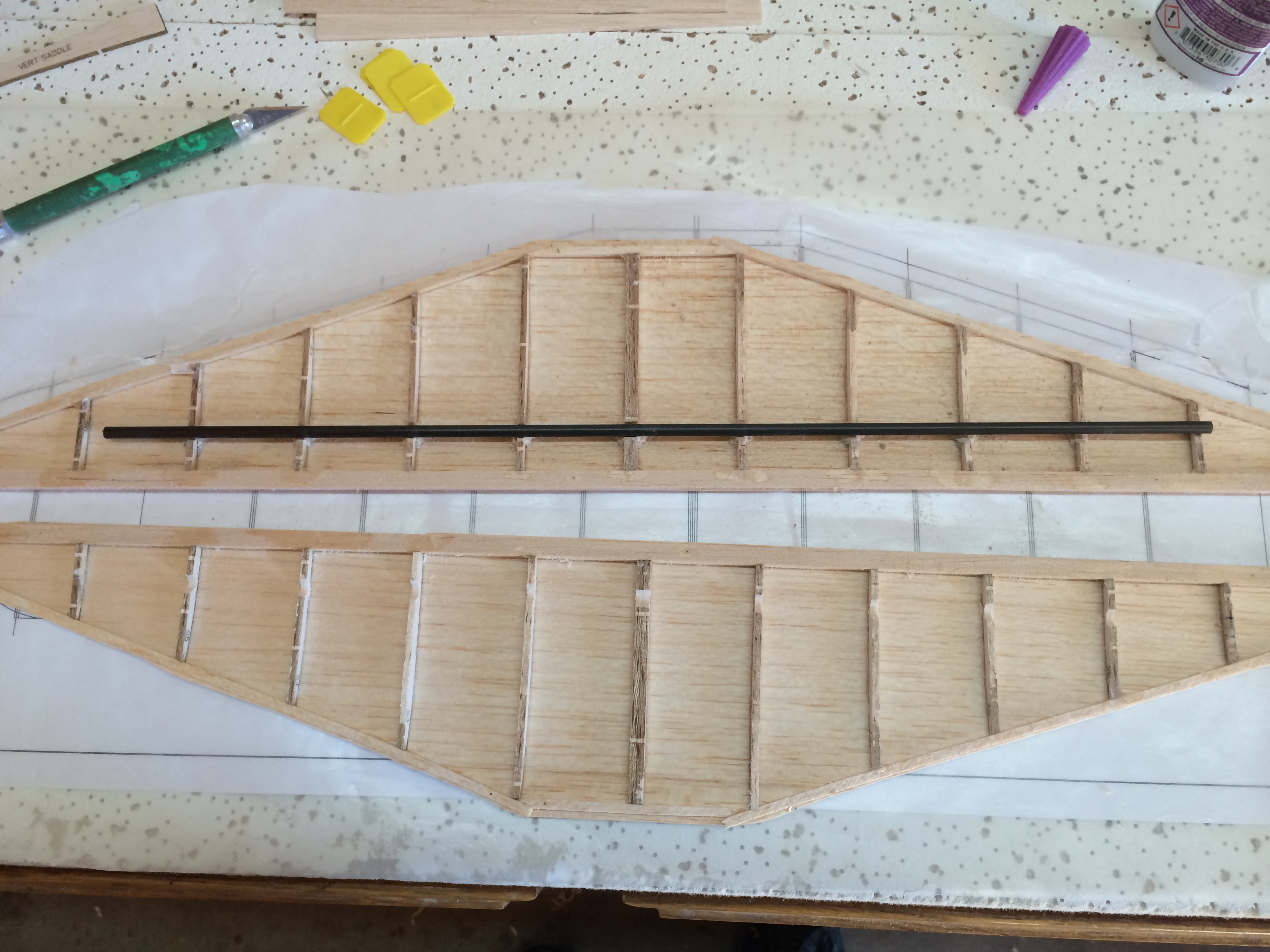

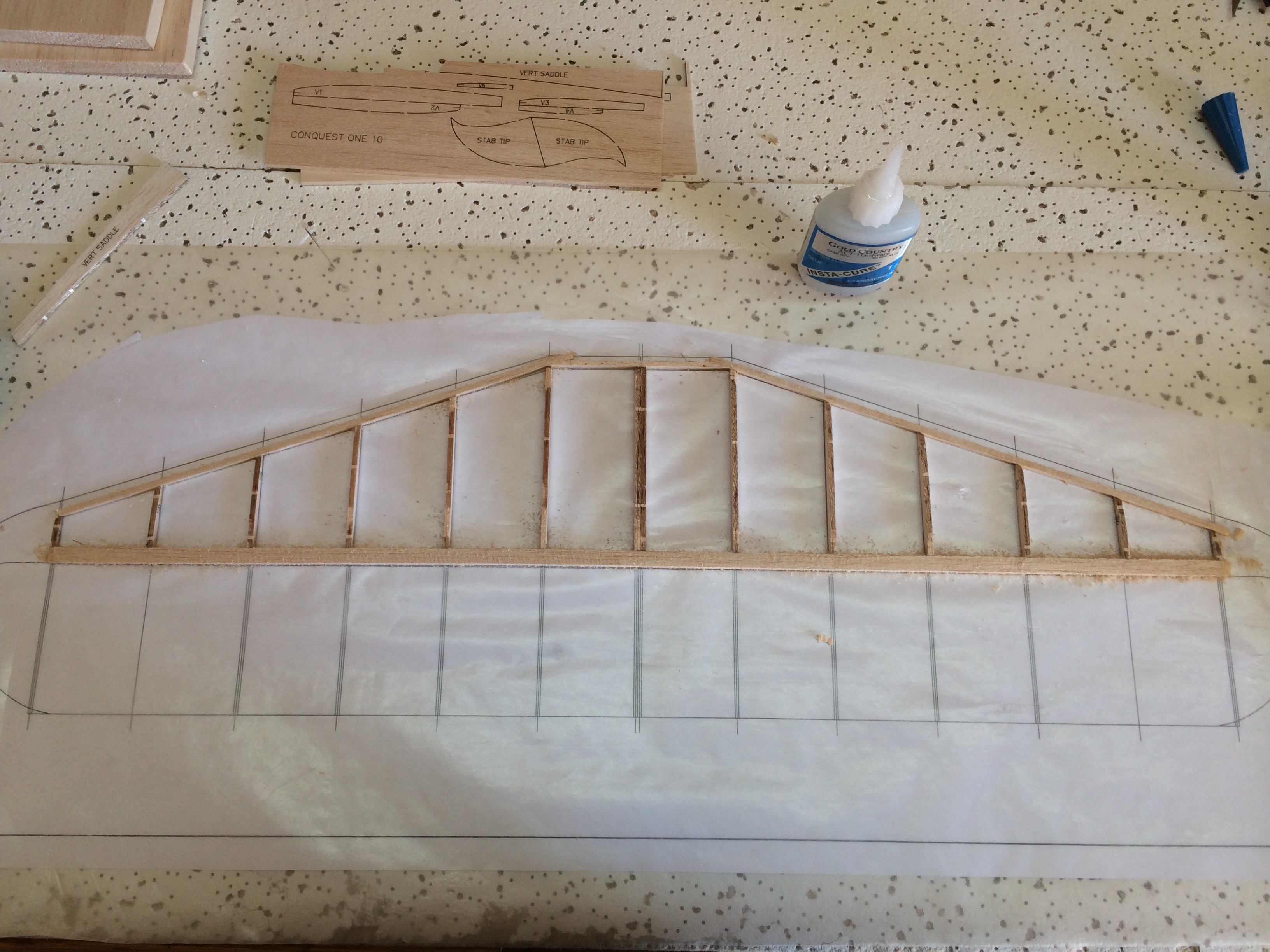

Here is the start of one of the Horizontal tail haves.

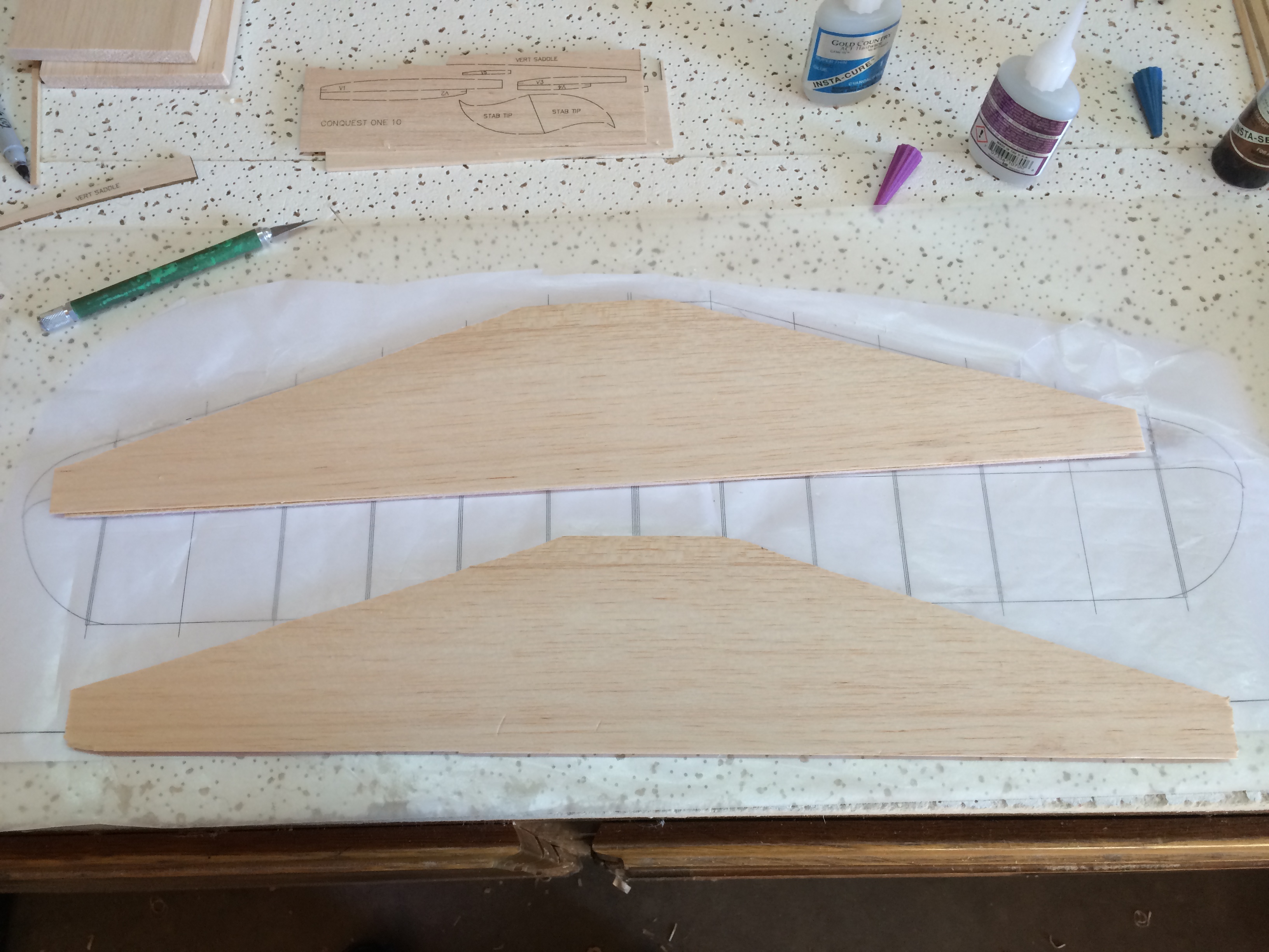

http://www.rcuniverse.com/forum/atta...mentid=2133596

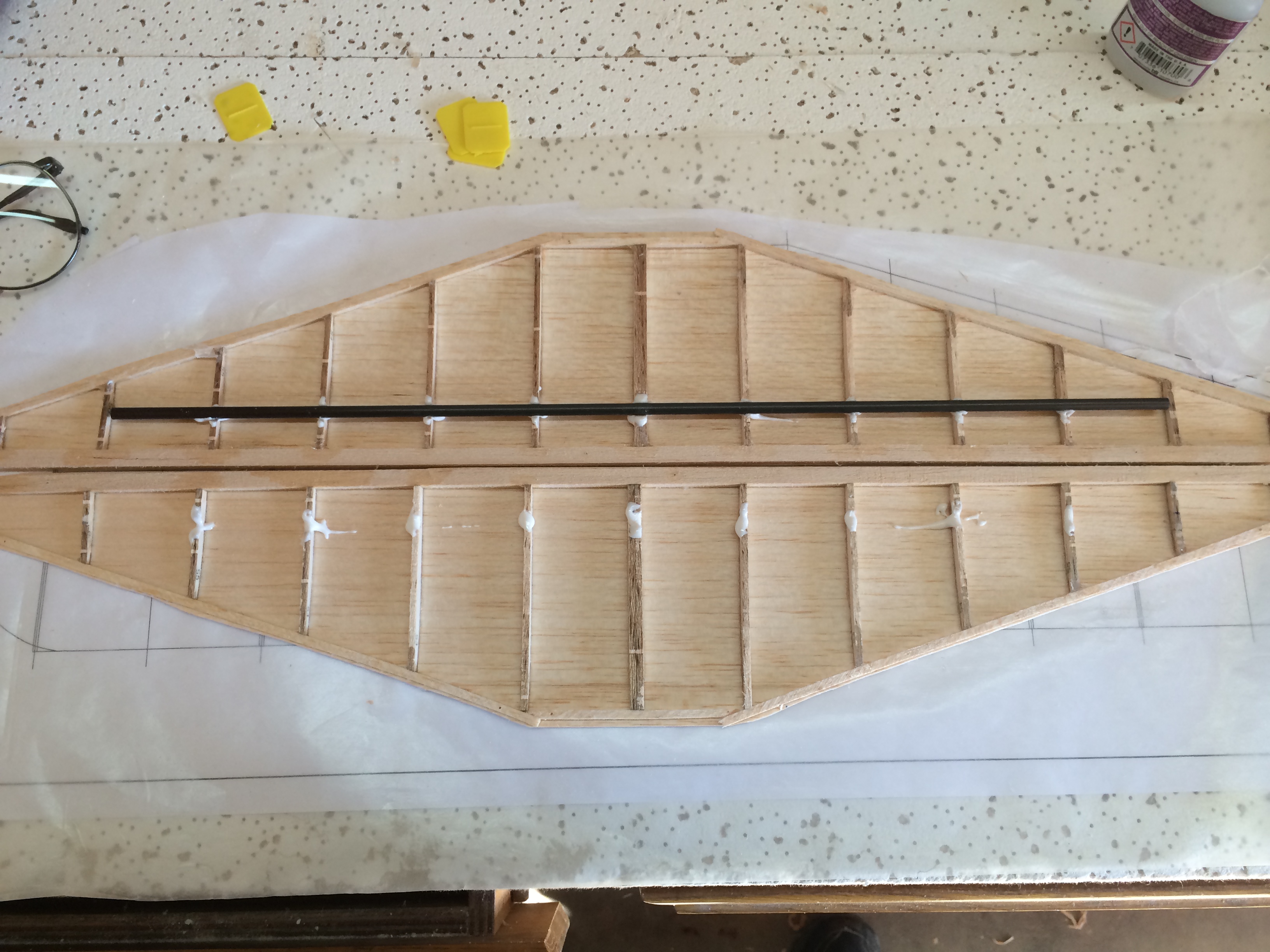

The two completed halves ready to be joined.
http://www.rcuniverse.com/forum/atta...mentid=2133597
Here is the strengthening mod that was done that wasn't shown in the Czech Mate group build. First I marked back 1" from the trailing edge to locate where I wanted to place the carbon fiber rod then using the rod with a piece of sand paper wrapped around it I sanded just a little over half the thickness of the rod on both halves and dry fitted to make sure it would clear inside when the two halves were sandwiched together.
http://www.rcuniverse.com/forum/atta...mentid=2133598
Then it was glued in using epoxy and some micro balloons before the halve were glued together.
http://www.rcuniverse.com/forum/atta...mentid=2133599
The halves are now glued together. This was how far I got while Eric was finishing his vertical stab.

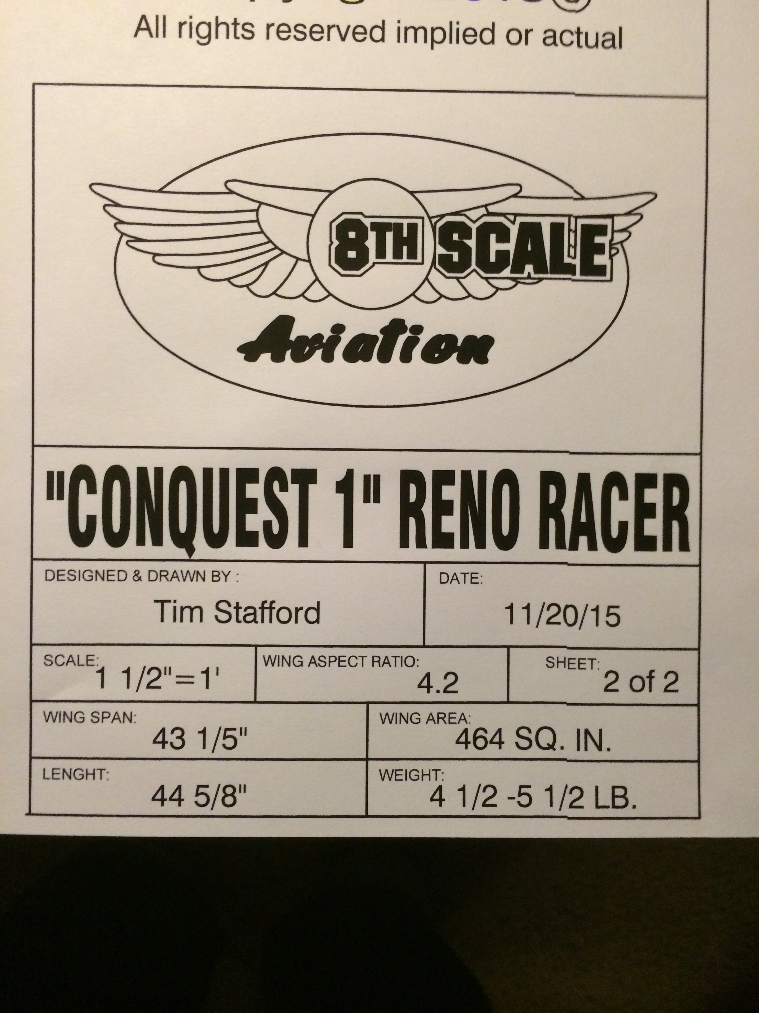

tdstaf 12-03-2015 03:59 PM
1 Attachment(s)
Originally Posted by RACE 66 (Post 12135842)
What size is the airframe? 1/12,1/8, 1/10th? Wingspan,Length, size of engine?
Mike

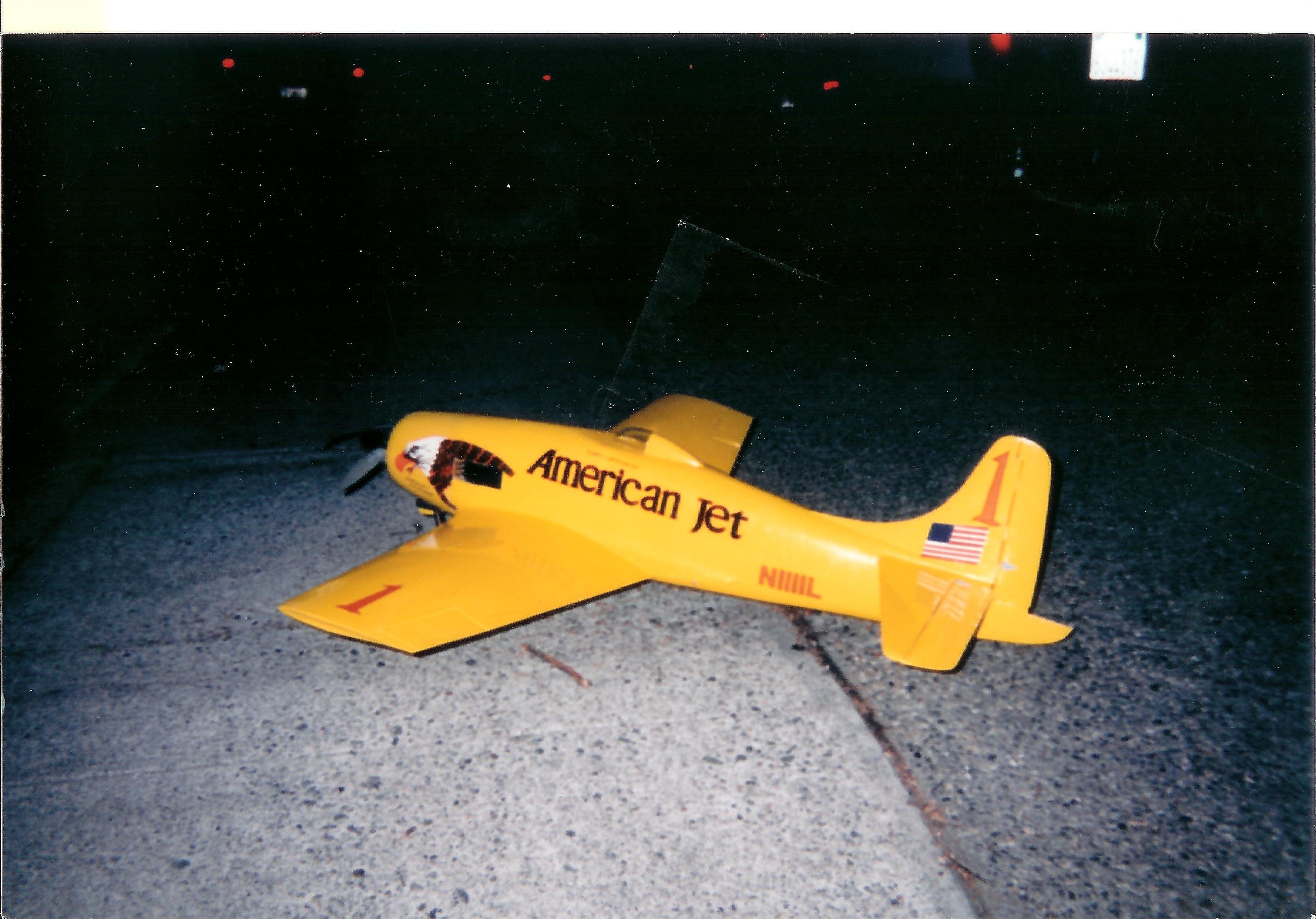

It is 1/8 scale and I plan to put a YS .91 fz in it.. I meant to post this.
http://www.rcuniverse.com/forum/atta...mentid=2133833
