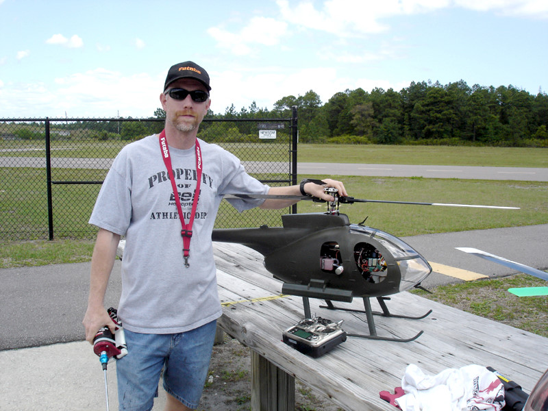

I need advice from a professional who has built and flown nito powered scale helicopters. My creditials are that I have built and flown RC helicopter ranging from 30 to 90 size airframes all of the pod and boom design. Now I want to get into scale. The model I desire to emulate is a MD500E. I have choosen to mount a fuselage of this design on the mechanics of an Align 600N LE. I have encounted very little information on this airframe but what I have read is that vibration is a serious issue that seems to manifest once a scale body is is attached to an existing airframe. Before I take the pluge into this realm of RC helicopters what are the things I must be aware of and how to negate the possibility of failure.

Biggest thing is to make the mechanics as perfect as you can BEFORE you fit the fuselage. Make sure everything is as smooth as you can make it.
You dont want to have any mechanical tinkering left to do when you install the body.

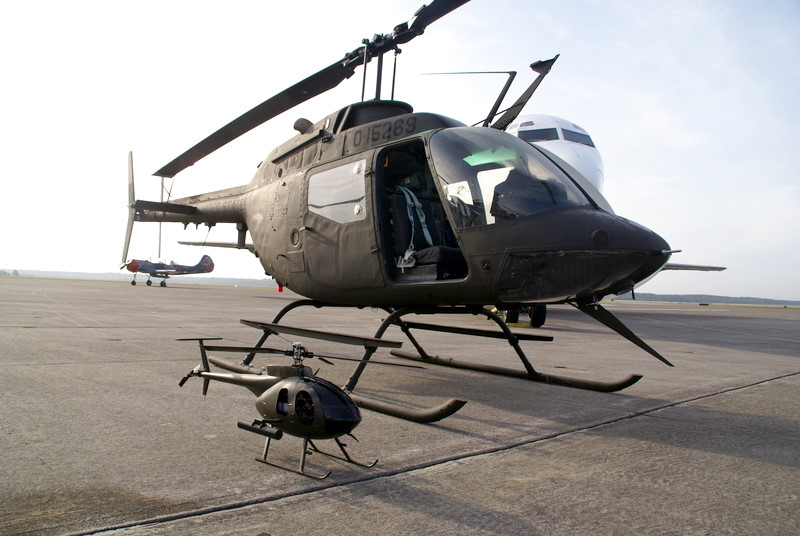

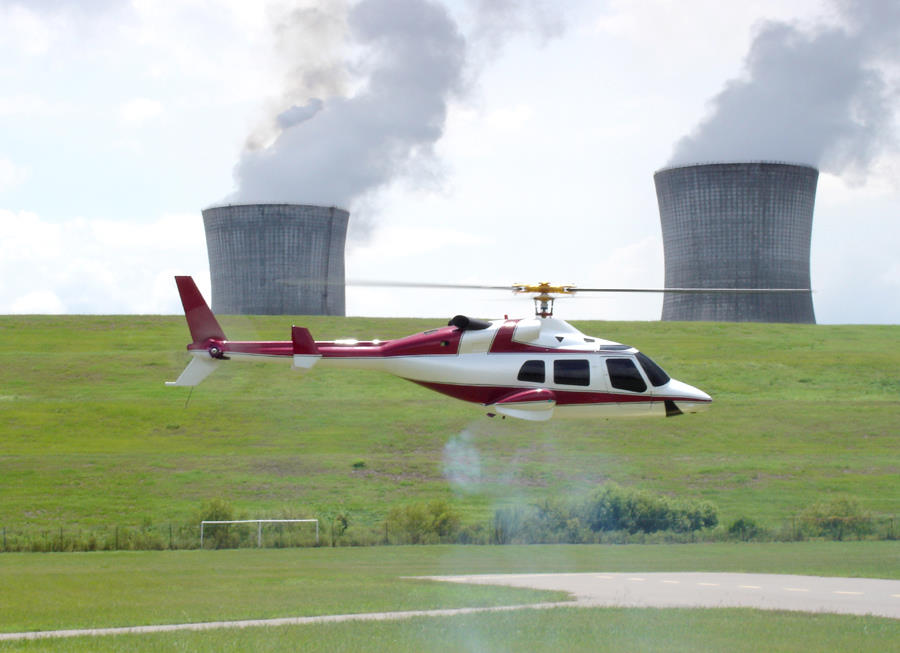

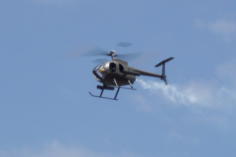

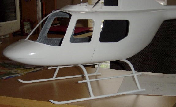

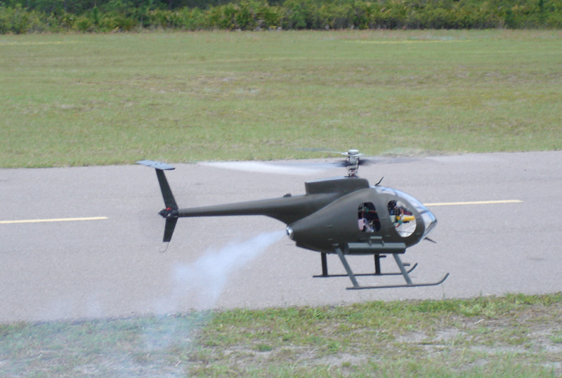

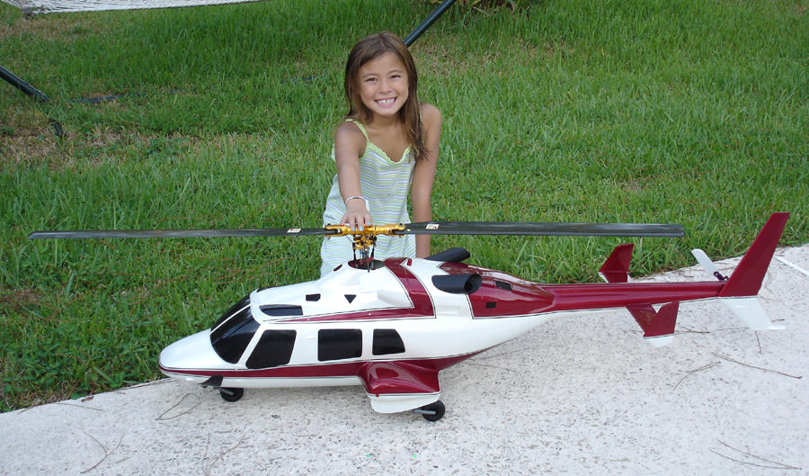

I guess what I'm saying is that helicopters aren't any more failure prone with a fuselage on them than not, they just cost more to fix when they fail.
You're obvoiusly competent with setup and your FAI setup experience will serve you well as must FAI guys I know are very precise and meticulous. Heavy paddles, soft dampeners, and conservative cyclic throws make for a smooth flying, scale looking flight regime.
Building the Trex on glass and making sure the main shaft drops through the bearings when everything is tight, dial indicating the fan/clutch to minimize vibrations, in short, things you very likely already do.
You're obvously concerned about harmonics. Pay attention to the mounting directions and make sure the fuselage is properly braced, make sure the blades arent too tight in the grips so they can find center promptly when powering up and get ready to power swiftly through the spool up resonance that most any machine has.

Some things will drive you crazy though. It takes 20 seconds to pull the canopy and replace a worn glow plug on a Trex. It will take 20 minutes to pull the front windscreen and change the plug on a Trex600 covered by a scale fuselage. I just find it worth the extra tinkering.
