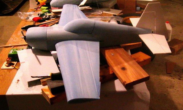

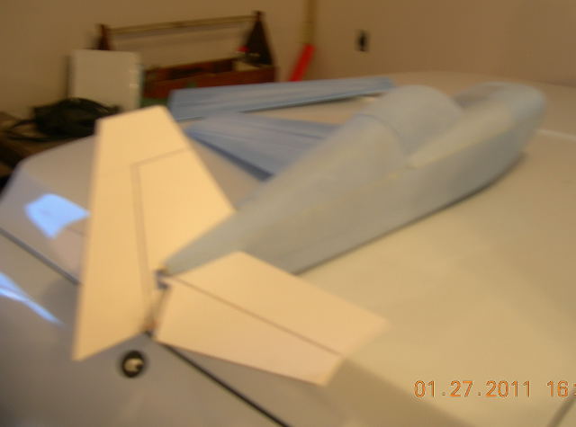

Pics. Hopefully they show up.

Yeah, they showed up, looks really good!!!
I'll be keeping my eye on this build.

Thanks! The main things I'm worried about are the servos and attaching the landing gear. I dont have a paved runway, though I am blessed with a huge yard so I dont have to go anywhere to fly my planes. Anyway, the landing gear on my other planes tend to get bent (even ripped right out o.0) even when I land pretty gently, imo. I dont want the same happening to this one. The servos, the hs55's, are they too small? I want to save on the weight... Oh yeah, btw, I've yet to cut out the ailerons on the wings.<div></div><div>thoughts?</div>

i would like to see the detail build process pictures. what lipo battery are you using for this model?

As with any hot aerobatic flying model the lighter the better. A good target weight for a 42 inch model would be in the high 20's to low 30's oz range. A lot depends on the wing area. For a model in this size range that you want to fly like an Extra should fly you'll want to keep the wing loading down to 10'ish or less oz/square foot. Find the wing area in sq inches, divide by 144 to find sq feet then multiply that by 10 to find what your target weight should be. Try to keep it under that much.
A 2S pack on a Kv=950 motor may require too large a prop to pull the required amps to achieve the optimum watts of power to the prop. You may well find that you want to switch to a 3S pack to allow you to use a better size of prop in the 9 to 11 inch diameter range.
It's not the size of the battery pack that determines the rating of the ESC. It's the amount of power the motor will draw. Also you want to over rate the ESC so it isn't operating too close to it's limit. If your motor can be proped for 20 amps it's a good idea to buy at least a 28amp or higher capacity ESC for this reason. It's also a good idea to place it in the cowl or at least in an open area of the fuselage instead of wrapping it in packing which would insulate it and prevent proper heat dissapation. They DO get warm.
For smaller models I think you're going to find that you need to go with a smaller pack to keep the weight under control. In keeping with the 3S pack suggestion above I'd suggest something more like a 3S1200mah option or similar. With throttle control that would still give you lots of flying time per flight. Also keep in mind that if the model comes in at 32'ish oz that's 2 lbs. And with the requirement to use around 150 watts per lb or even morewith such models that means the motor needs to put out 300 watts of power. At the 11.2 volts from a 3S pack that is 300/11.2 = 27 amps target current for the motor. To keep it from operating too close to it's limit I'd want that motor to have a rating of 30 amps continuous.
HS55's will be a bit on the small side for this model unless you keep the flying speed down. HS65's or something similar would be a bit more of a proper matchup.
Foam is not my material of choice but you've done a superb looking job on this model with it.. I hope when you start checking the weight that it's coming in on target for you. It would be a shame to see all that work result in anything but a great flying model.
