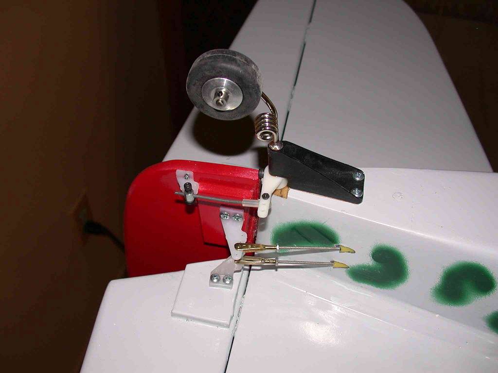

I'm scratch building a low wing taildragger, stick & balsa, weight around 6 1/2 to 7 lbs or 3000 grams. should I simply attach a tailwheel wire to the rudder or give it it's own control linkage and mount?

Ed, here's what I do. The plane weighs 20 pounds and is 50cc size. Dan.

Dan, thanks a lot. That looks simple, strong and easy. I think I'll try it. Maybe a little extra wood on that part of the rudder?

Ed, thanks for the thanks. The bottom of the rudder is a strip of 3/8 inch ply for the small bell crank mount. Here's an image of the whole plane. Dan.
