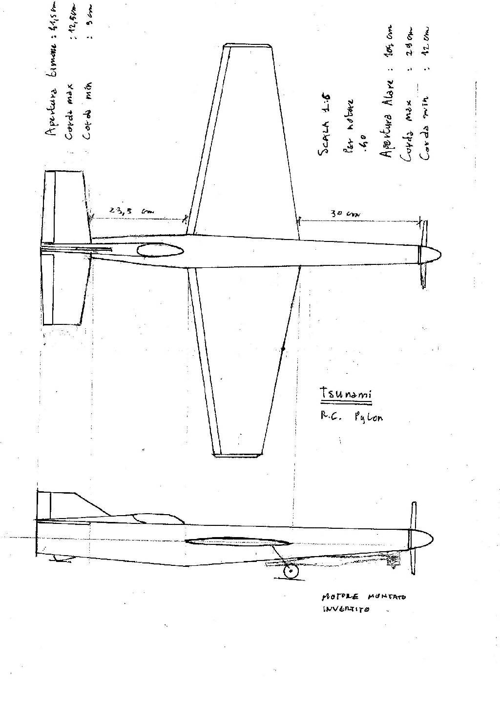

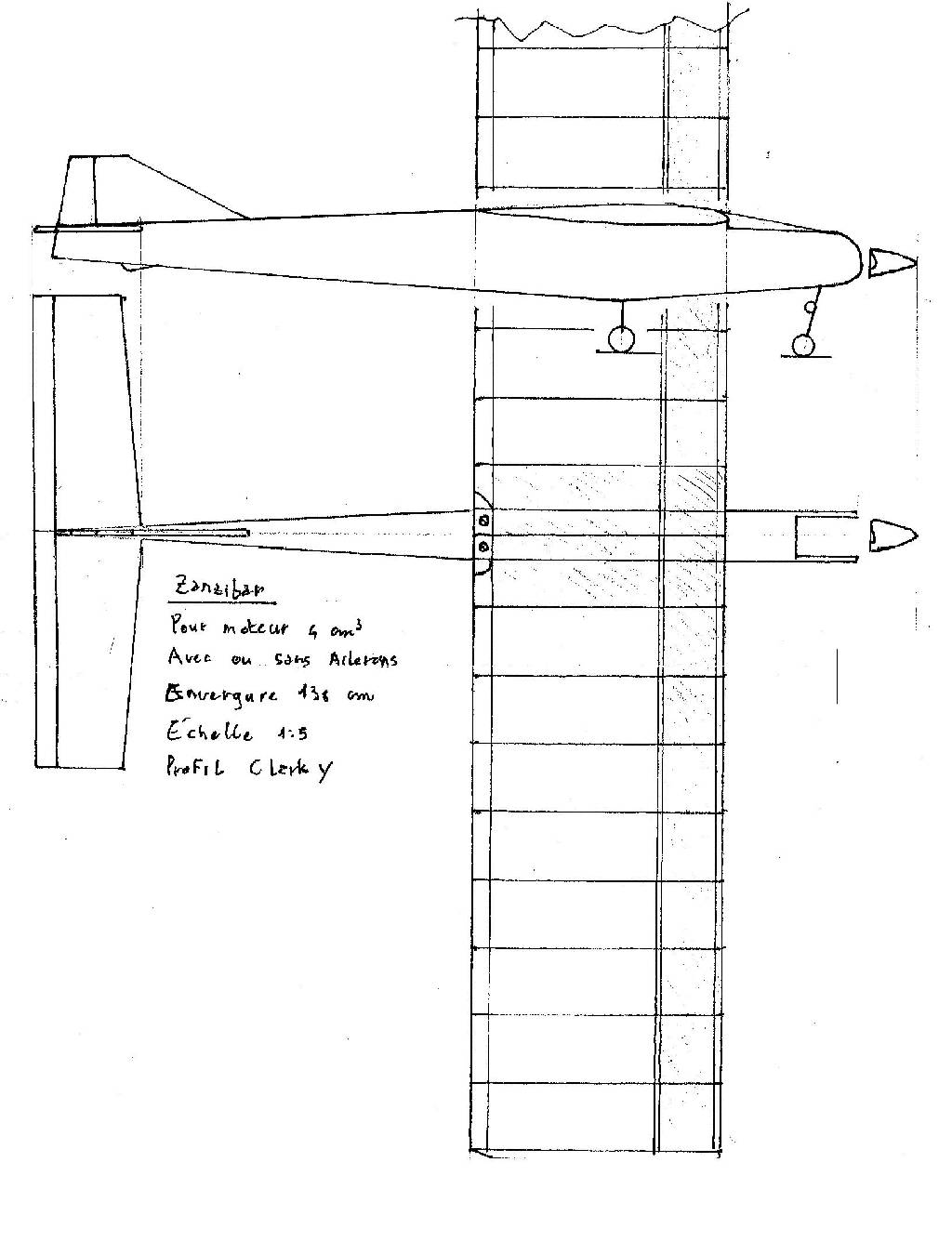

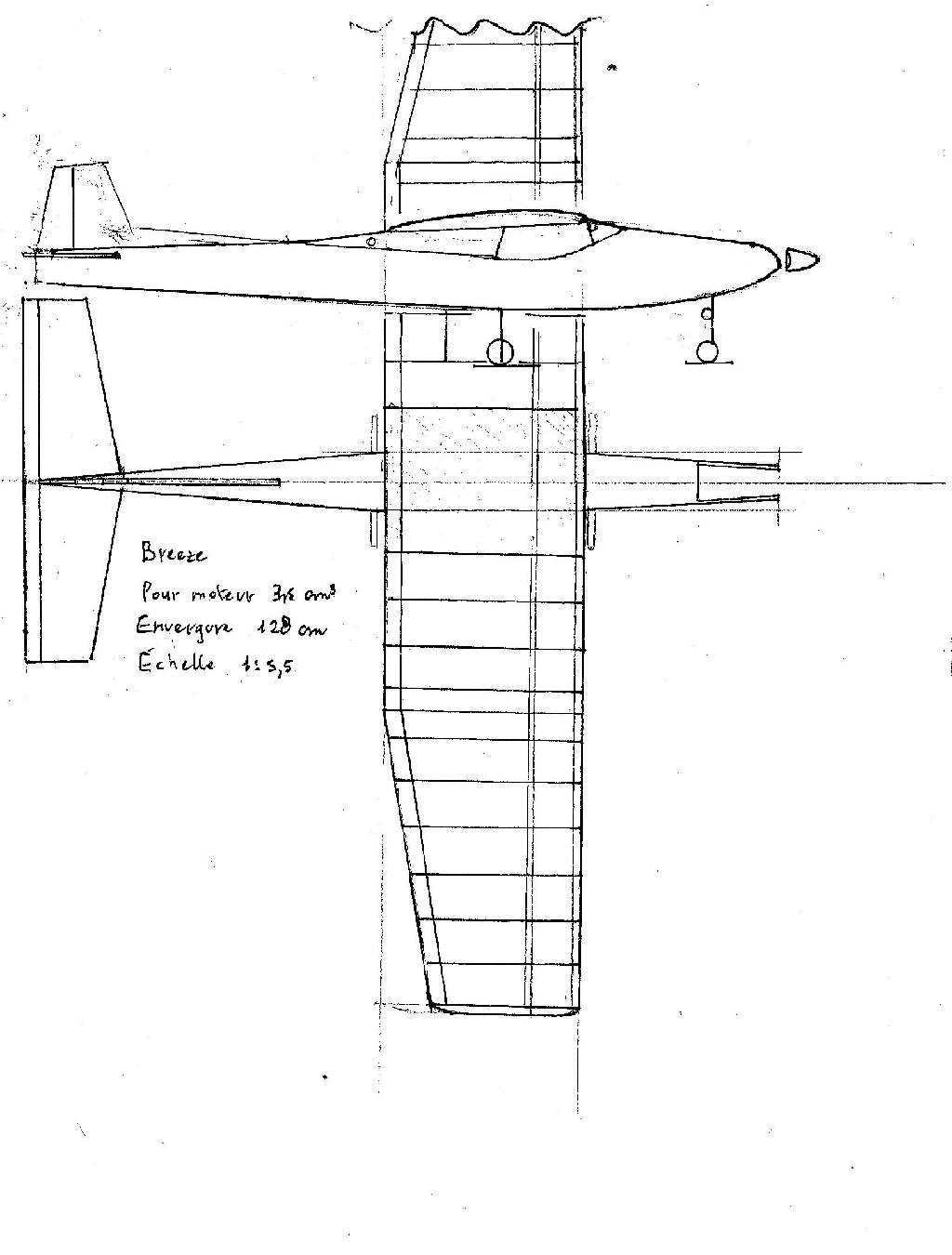

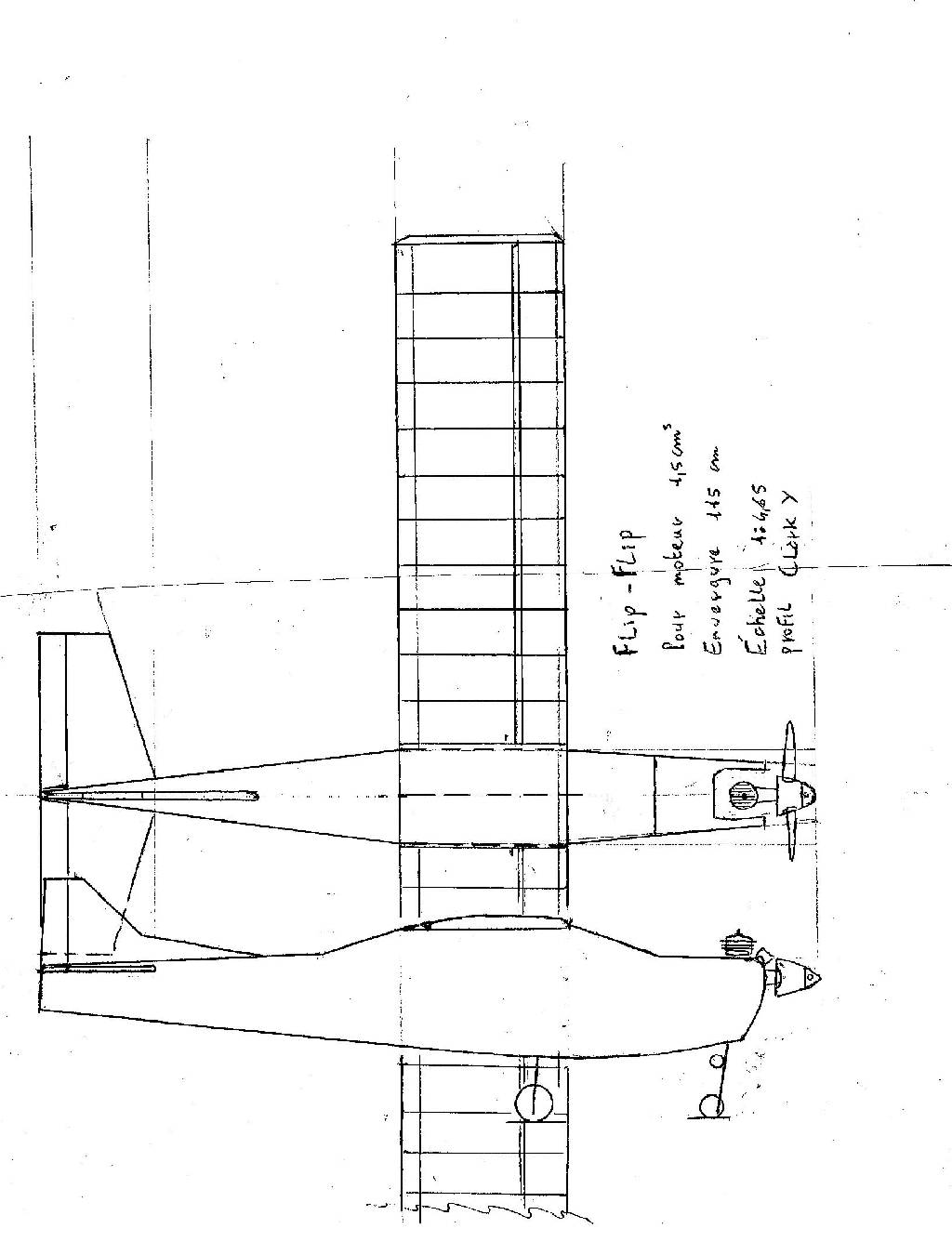

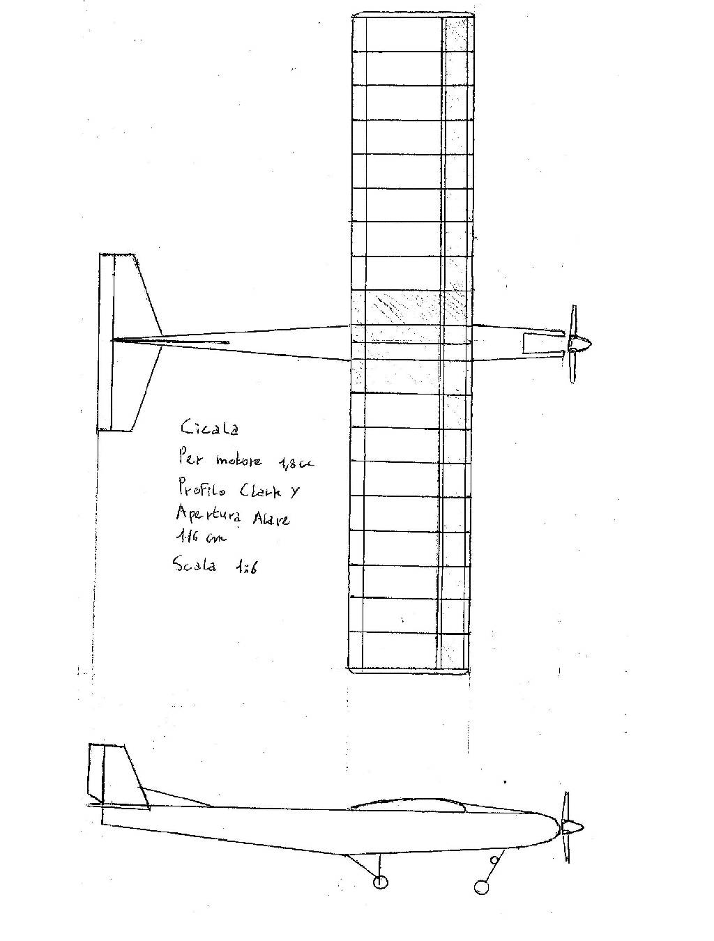

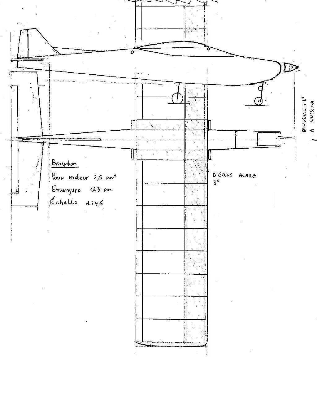

Just choose your favorite airfoil, draw the particulars you need at full size and then start to build them.
