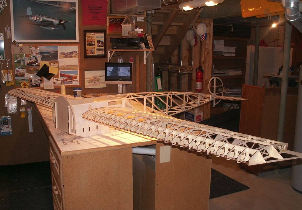

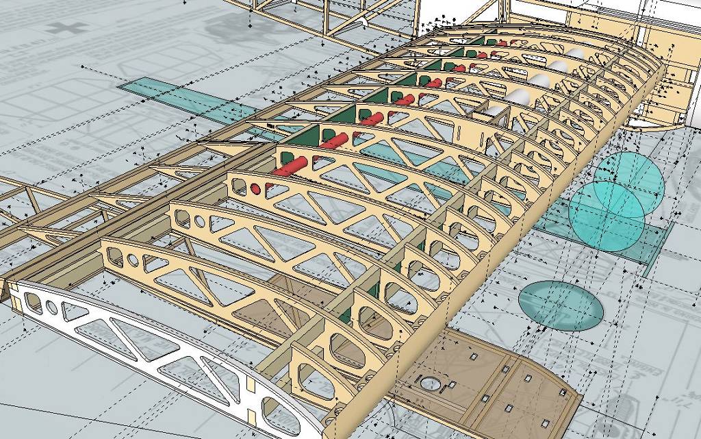

Don't give up on SketchUp.
A fully capable program.
I am an architect and use it for my architectural practice every day
and I also use it for aircraft designs that I kit.
The Eindecker EIII is at 1/3 scale and the Nieuport 11 is at half scale.
Larry

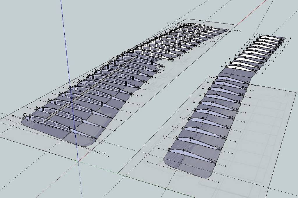

Posts: 101
From: Pickerington, OH,
Bob,

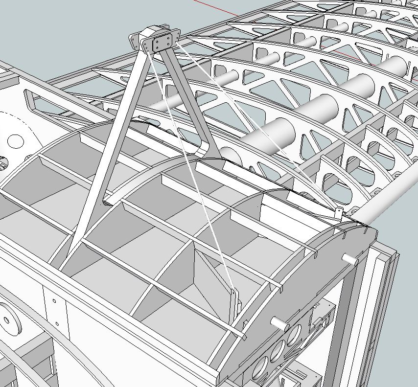

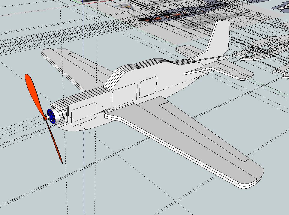

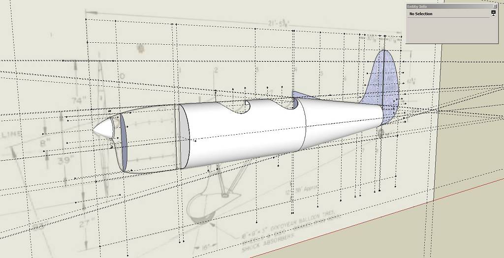

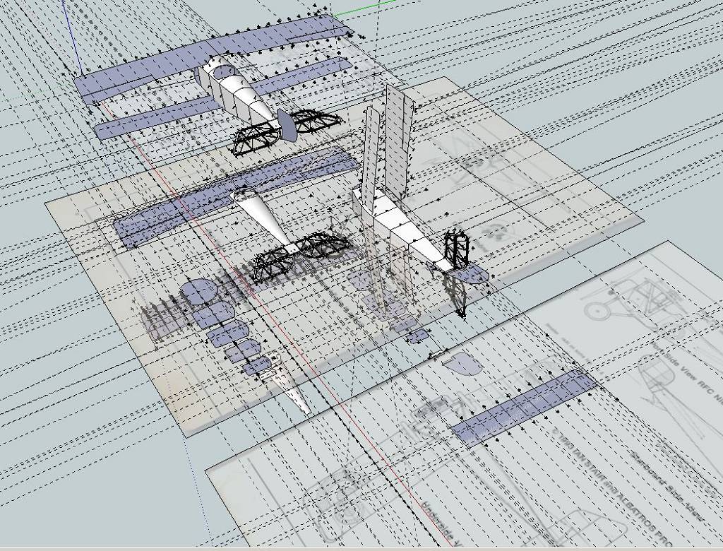

Everything for the Eindecker has been drawn in SketchUp. I do use the pro version for my architecture practice but I could do the same thing with the free version.
There are a great number of plugins that allow you to draw nearly anything with SketchUp and most are free.
I also belong to the SketchUcation forum and you could learn how to use SketchUp from reading this forum alone but there are video tutorials covering just about everything available.
I use plugins for splines, lofting and I export faces of the parts to Corel for cutting on my laser. The laser uses Corel as it's print driver.
I am sure that there is some format that your files could be saved in that SketchUp could import with a plugin.
Here are some other sample SketchUp projects.
The Nieuport 11 is at half scale and the Ryan STA is at 40%. The Ryan is from factory drawings.
Larry

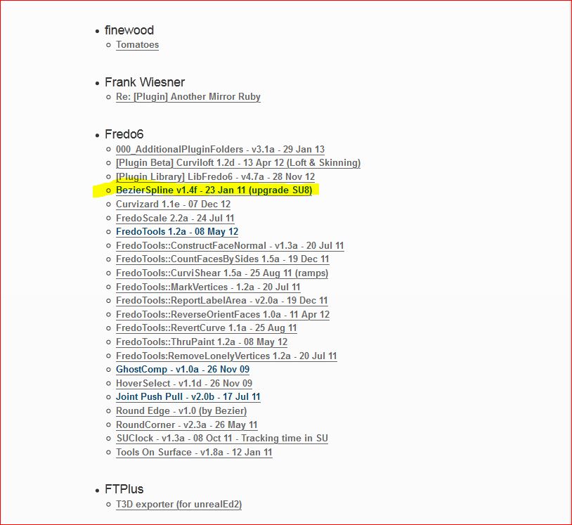

Posts: 101
Bob,
Go to the SketchUcation forum and under the resources tab click on plugins.
Scroll down to Fredo6 and click on the Bezier Spline plugin.
This will take you to thread about this and tell you everything you need to know about it.
This is the greatest collection of plugins for SketchUp.

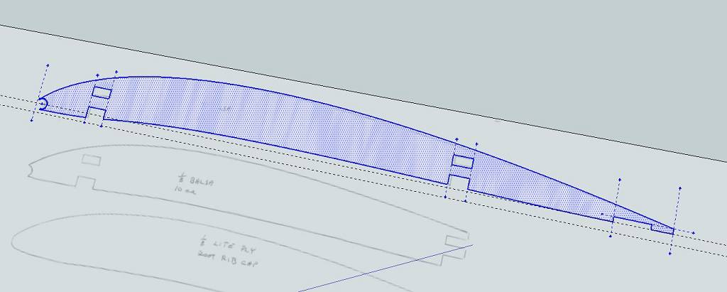

This is what I used to trace the outline of this hand drawn rib drawing.
Larry
Larry
