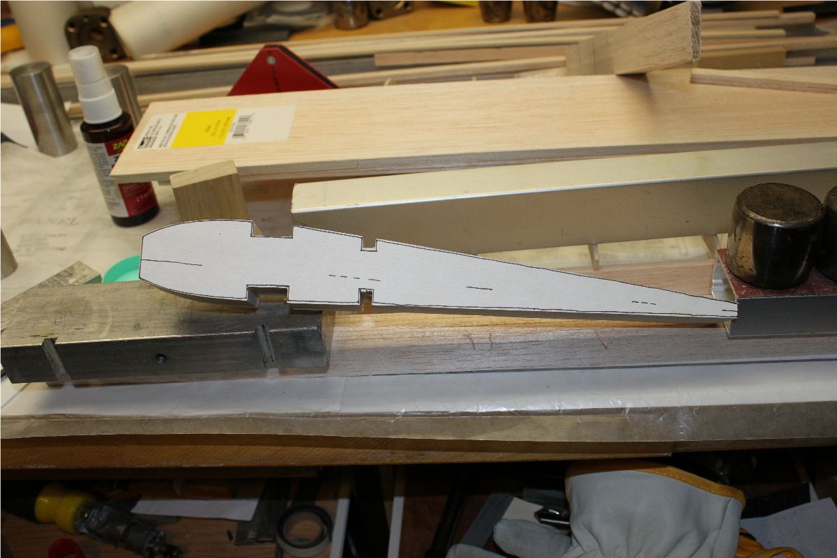

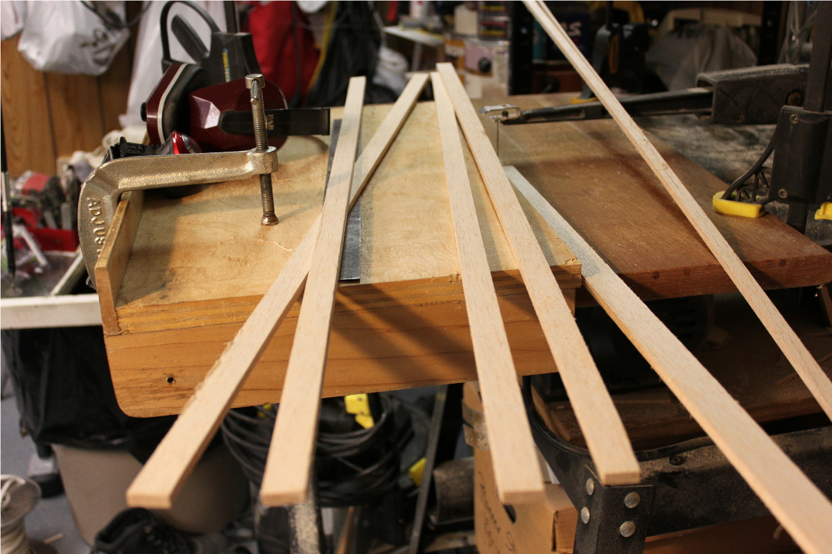

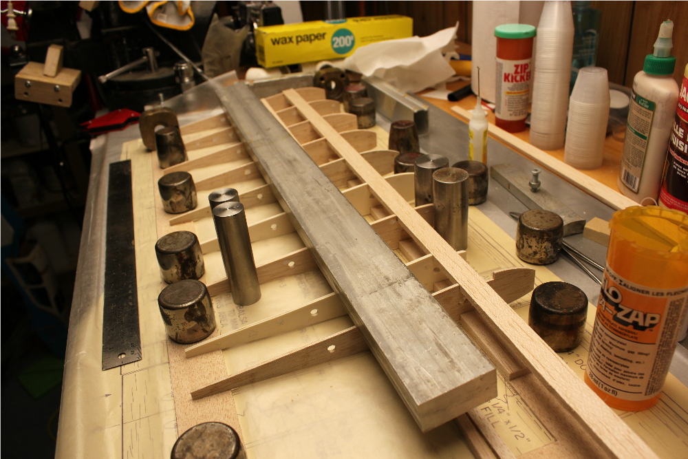

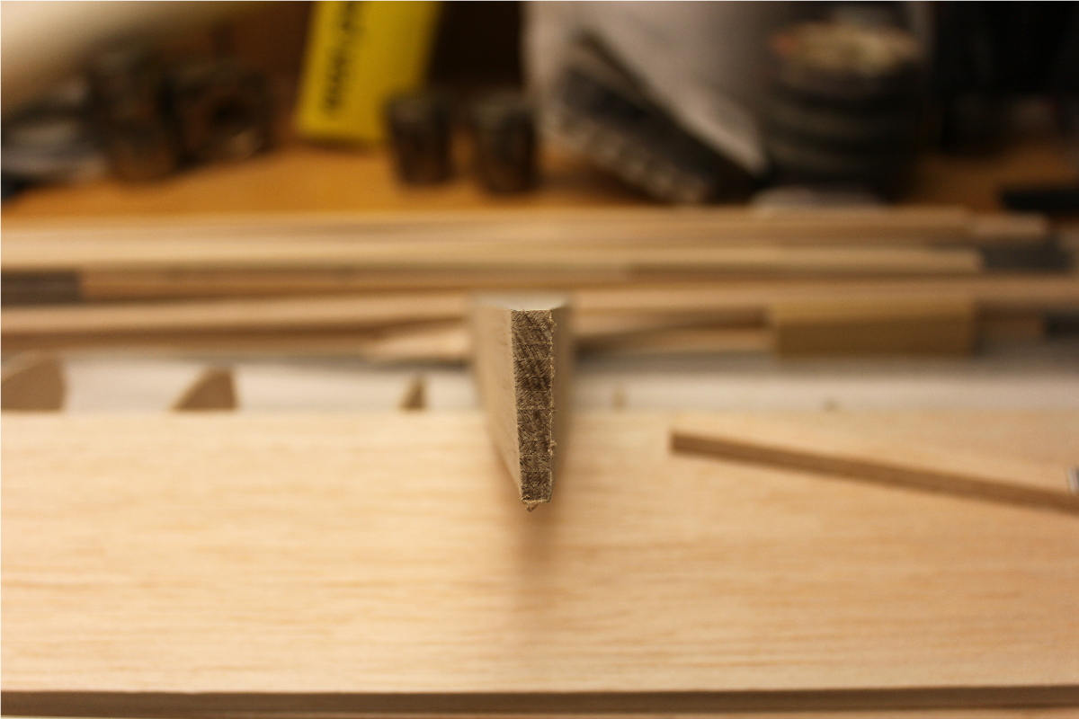

Getting Started,
I cut a stack of the outer ribs, and thought I could hold them freehand at 90 degrees to the belt sander Doh! Second attempt is going better, should have them sanded to final shape this weekend. I cut the front spars(3/4 x 1/4") using my scroll saw, they turned out good after a few false starts(more clamps are better!).
Calvi

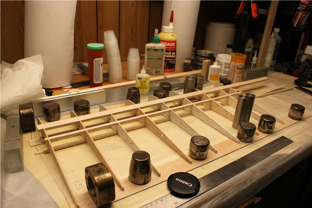

Left wing is laid out, just gotta get some more 1/16 balsa and cut a trailing edge.

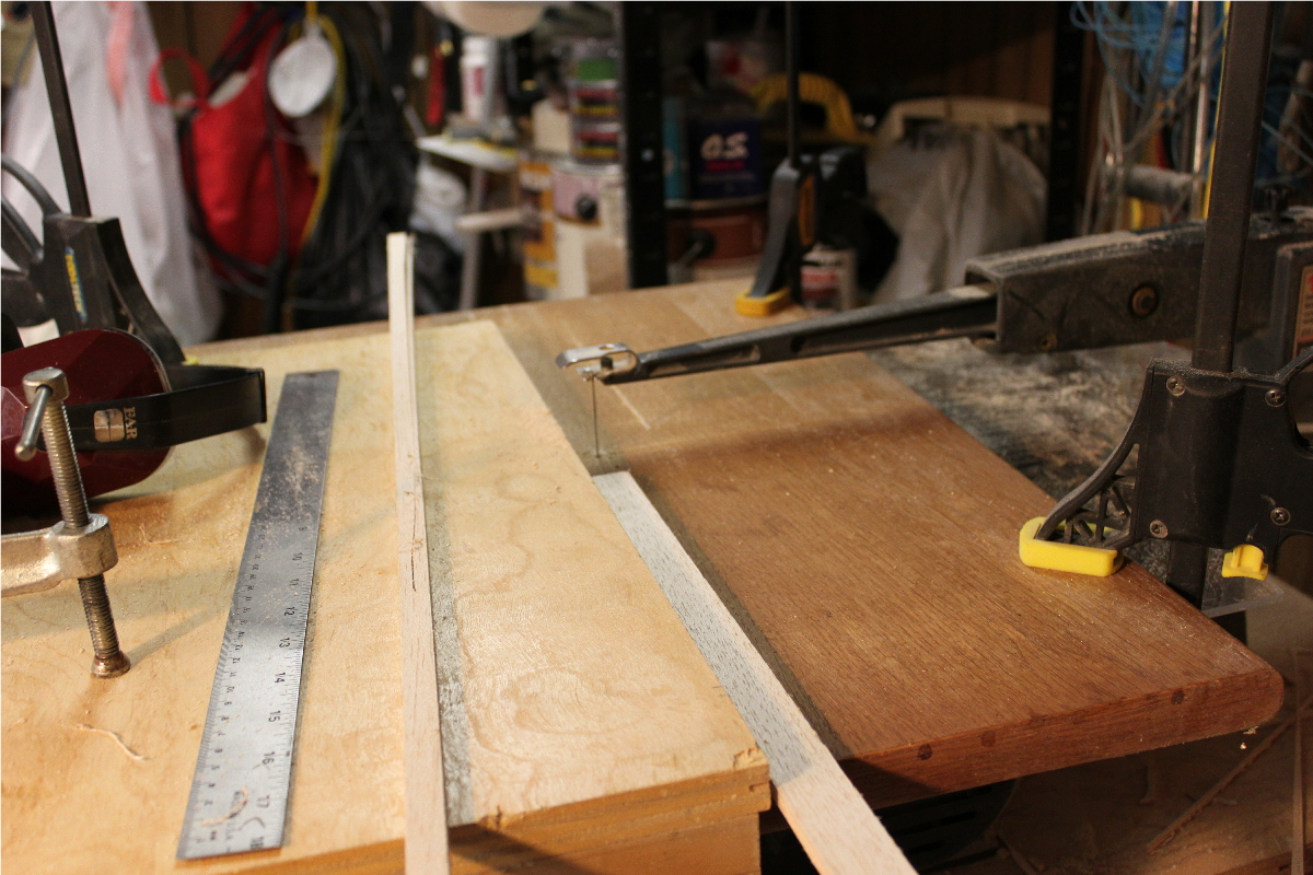

Got a little more work done, I had to make up my own landing gear blocks as the LHS did not have any. I had some 2" x 1/4" poplar that used to be available at our local Rhona hardware store, they claim that the supplier stopped sending them stock when I asked why they did not have any anymore. Too bad that is the last of it. Anyway here are a few pics.

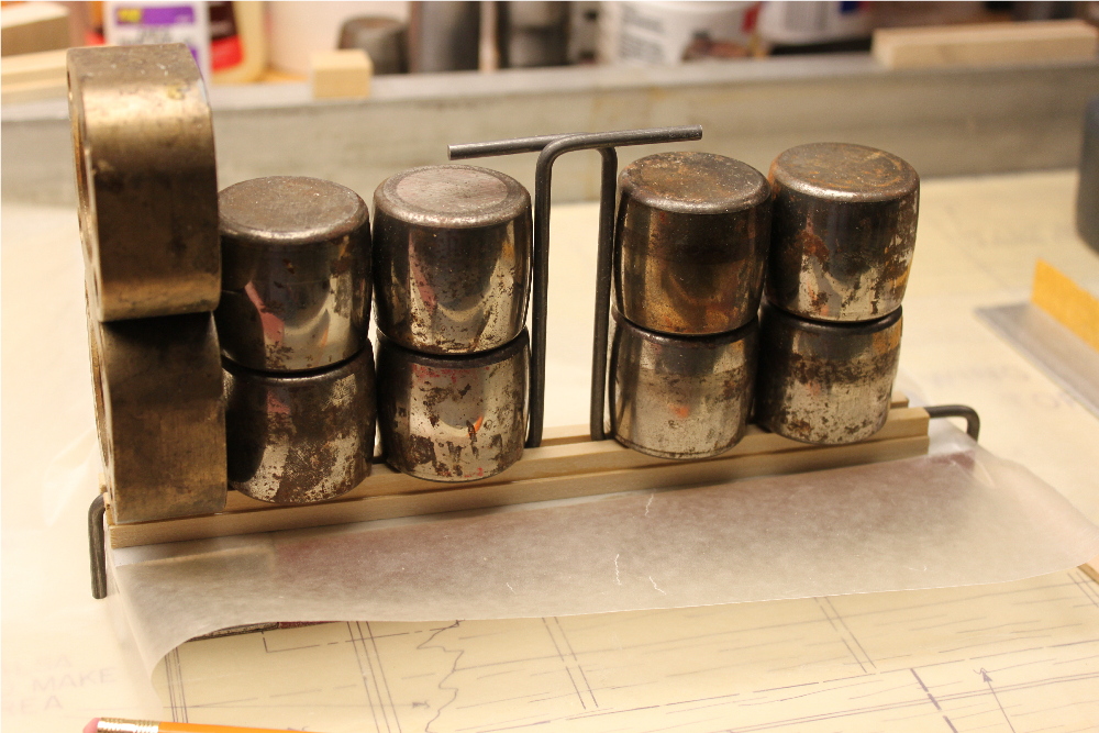

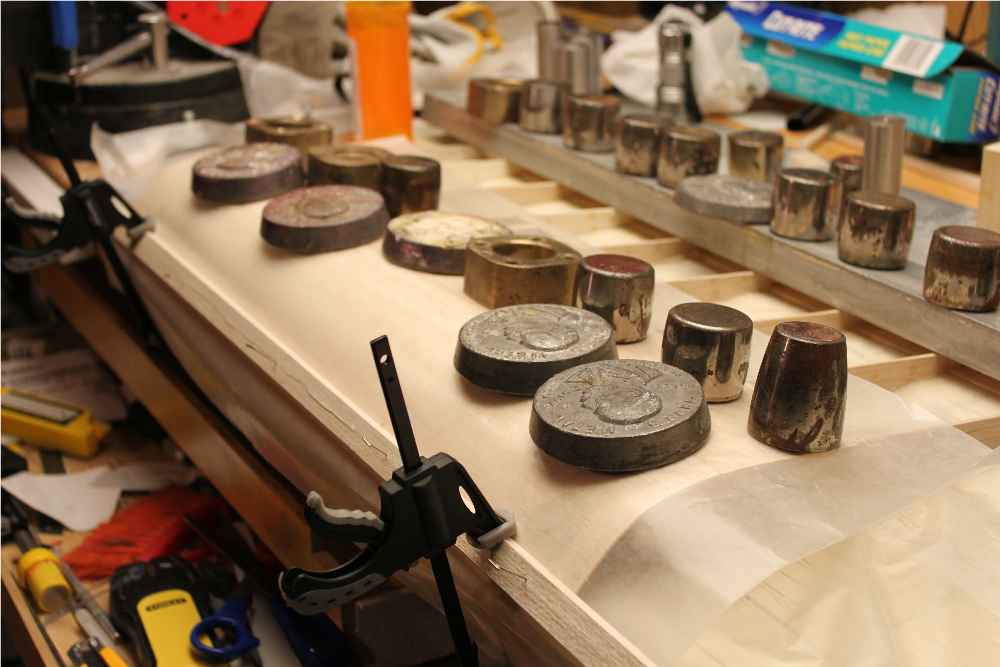

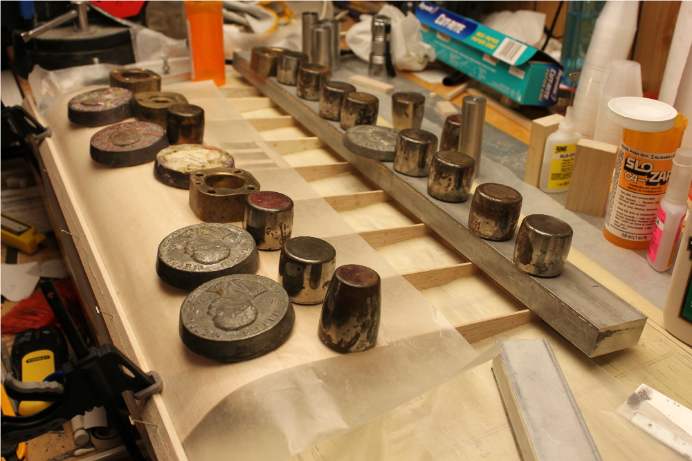

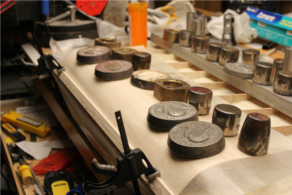

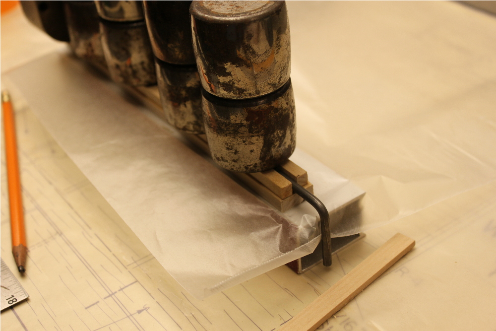

Ok, all shear webbing in and landing gear blocks in place, I can put some sheeting on the wing panels. This is fairly easy with the short(24") constant cord panels.

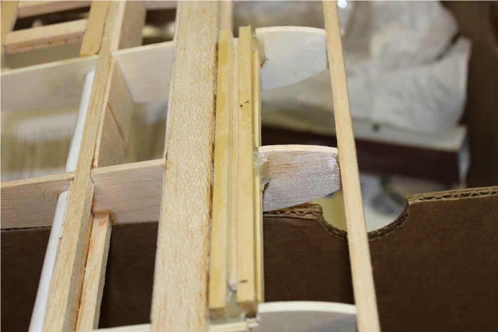

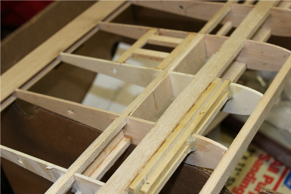

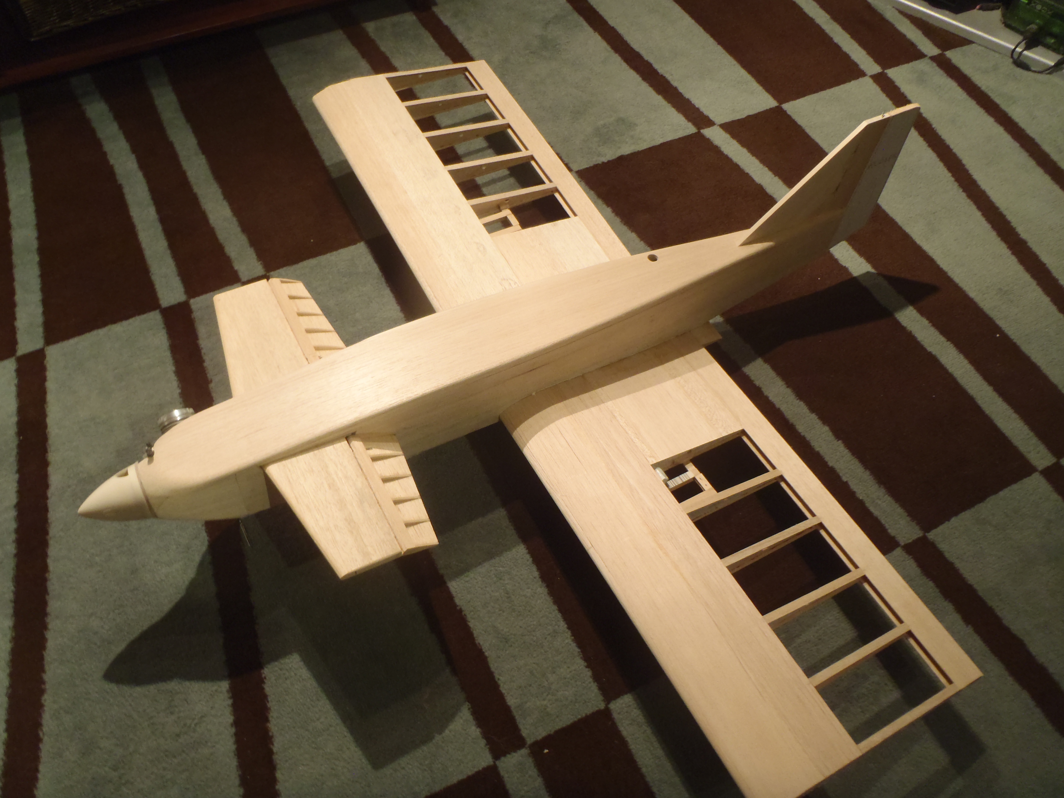

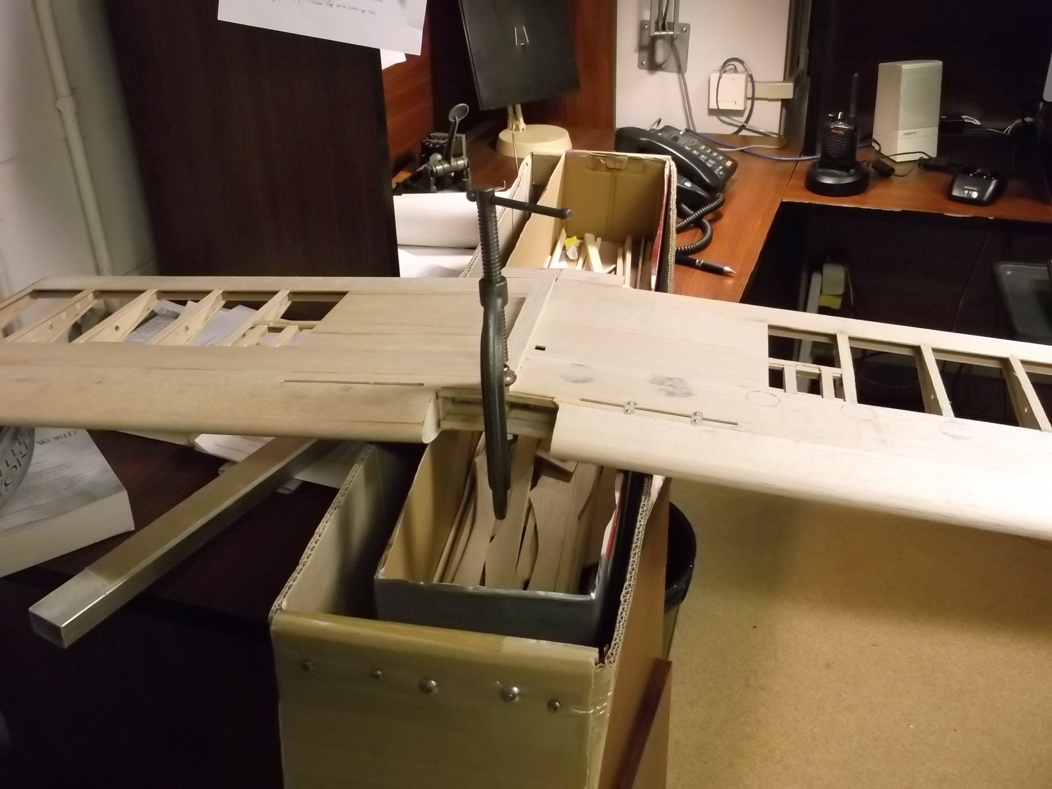

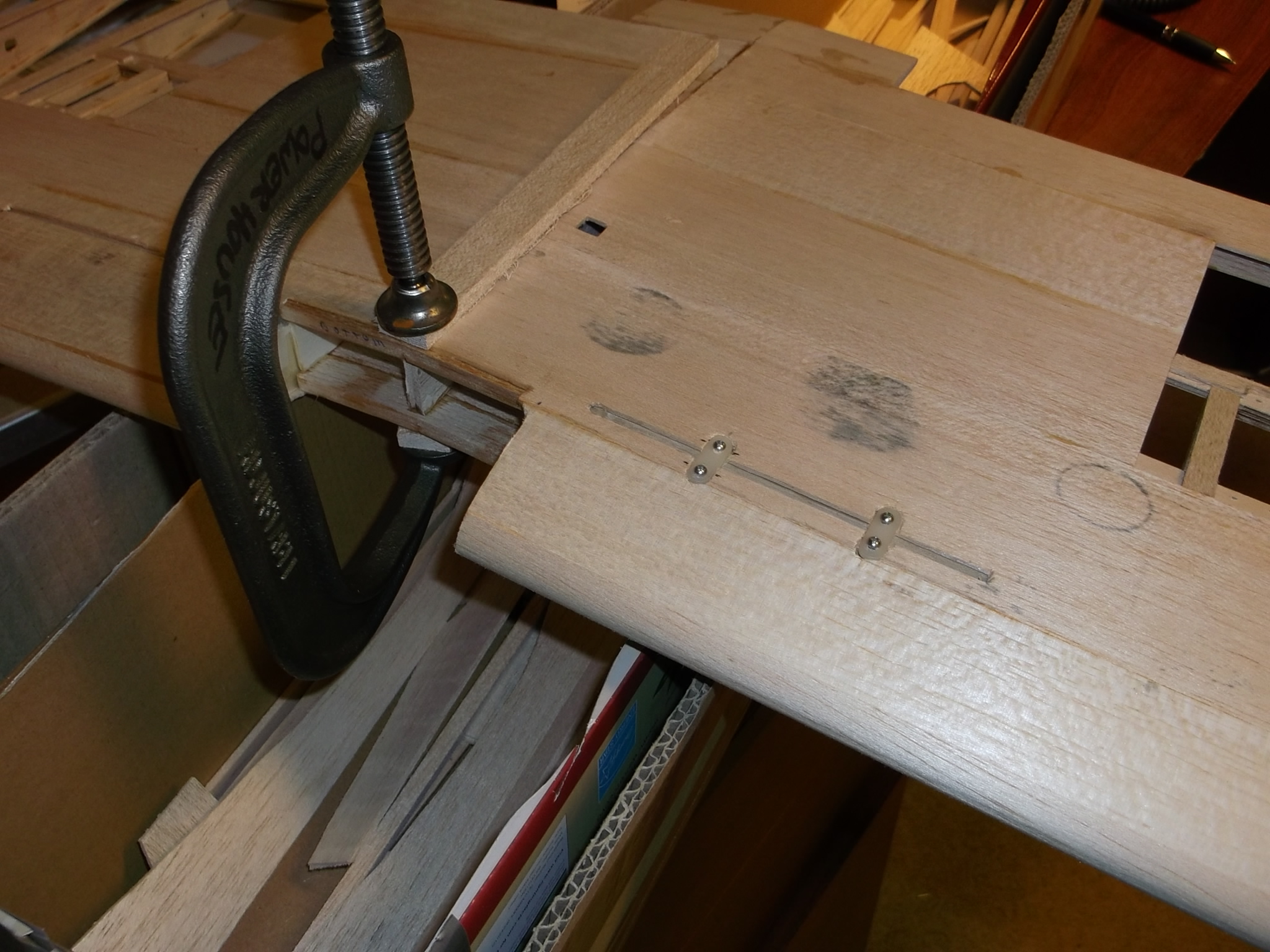

Well, I got the wing joined, center section cut out and 1/4 x 1/2 filler epoxied and clamped in place. next is the front dihedral brace.
Calvi

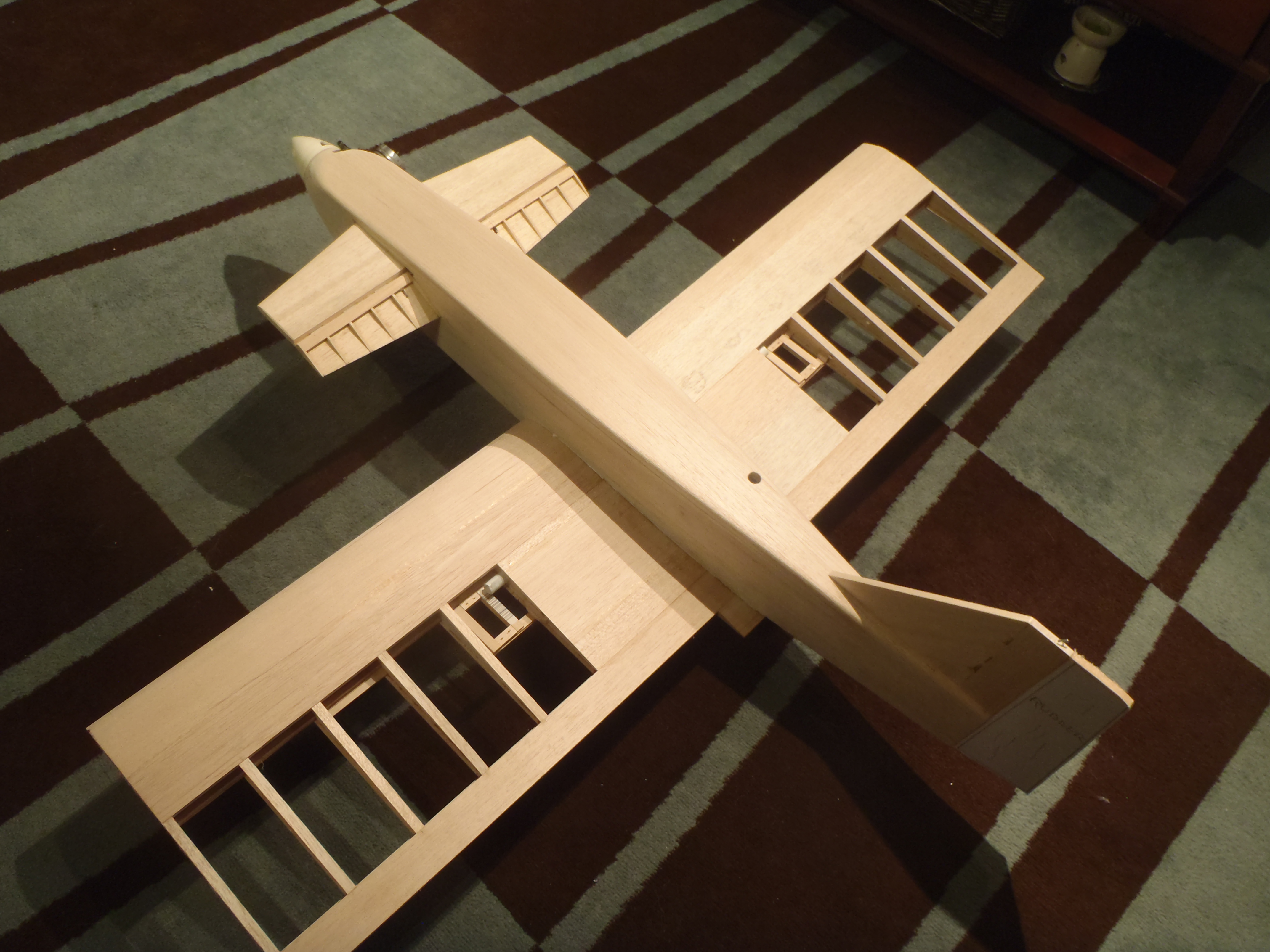

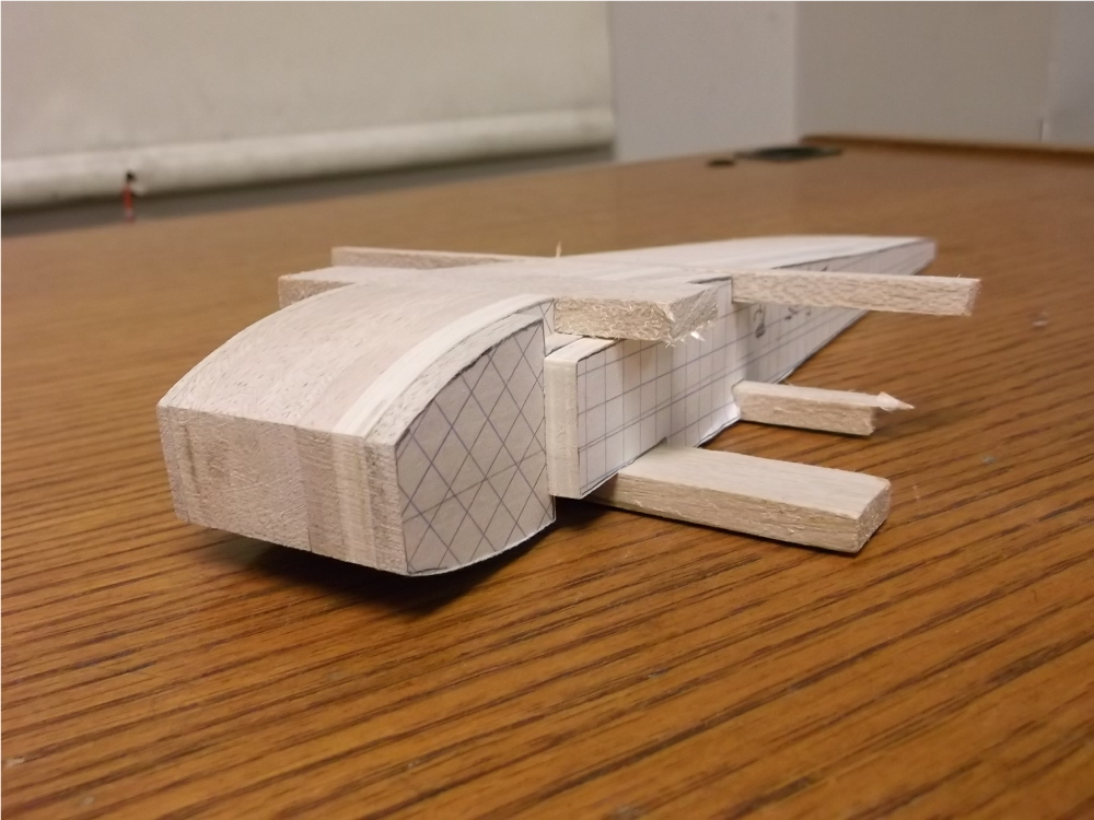

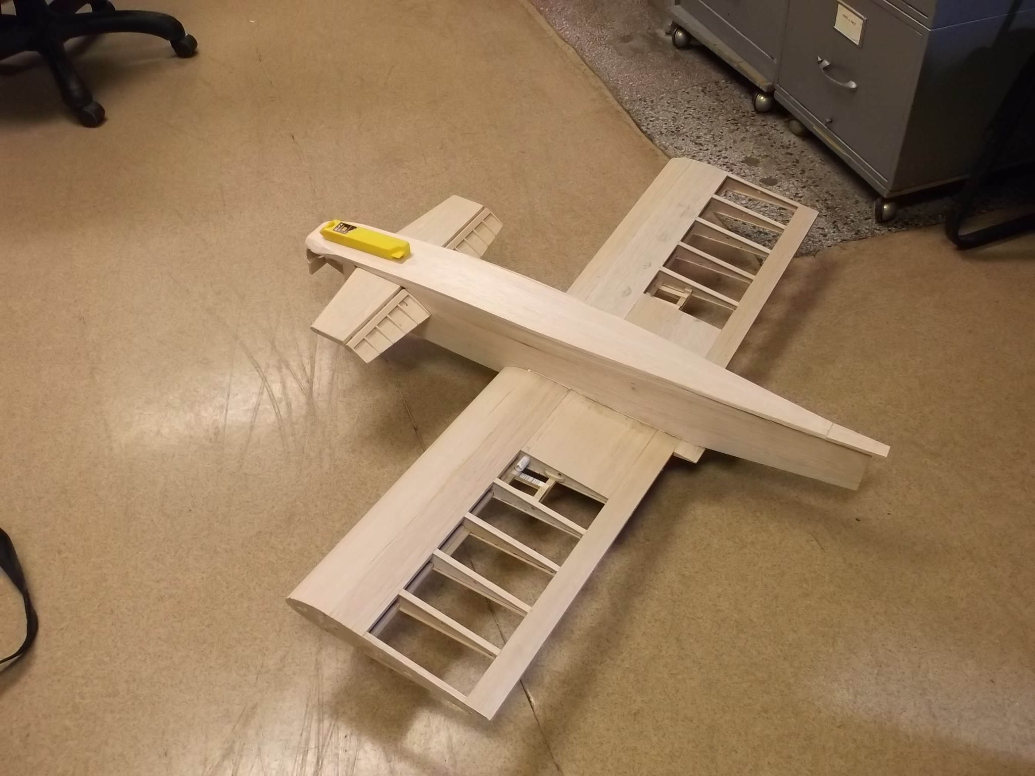

Well I have made a little progress. I am building two planes at once, an Ultra Sport 40 and the CAT. The canard is a cut down stab from a 40 size corsair.

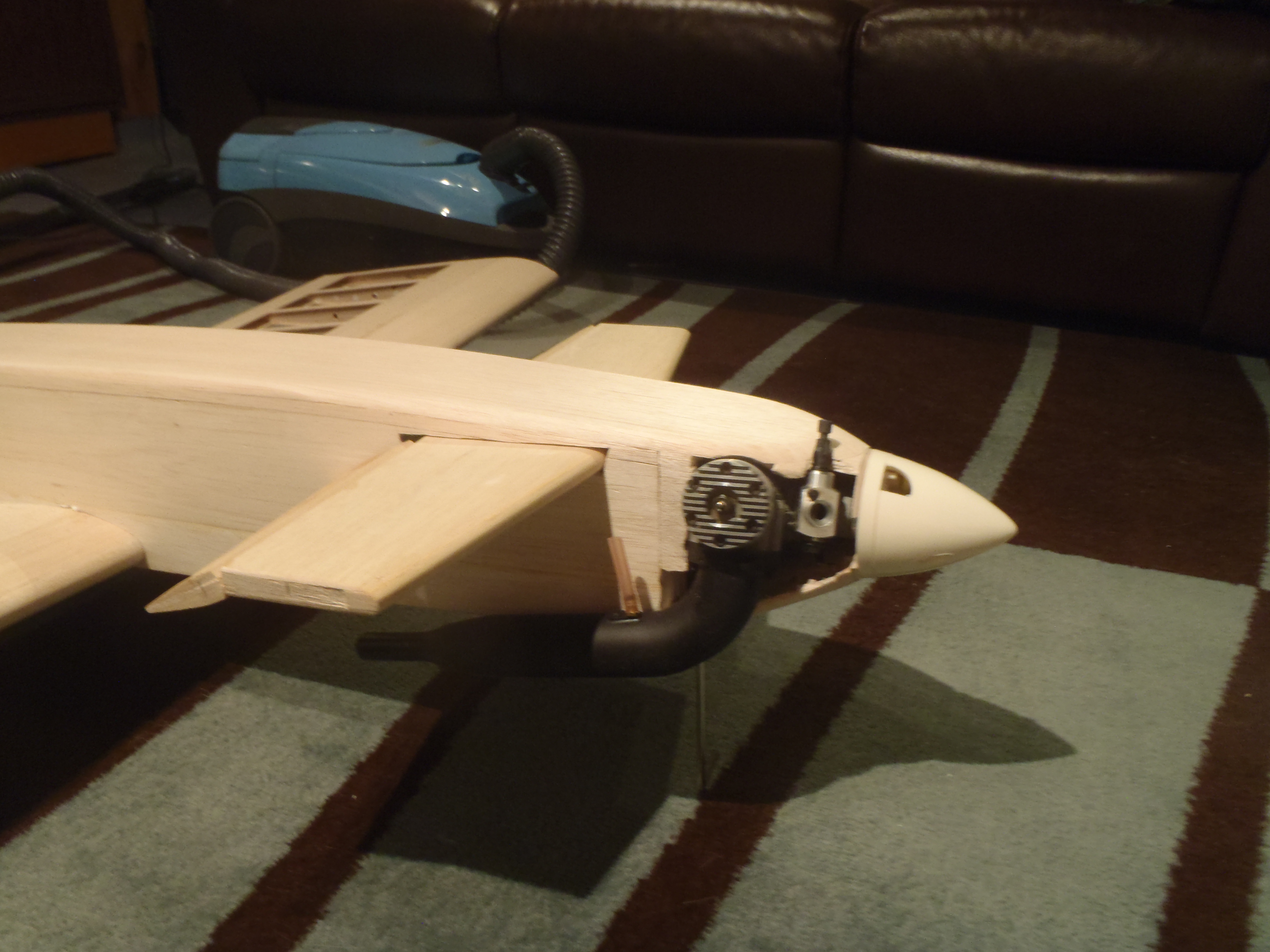

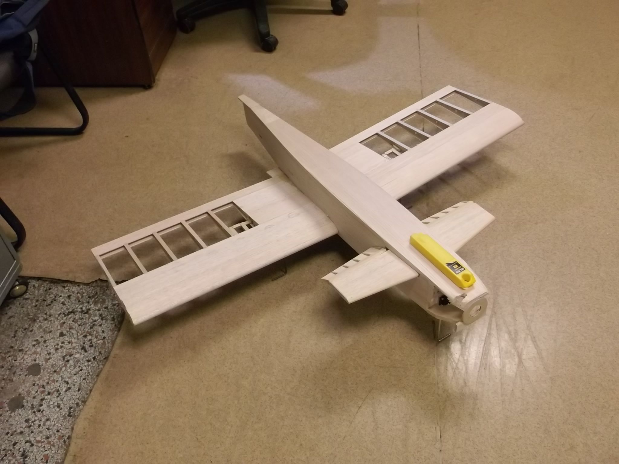

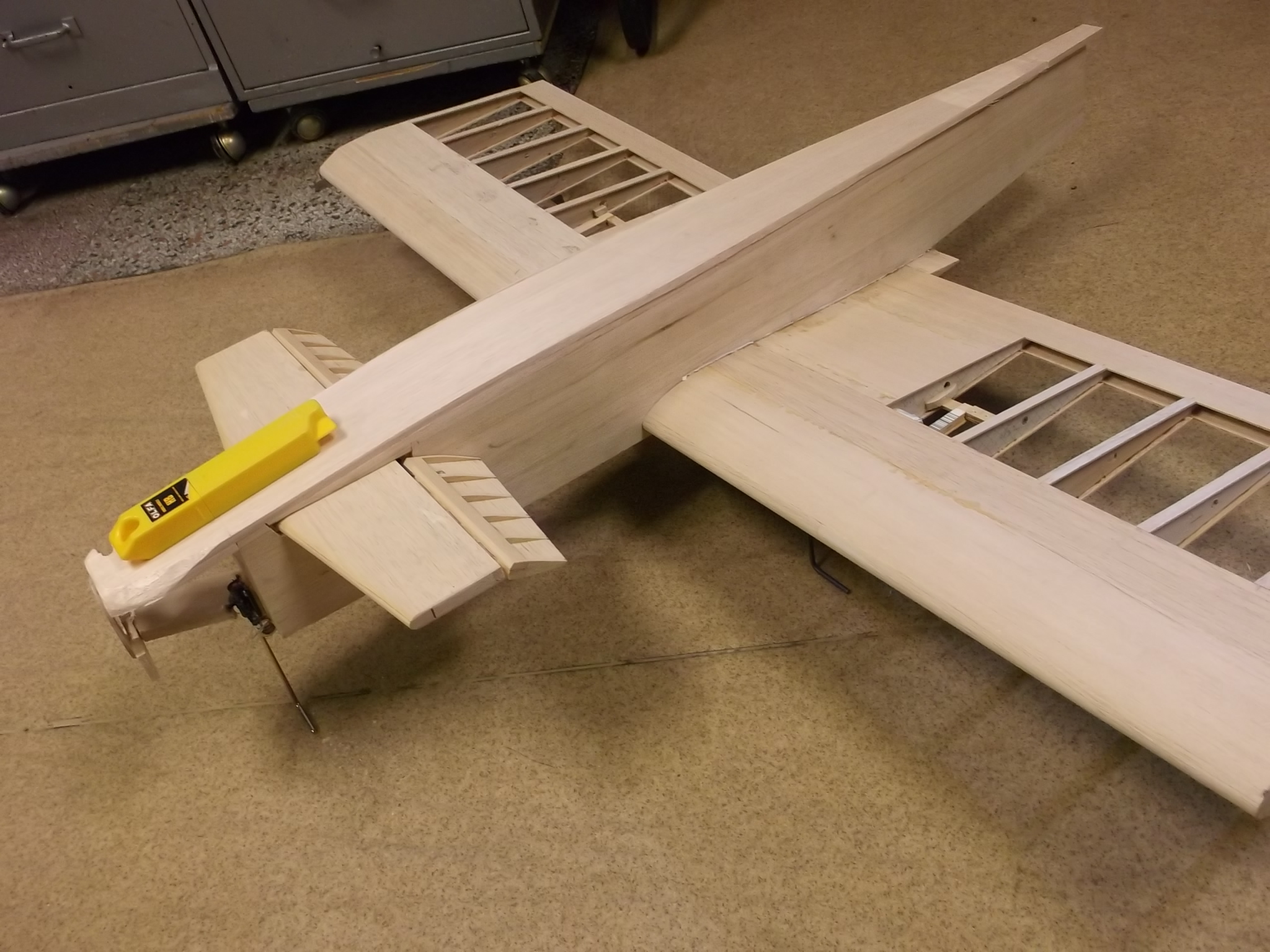

A little more progress.
Too bad I forgot about any right thrust until after I Mounted the engine and shaped the cowl
Calvi

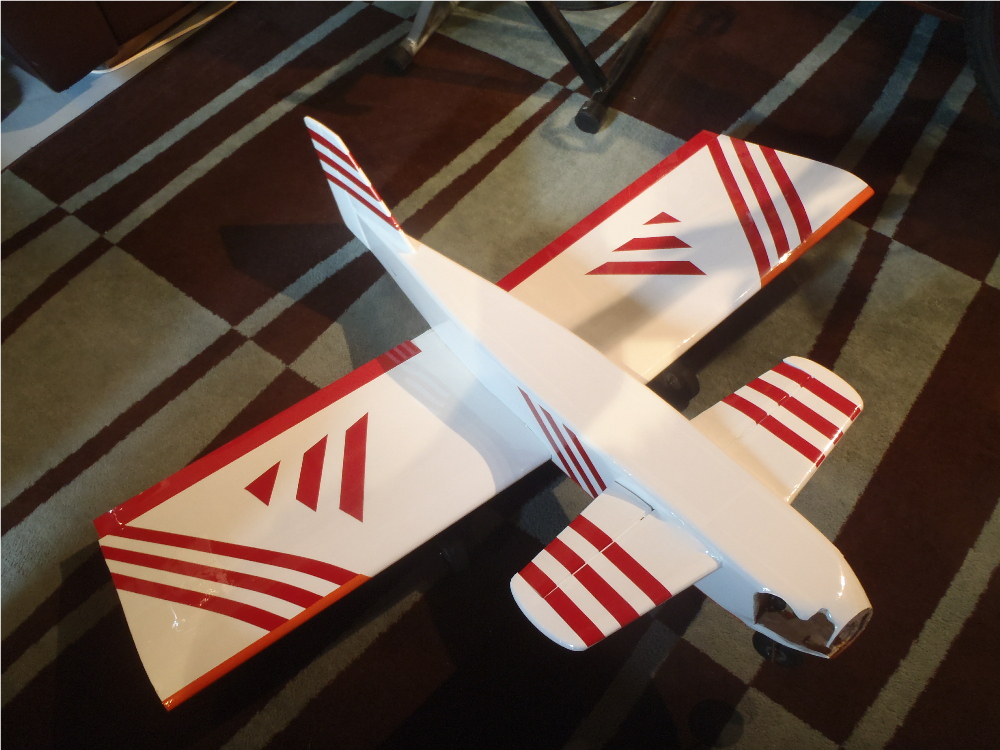

Old 05-14-2014 | 10:37 AM
Joined: Mar 2013
Posts: 751
From: Winnipeg, MB, CANADA

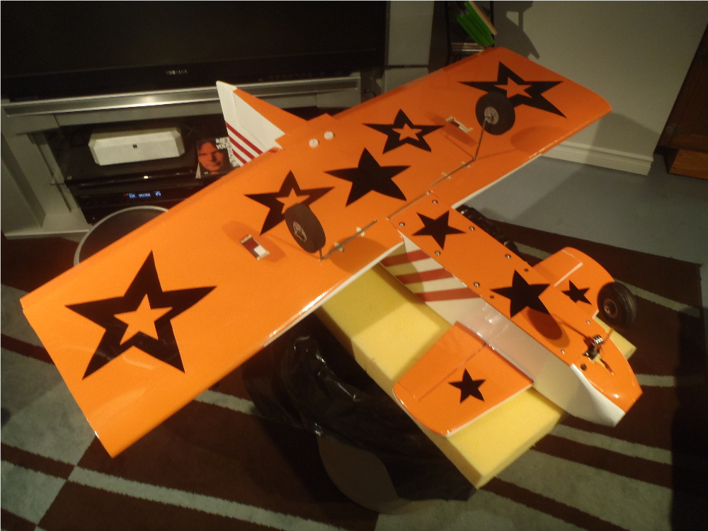

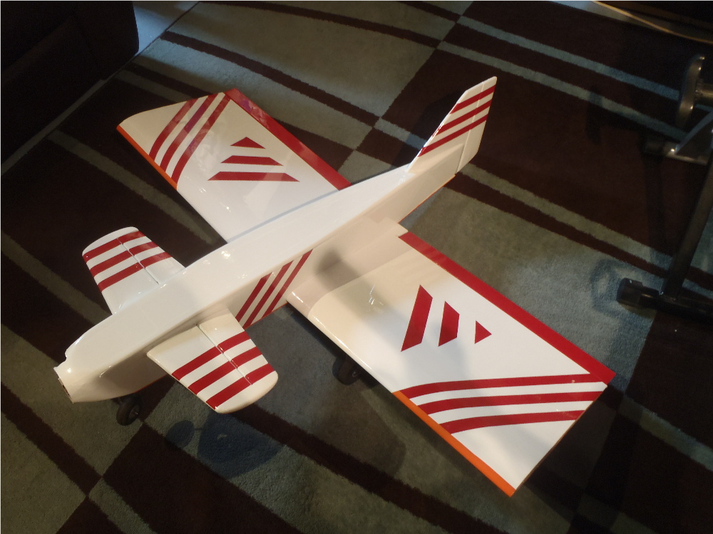

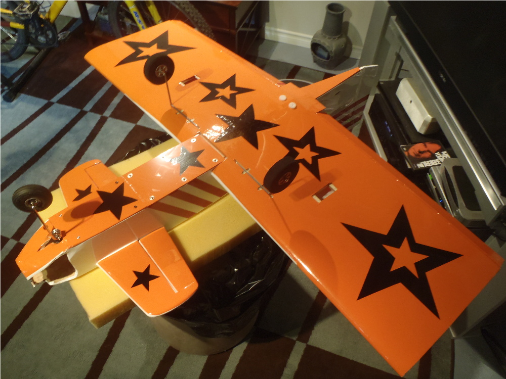

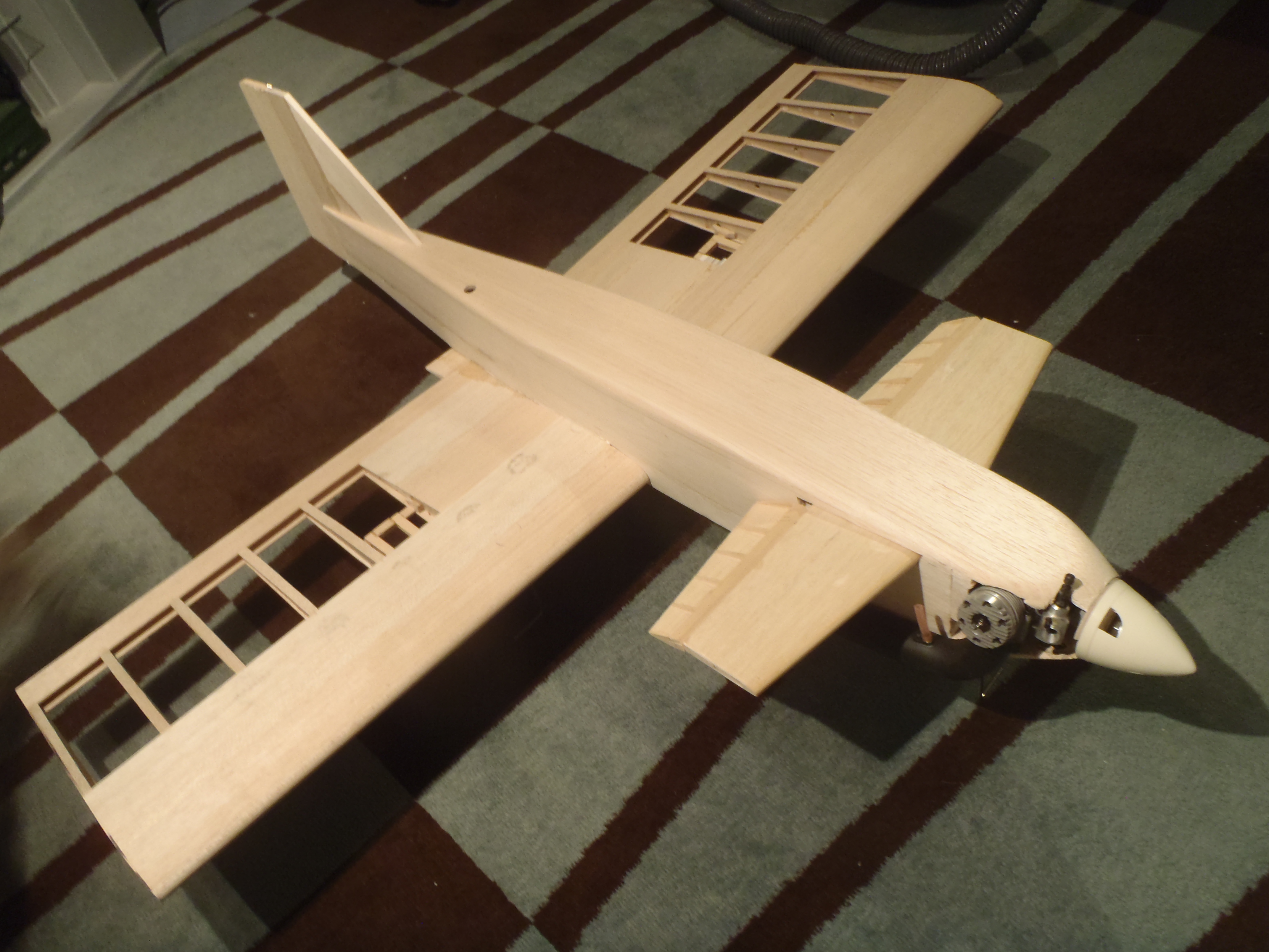

Got it covered, Red and white on top and Orange and Black for the bottom.
Now I have to get the radio gear installed and it is off for a test flight!
