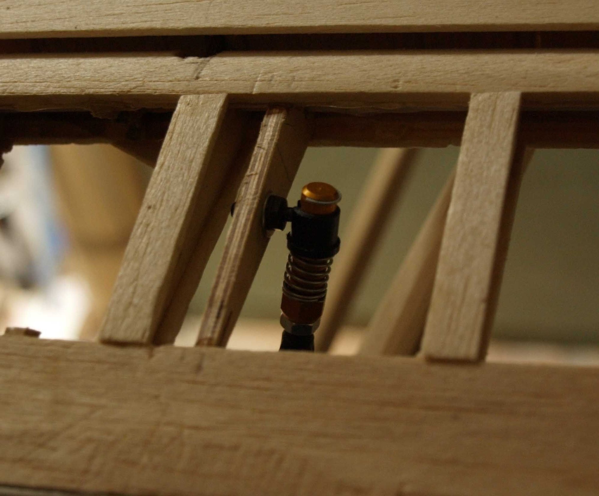

At first I`ve done the tail, starting with the tail wheel.
A friend of mine, owning a 3-d-printer made me the parts. I`ve done the metal work.
completed it looks so
now it`s added to the hull. I use a shockadsorber from an RC-car.
after that, I made the elevator push rod from carbon fiber
Elevator servo and rudder servo are done in place and the elevator push rod is installed.
.Now it`s time for the rudder linkage. The problem was, I could`nt connect the rudder ropes and the tailwheel ropes at the same linkage horn. So I had to build a linkage bridge.
the upper horn is for the rudder, in the middle is the horn for the tail wheel and the lower horn is for the push rod. I think the pics says moore than any words, the springs I`ve added into the tail wheel ropes protecting the rudder servo.

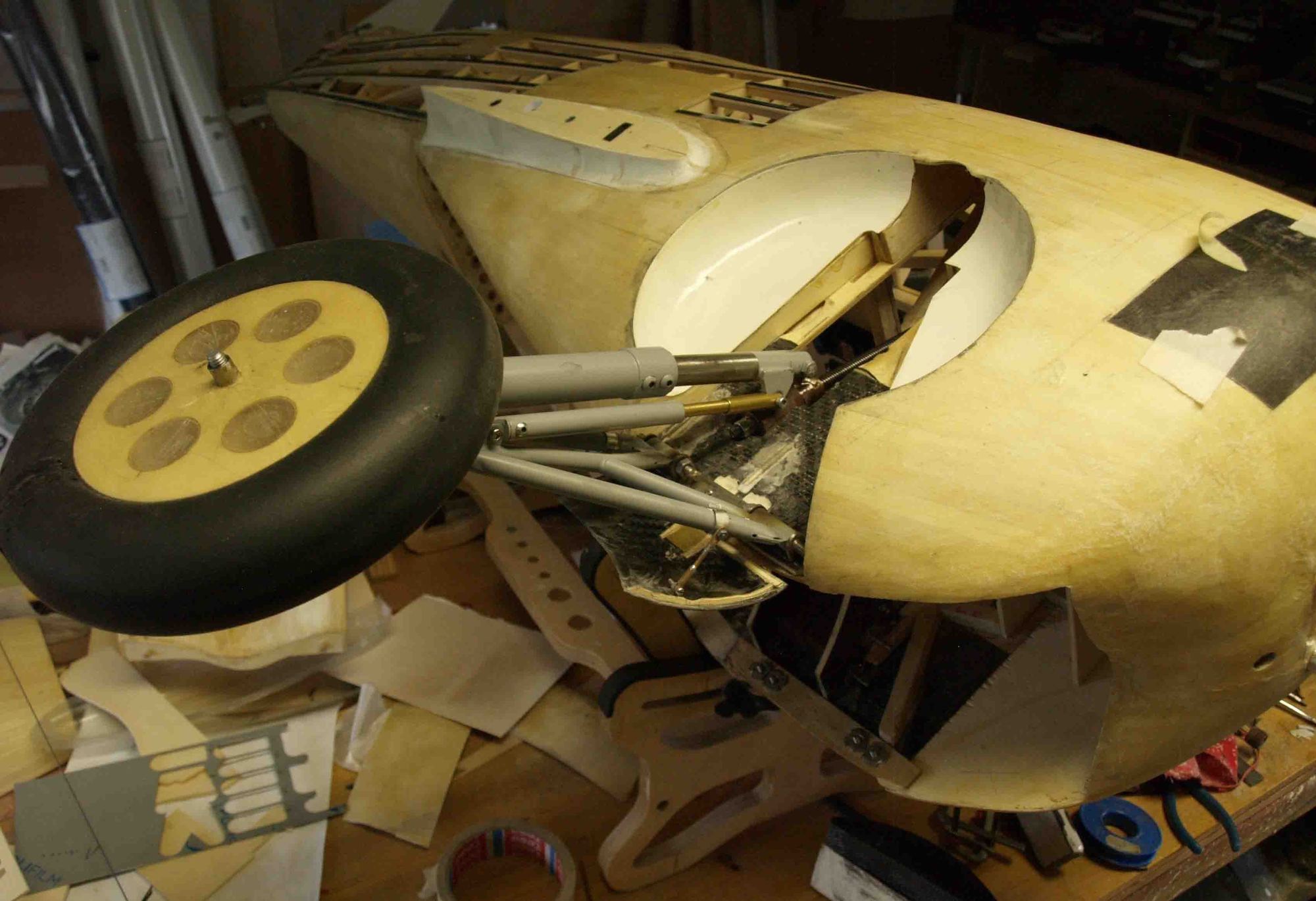

The next step was to build and install the landing gear doors.
At first, I cutted some foam in form and sanded it.
the door itself was made of glass and carbon fiber, laminated direct on the fuselage/foam.
after cutting in shape I glued some wooden reinforcements in place
it fits quite well
some struts of brass
Now its all assembled. It looks nice, seems that this was a very quick amd simple thing. But I can say how often I assembled and disassambled the whole thing. The little clamb on the landing gear structure was very important. This was the movable part to fix it.
Closed and out, it works pretty nice.
this little video shows how it works

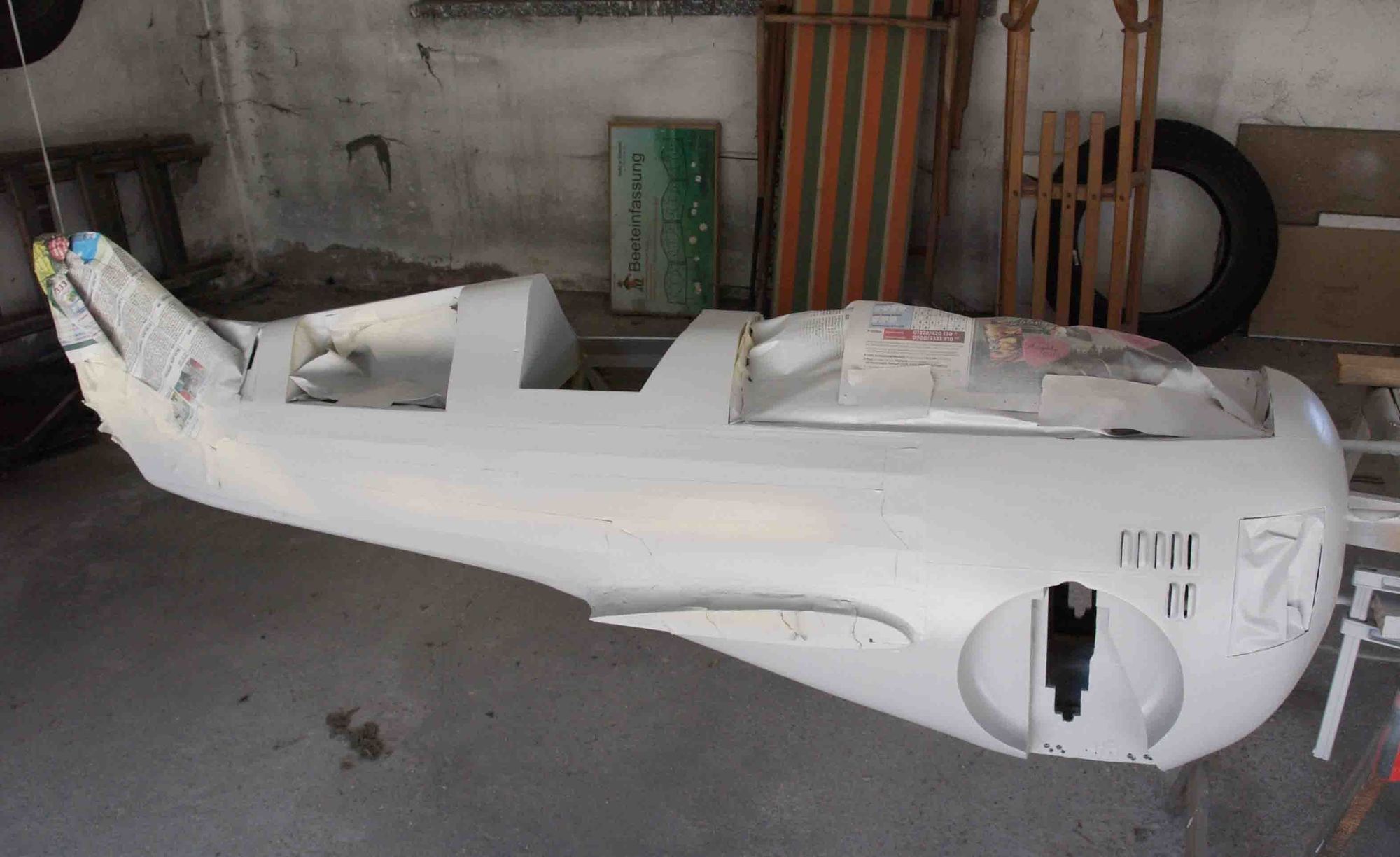

o.k., looks like I`m a quick worker, no I`m a laty writer. Fortunately I made any pics.
Before ivering the fuselage, I sprayed the first layer with filler primer to smooth the surface.
Now tho open parts are covered with Oratex
The next step was building of those ventilation slots. One of my friends in our modelling club printed me such a part. Pretty nice but it looks to clear. If you look at the original you will understand wht I mean.
So I used it as mould, made a tool and the were deep drawm of ABS.
the rest is very simple......
o.k., it`s a warbird and so it needs some arament. There are two gunblisters, I haven't found out until today why the are not symmetrical....
I`made them like all other additional parts, lamminated directly on the fuselage, the core ist Styrodur, a hard foam.
the rear part of the canopy I deep draw . There was a model to build, I made this also from plywood and Styrodur, covered with fiberglas. Deep drawing of such bigger parts is sometime a little bit tricky, fortunately it works at firtst attempt
As template for the canopy and for the frame I use a paper cut modell.

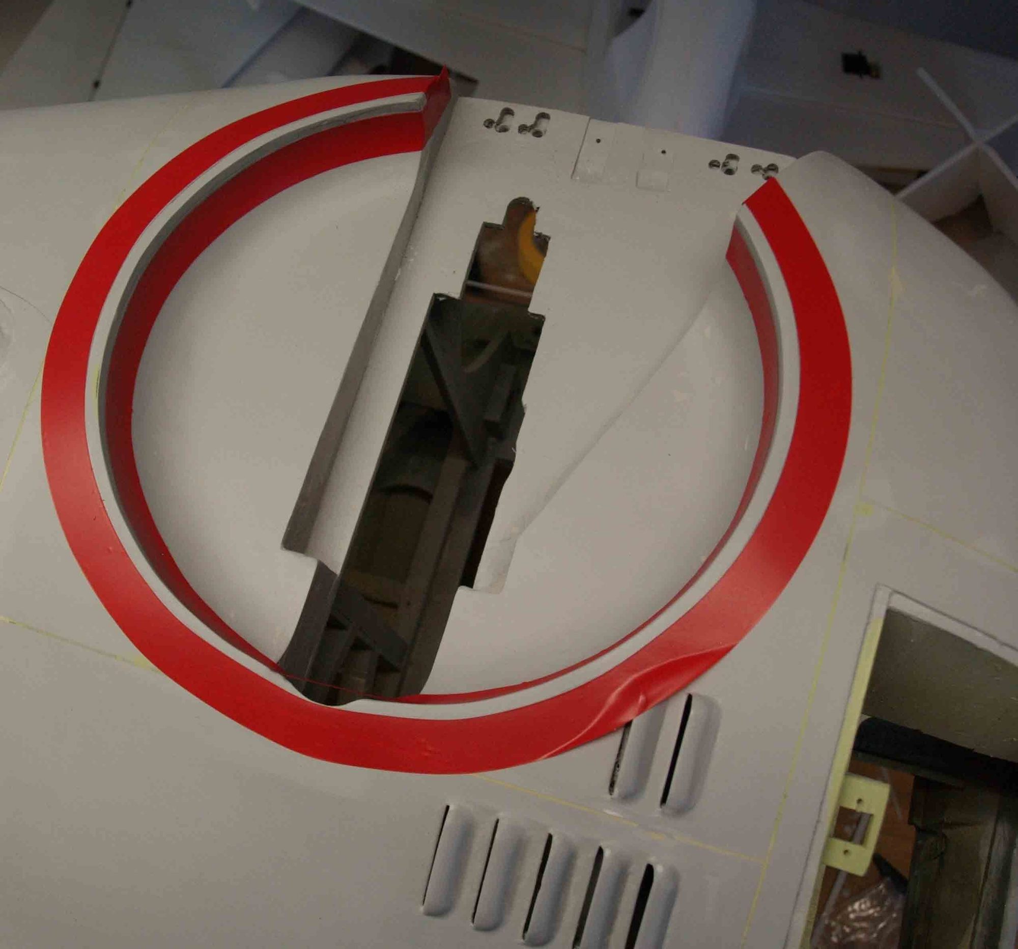

Now it`s time to makr the panels, service trapps etc.I use for tis some very masking tape, 0,75 mm wide. This is for the parts where some panels are next to next. If panels overlap I use an other technology.
Then I sprayed the next layer filler-primer, water-sanding, sannding, sanding....
On the cowling a small edge overlaps. This edge I market with a thick masking tape and added a layer of putty. This was sanded down to the tape and so I had it.
This technologie I used to all overlapping sheets.

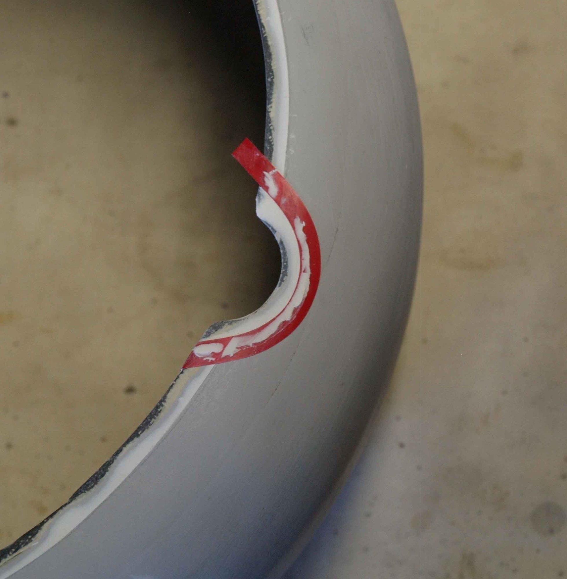

thanks a lot, guys, thanks a lot.
On the wheel arches Ialso added the overlaping sheets.
But then > desaster, I simply forgot to mark this. It looks so
So I had to mill of, marking with masking tape, putty and sanding.
On this airkraft are so many service trapps.
How to open, how to close? Of course, I would not make all of them work but it had to look so. Our copy shop staff cuttet me this of 0,15 mm Alu-sheet.
The rivets I`v made with a needle from the backside. On the pic above you can see the service trap into the wheel arches.
The rivet heads are made of a drop of "white glue". The hinge imitation is a 1 mm polystyrol wire.
the trap doors are made of 0,1 mm alu sheet. In this monent, I was faced to a decision > more detailing and may be it would notfly into the next two years, or, back to the roots (semi scale) and stop excessive detailing...... Rivets I will do but I`m thinking about cockpit, I think it would be a "bust-cockpit" not a complete one. The last complete cockpit took me more than six months...
Currently I`m i a Rehab facility so I can take time to decide. The thread is now up to date, we look ahead.
