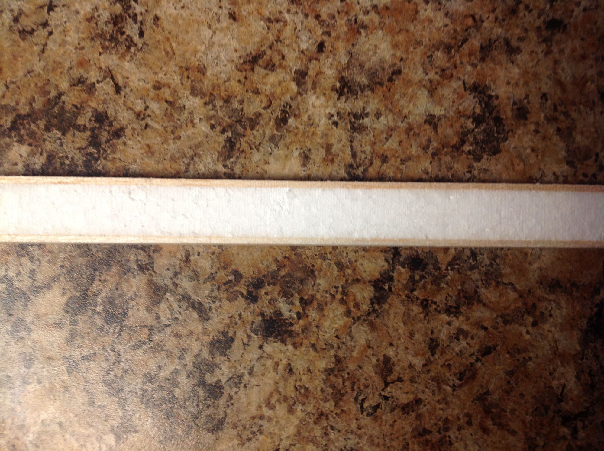

Thought thus may be of some interest. This is a section removed from a wing recently. The sheeting was applied using epoxy laminating resin and vacuum bagged. In order to get even pressure, I place the sheeted cores back into the shucks and then add 1/4" MDF to the outside of the shucks. Once vacuum is pulled the stack up gets even pressure that leads to straight wings but if the cores have cut outs for lightening or servos the sheeting will not get sucked in.

The sheeting on your part looks really good and even. I still plan to use PU glue as I find it easier for me to work and supply as well.
