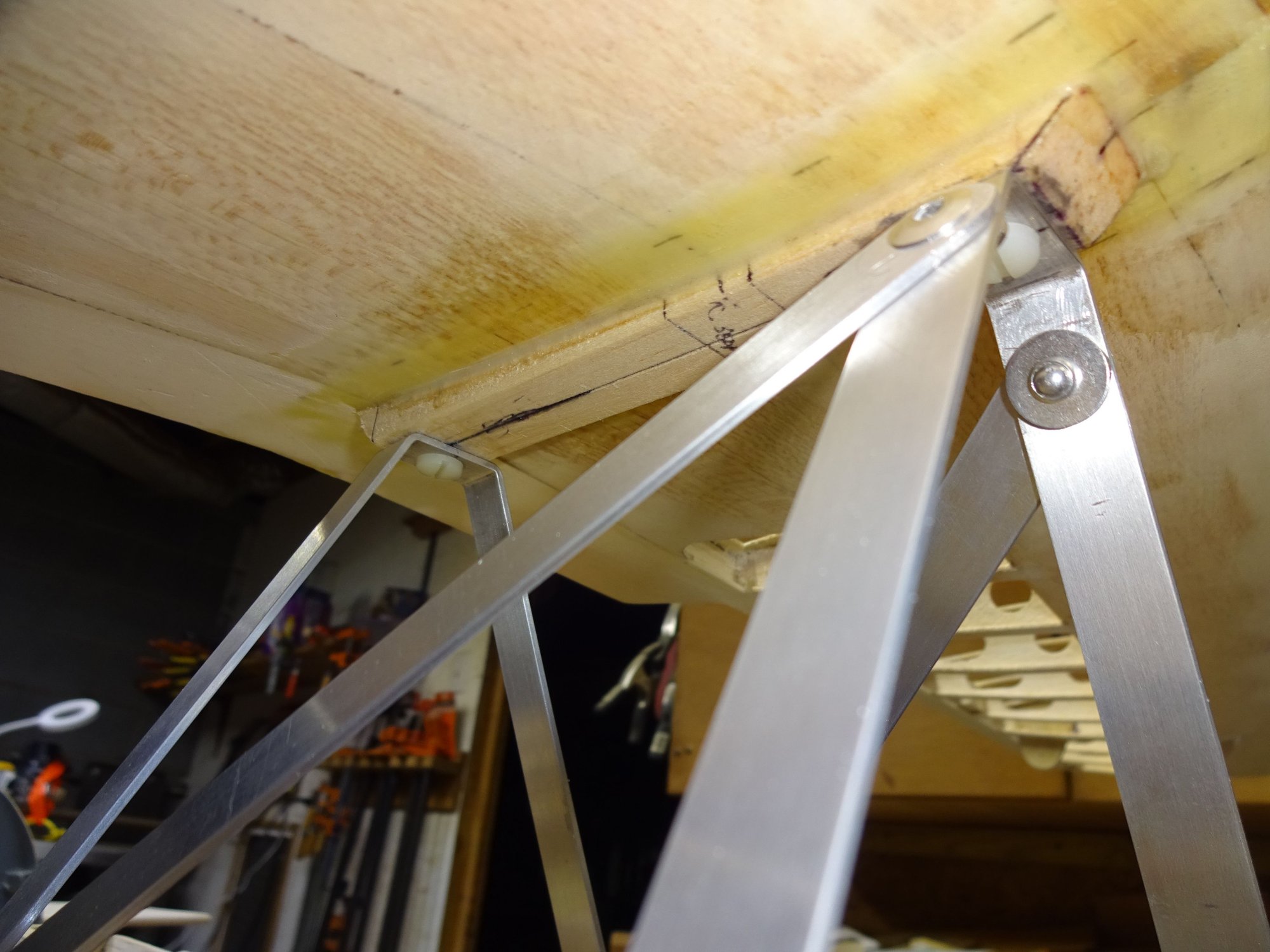

I've read and seen the mounting of the center cabane to the fuse sides with the nylon bolts. DId you use the thin wire per the plans on the upper wing, or mount in a different fashion? Didn't see the wire in your framed pic....

On that one, the top wing attached with (2) #10 or 1/4" (I don't recall which) nylon screws going up through the top of the cabane, vertically into the wing. I had solid balsa "meat" there, with which to tap threads into.
I built the original kit when they first came out in the 90's, and it was one of the best flying planes I have ever owned.

Here is a picture of that:

Yes! I like this...thanks for posting the photo! That helps a lot.
