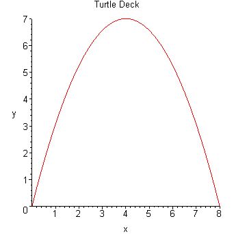

I have been messing around with designing my own plane. I am just doing a one-off design so I am just using paper, pencil and calculator. I thought I'd toss this out for folks to chew on, spit out or enjoy. Below is an equation that describes a turtle deck former (90 deg to datum). It's basicly an upside down parabola. I graphed the equation and it looks OK. Think it will work?
f(x) = h - [4h(x-w/2)^2]/w^2
h = max height
w = max width
x = ranges from 0 to w
I have not tried the first turtle deck former that is usually angled back, but one needs to modify h to:
h = (a^2 + b^2)^0.5 a=distance back horizontally, b=max height vertically (see picture below)
I attached a Maple 8 plot of the first equation (h = 7 cm, w = 8 cm). Looks like a turtle deck. Now I need to cut it out. I suppose basic math does have purpose????

With Autocad, I draw an ellipse about the rigtht size, chop in half, then plot it out (1:1) onto cardboard, and use that as my 'template'. Resize (rescale) the ellispse as needed..
The nice thing about an ellipse, is that the mid points; the 'quadrant points' will be 'tangent' to the sides of teh fuse, and blend nicely to teh built-up box fuse.
(The parabola you've posted looks like it starts off already at an agle, and in my opinion, would look funny. No smooth transition from vertical flat to curvy..)
just my $0.02 worth....

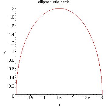

Dr - You are right, I think blending at the fus is going be awful!!!! What's wrong with me? I will look at an ellispe since it should blend much better. I suppose I got too caught up in just being able to do this that I actually forgot what I am trind to do, produce a good looking turtle deck!!!!! Best $0.02 worth I've received in a long time. Thanks.

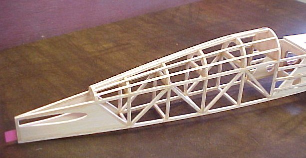

The 1st photo below shows the rear section of an autogyro that I drew up in T/CAD which has half-elliptical rear fuse bulkheads. Once you're happy with your side and top view fuse contours, you draw ellipses at the necessary stations with the major and minor radii matching the appropriate height and width.

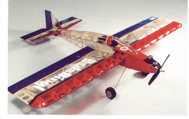

The second plane was designed exactly the same way. How did we get along before CAD??

You are right about the time spent learning how to use CAD will pay off in the future. I just like messing around with math (do some here at work) so I just wanted to see if I could use it for something useful. I took your advise for using an ellispe and starting with:
x^2/a + y^2/b = 1
came up with:
f(x) = (h^2 * (1 - [(x-w/2)/(w/2)]^2))^0.5
h = max height
w = max width
I have attached a plot with h = 2 and w = 3. Looks much better this time. Thanks folks!

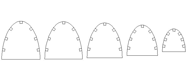

I was fooling around in CompuFoil this morning and got it to loft a "wing" with elliptical "airfoils." The "root airfoil" (half ellipse) has a thicker % than the "tip airfoil" just for giggles and I had C/Foil loft a set of "ribs" on an elliptical planform (to get a set of bulkheads that will give a curved fuselage turtle-deck profile) with the "spars" (stringers) placed at the same % of chord so that you don't have to manually draw in all them stringers in CAD. I imported the resulting "ribs" as a .dxf into T/CAD and here's what I got. The span, chord and spar locations can all be changed as desired and C/Foil will happily loft all the necessary "ribs" (bulkheads.) That's gonna be good tool on the next airplane I do with a turtle deck. Should save some time!
