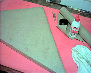

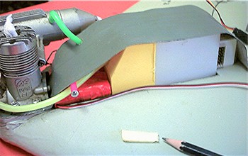

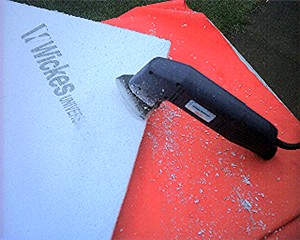

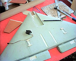

Here's my attempt at a foam model. I call it the Mac-pie2. Span 36 inches and length 19 inches. Wing loading apprx. 16 ozs per sq/ft. which is light.
A sheet of polystyrene merely shaped with a detail sander. The fins are foam board and the cowl cover is made from a soda pop bottle and painted. With an OS .35 on board she weighs 2lbs 3 ozs.
The styrene is covered in brown parcel paper with 50% thinned pva wood glue and allowed to dry for 24 hours. Next a light coat of glass fibre resin is applied with a piece of 1/64th ply . Weight gain is very small but the model is now very strong.
It could also be converted to electric.
Currently I'm scratch building my own design based on the Mosquito called the Macs-quito. Again foam covered in paper with a 38 inch wingspan and 2 x 400 electric motors with 8 cells.

Neat lookin wing Macx! I can't tell from the pics what ya used to bolt the engine down?

Make a 1/8th tray as shown and epoxy inset into the fuz. front. Under the front end epoxy fit hardwood blocks which the engine will bolt into. My blocks totalled 7/16th in thickness. Install to allow for a few degrees of sidethrust. Then cutout front of tray to accommodate engine. I used self tapping screws with Theadlock. Fuel proof the tray. The tray top is velcroed using epoxy. Likewise the tank and flight battery bases are volcroed and the pop bottle top cover holds everything firmly in place.
The last image is my current project a 38 inch span Macs-quito.

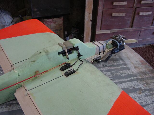

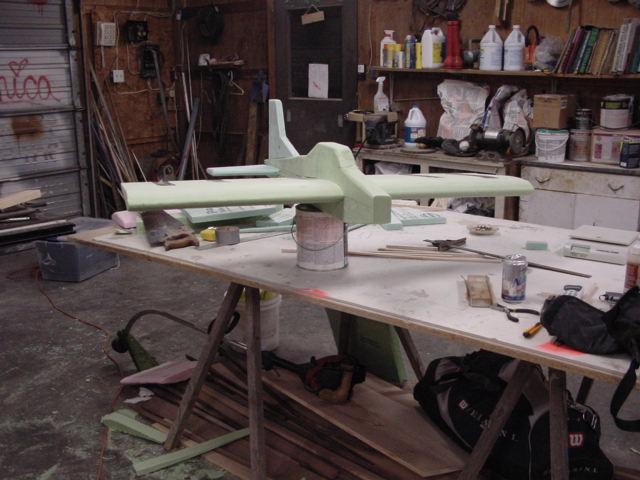

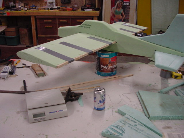

Sorry it took me couple days to get the pics up but life gets in the way occasionally.
It's comin out pretty neat but I think I'll never hit the weight I wanted.
I think it'll still fly nice enough though.
I'm kinda guessin it'll be a easy flyin plane with some aerobatic ability in a limited way.
(which by the way is probably ok with me)
I got the balsa glued into the trailing edges I just gotta decide wether to use solid balsa or foam for the control surfaces.
I think I'm gonna cover it with newspaper and thinned wood glue. I think structurally it's strong enough it's just that every time ya grab it a little to hard the stuff dents. Plus I spose it'll make it look better with a little color. (I'm gonna find some COLOR funny pages.)

Looks like it's gonna be a winner!
Just personal opinion...I think you could take almost an inch off the top of that fin (or more) and it would give it a little more streamlined look.
It will also help with tail heavy situation too...if you happen to have that arise...
My fins heights are usually around 3/4 to 2/3 of half the horz stab.
Taller rudders have a way of inducing roll and pitch coupling in knife edge too..(kinda acts like an aileron or elevator in knife edge)....so the less rudder you have away from your aircraft centerline the better you'll be.

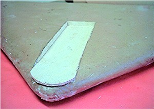

Ailerons - I usually just cut them from the foam...trim down the top and bottom at the leading edge of the aileron to accomidate sheeting, so the leading edge of the aileron ends up the same thickness as the trailing edge of the wing (where I cut the aileron out) (airfoiled surface) then top-hinge them with packing tape/covering.
I use the thickness of the sheeting to act as a guide to do my cut at the leading edge (leaving the trailing edge the same thickness) then just flipping it over and doing it on the other side:
http://www.crazyherb.com/PLANK/IMG_1250.JPG
Here's a pic of the results:
http://www.crazyherb.com/PLANK/IMG_1264.jpg
I have not had a hinge failure yet.....even on the big ones...
Good Luck!
CrazyHerb

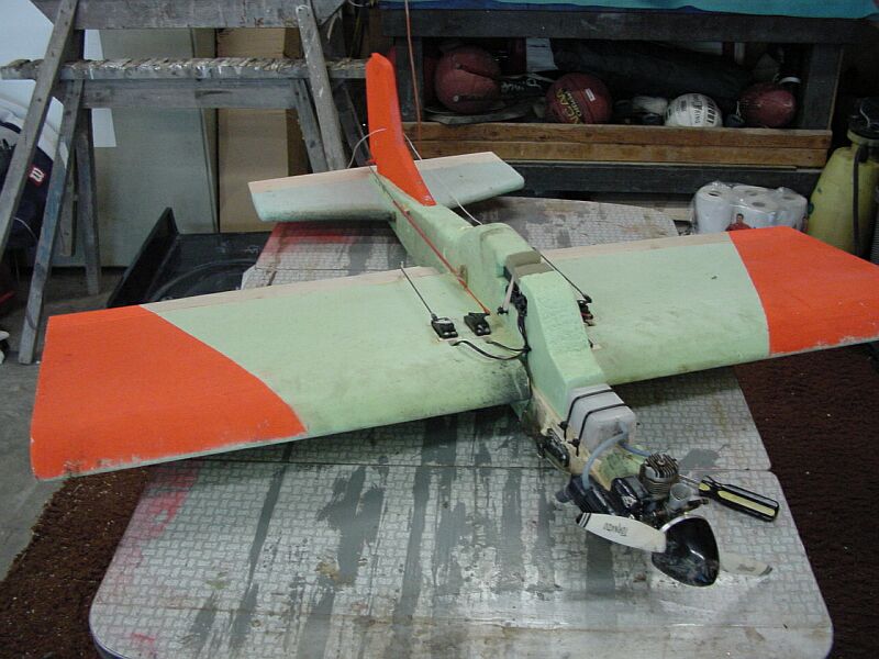

Clear packing tape....ah-la Zagi method...
I've also used monokote right over the foam...sticks well..just don't let the iron sit in one place too long...
ULINE brand packing tape works like mad....and they sell it in colors.
I've actually flown them with NO covering....as long as you wipe off the goop right after flying....the extruded foam doesn't absorb much....I've flown a little greasy mostly uncovered 1/2A for two years...with just packing tape on the leading edge and down the centerline...
I've just drawn up how I do my sheeting for ailerons and stuff...(airfoiled surfaces)...here:
http://www.crazyherb.com/PlansandDrawings/SHEETING.jpg
Hopefully that explains it pretty well...
Good Luck!
CrazyHerb

I didn't get anywhere on it last night I was doing test pieces of newspaper and glue. I'll get back at it workin on the plane tonight I hope.
Anyone know the best glue / water ratio for applying newsprint? Is it the same ratio for the second coat?

Well it's taken me awhile to get back to this thread with the results.
After 2 crashes due to a bad battery pack, (fixed now) and a few modifications, the plane is a nice flying machine.
I had landing gear on it but 1st night out a weed landing removed them and the loss of nose weight made the plane fly great.
After the rebuilds and just minor changes I came in at 4 .lbs 11 .oz
I let a couple of guys fly it after it was done and they all said it flew good. A little tame for their tastes but a nice flyer.
Ya with the .32 on it it doesn't hover or nothin, and you won't go out of site vertically but I'd say I hit my above stated goals as far as flying goes.
As for build time it took longer than hoped but with some redesigning I think that can be resolved.
