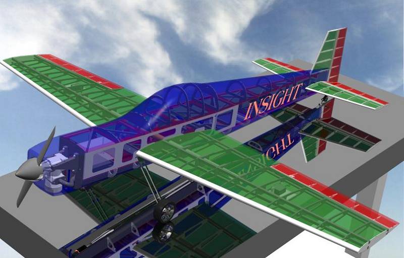

Jvigani,
Thank you for the informative answer. I have become proficient using Solid Edge and I now I would like to get better with Solid Works and your information helps a great deal.
THanks again,
mark

Old 01-31-2006 | 02:43 PM
Joined: Oct 2003
Posts: 67
From: Somerville, NJ
Default RE: solid model
flyintexan:
