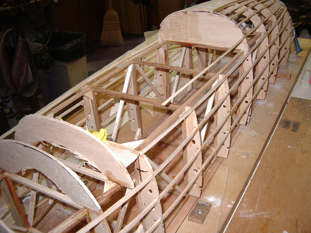

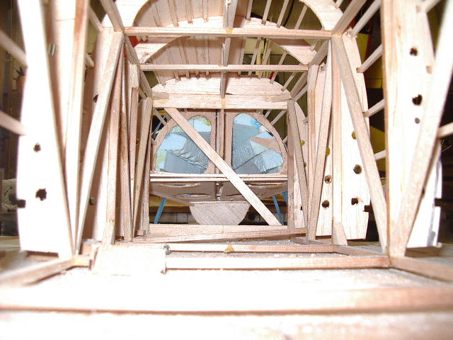

I gave up trying to find plans , Palmer appears to be the only ones out there so I am designing and building one, it will not be true scale, I needed something around 86 inches, 900 sq inches under 10 lls with 22 oz wing loading. power will be 2/52 FS Surpass , the attachemnts show some of my progress ,at this point the fuse weighs 9 oz, the wing is also under construction Mike
