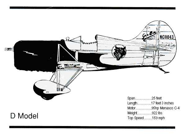

I have been working up a set of CAD plans for a Model D Gee Bee and am in the process of building a second prototype.
It is built around a speed 480 E-Flite outrunner motor with a 2000ma battery. 43 inch wingspan shooting for 30 oz
The first prototype is completed exept for paint and I have started the second one to clean up some of the areas that needed weight reduction.

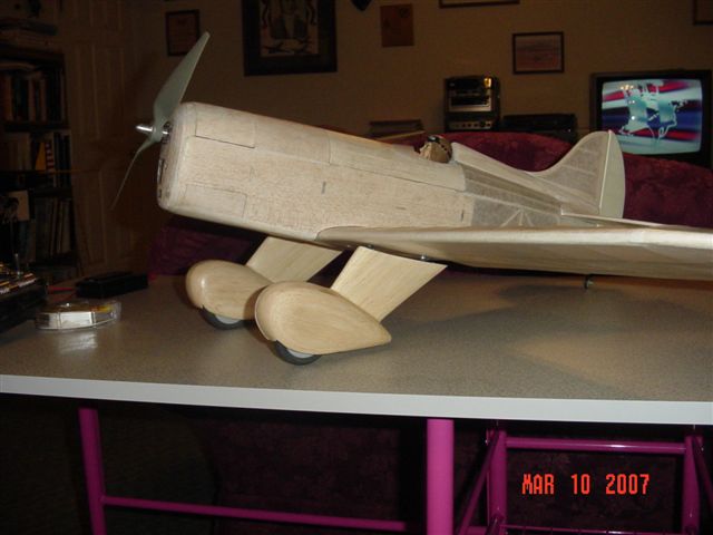

This is the first Phototype in dope and silkspan (Wouldnt Recommend it. Wife is whining about the smell.) It came in at 35 oz and I am doing the second in cover lite.

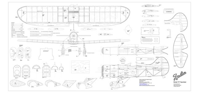

I have been able to reduce the plans to post here in a JPEG

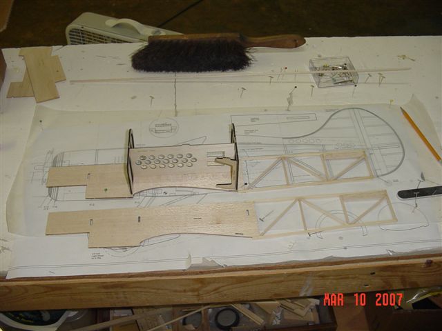

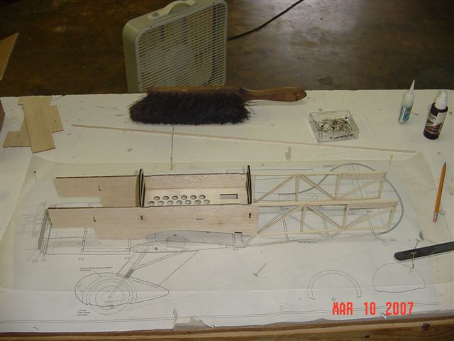

The Model D is one of the lesser known Granville Brothers creations and with only one built it has not been over built.
I hope to have the plans available thru Model Airplane News soon but if not I will make arrangements to provide them to anyone wishing to build.
It is a balsa/ply electric built around the Speed 450 to 480 outrunners that are popular right now.
Construction is started the old fashioned way of building a left and right fuselage. Frames F-3, F-4, the battery compartment floor and wing hold down are tabbed into the sides prior to joing the two halves.
