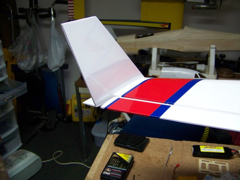

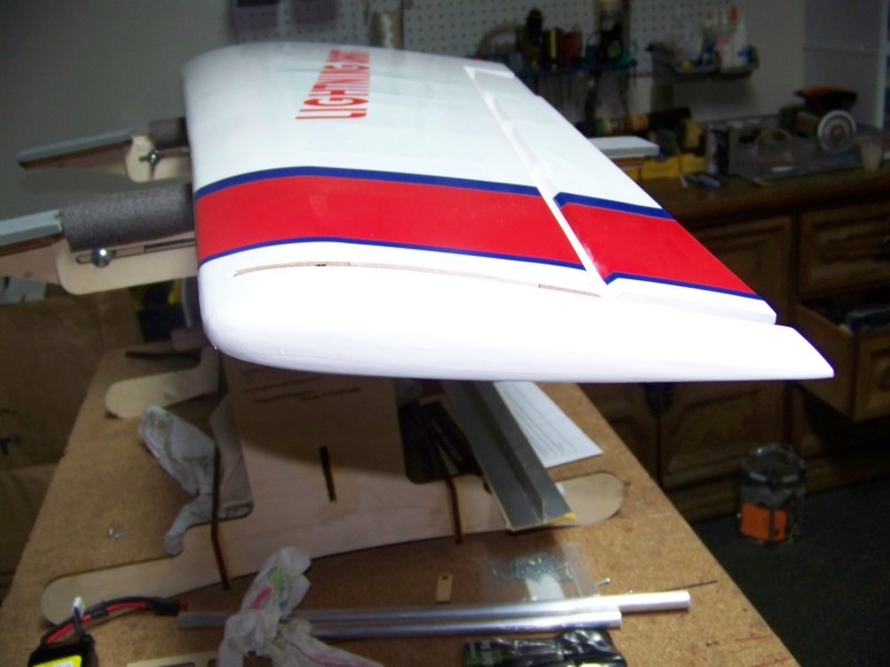

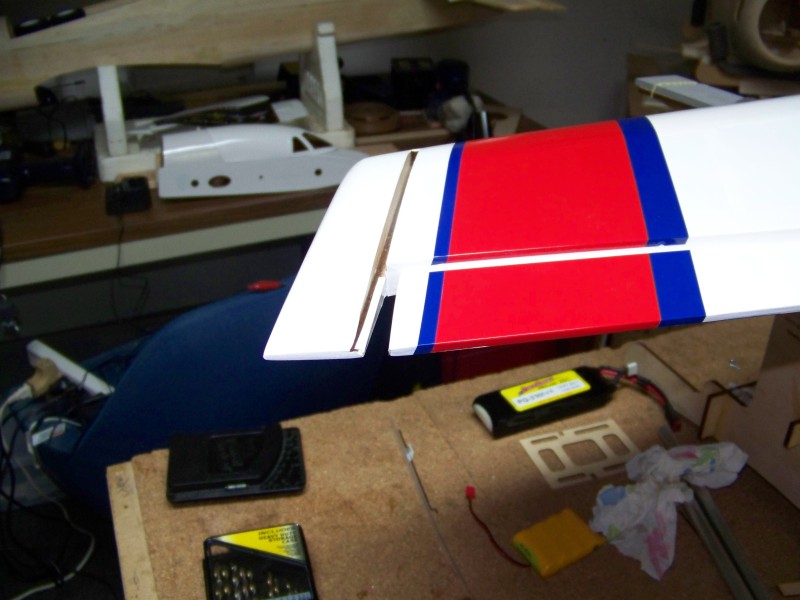

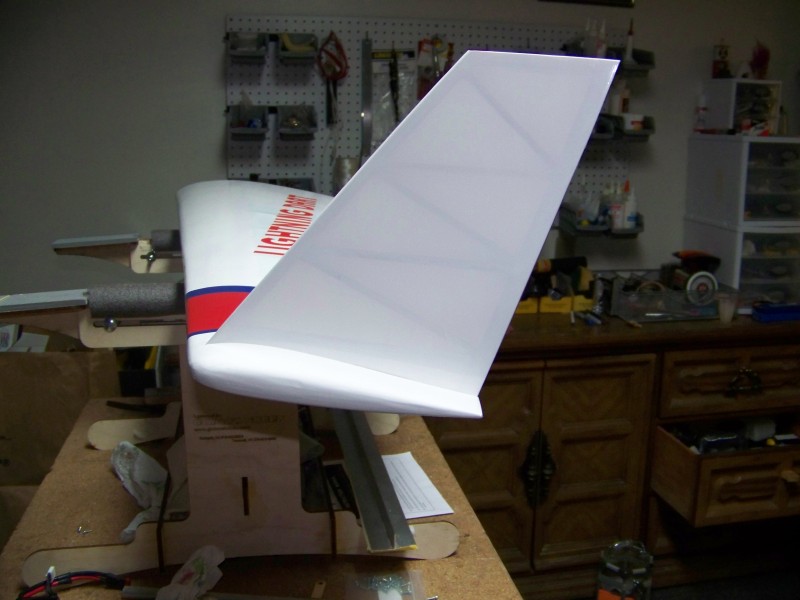

I am building a Lightning Dart ARF. I am posting this message in hopes of getting ideas from scratch builders on how to make the wing tip stabilizer removable for easy transport to the flying field.
I have made numerous modifications to this ARF to make it better in my opinion. However, the wing tip stabilizers present a major problem for transporting the plane to and from the flying field. They are just asking for damage as they are built very light weight as expected.
I thought I would avoid the "OH no" issue by making these stabilizers removable. I would like something simple and quick as I hate major assembly at the field. I thought I would drill a hole through the wing near the center of the stabilizer to accommodate an attachment screw that would screw into a nut on the bottom of the stabilizer.
Anyone got any thoughts on how I could accomplish this modification?

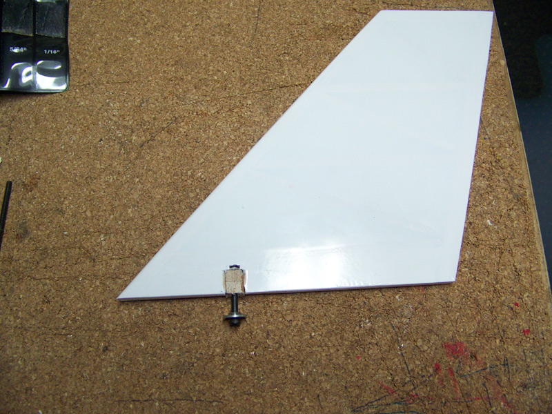

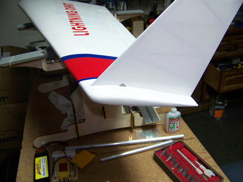

I found two aluminum aileron horns in my spares box. They are the tower (post) type horns. I glued them into balsa and cut the balsa into a square as shown in the photos. The aileron horn was for a 90 size plane so the screw was a bit big. I used it anyway as it was free stuff. Like you said, toothpicks would have been enough so this is 100 times overkill.
I attached a few photos of the mod but now I have removable tips .
