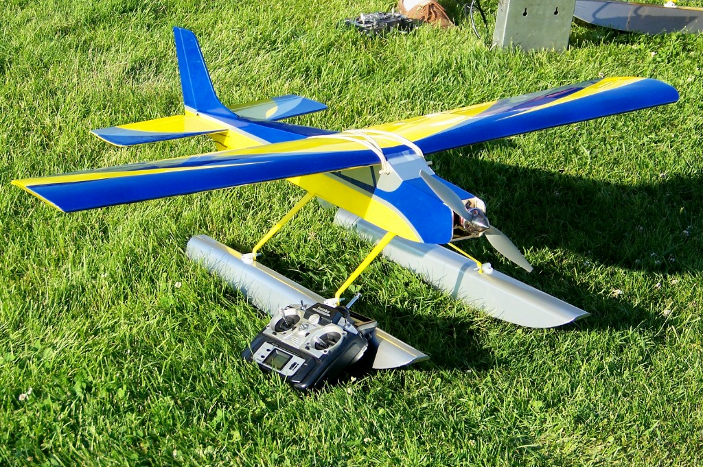

The plane is a 3dhobbyshop.com EBT (electric basic trainer) on seaplanesupply.com 30" flat bottom floats. Power is provided by an Extreme Flight Torque 2818-900 motor, Hobbywing 40amp sbec esc, GensAce 3s/2600 lipo packs, and Hitec HS-65HB servos. I have put over 140+ flights on the EBT all on floats and the only modification I made to the plane was the addition of a subfin for yaw stability. The floats are covered with Ultracote only, including the bottoms, to keep them light and they only add about 6 ounces to the weight. The Ultracote has been surprisingly durable on the bottoms and has held up for the 140+ flights without a problem. Being a trainer the plane is a very stable flyer but, as seen in the video, is agile enough to be interesting to fly.
