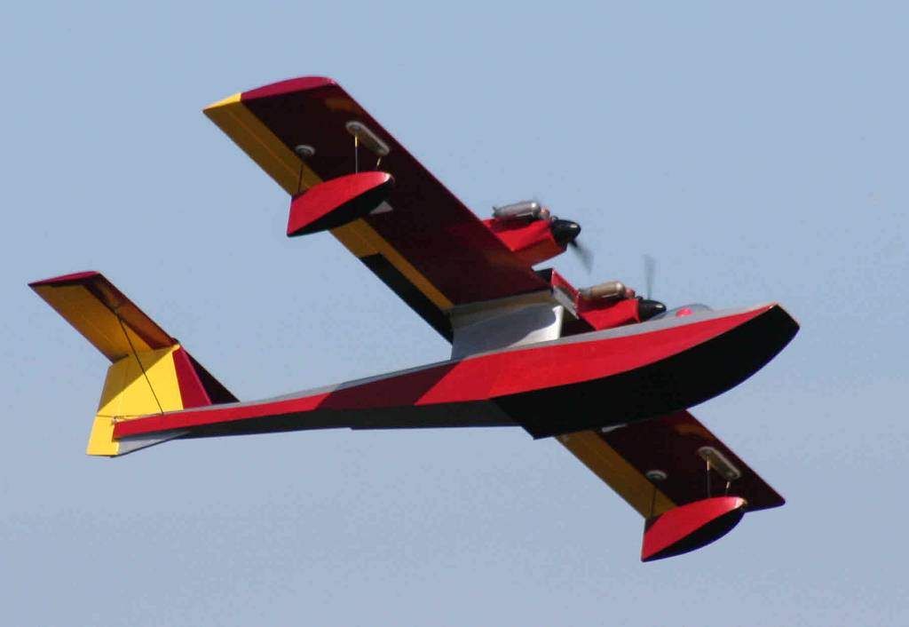

I'm not familiar with ASP 25's, but as with any other twin be sure the engines are reliable, especially in the mid range where most of the flying will be done. I used a pair of old HB'25's on a twin seaplane about the same size as the Sig sealane and it had plenty of power so your 25's should be fine. My current project is a Sea Cruiser (designed for a single 40/45) and I am using a pair of OS 26 four strokes. From my experience it should have lots of power.

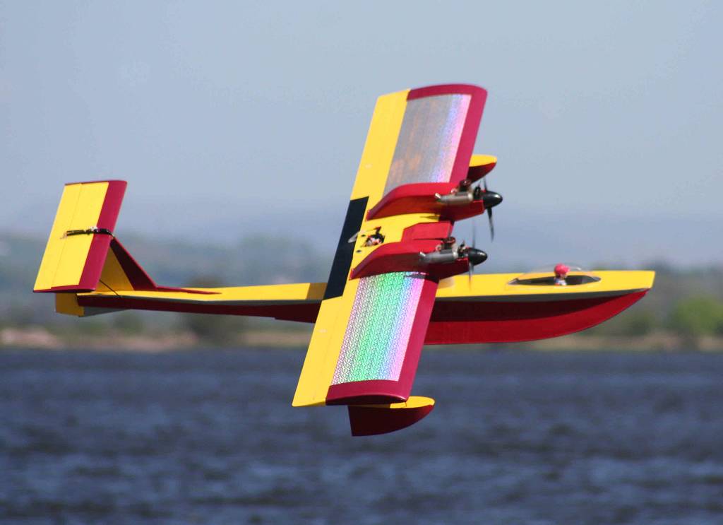

Twin 25s on a seamaster should be fine. twin .40s should provide unlimited vertical. But you should raise them a little to keep them out of spray, and unless you have cleverly arranged for one of the motors to have reverse rotation, the right one should be toed out 6 or 7 degrees.

Thanks for all the info. I am using the asp 25's because they are only 37.00 each. Hope I get 2 that run fairly reliable. They are the same thing as a magnum 25 xl not the xls. most of the reviews of the xl seemed ok, the xls was super. The thrust line of the 25's will be about 2.5" to 3" lower than of the engine pod design. I am hoping that it will fly well. I have already put the engine pod suports in the fuse before I decided to go with twins so if I build another wing, I could still put one big engine on it. Will 1/8" birch ply for nacelle sides with 3/16" firewall be strong enough to hold a 25 engine? I will glue each nacelle side to a rib side and the main spars (top and bottom) will go through the light ply.

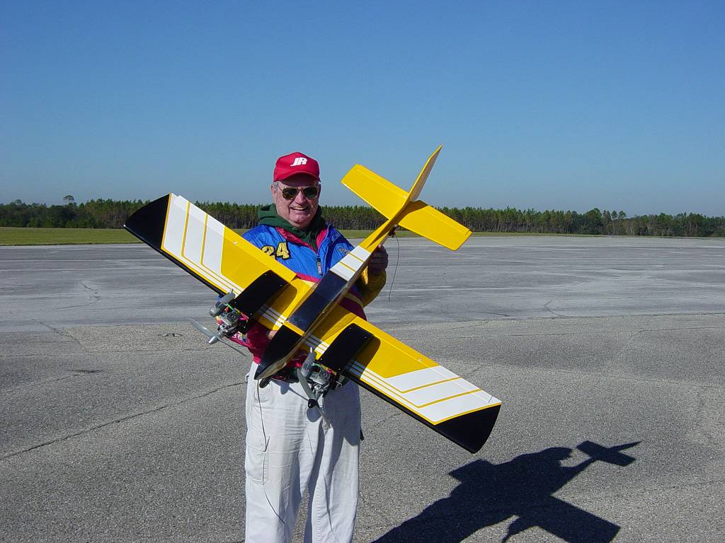

Back when RC Report was a print magazine and I wrote a monthly column, my flying buddy, Carl "Flaps" Laffert, I did an experiment on out thrust. My test plane was a Goldberg Tiger 2 (.46 size). We added 2 nacelles and covered over the engine compartment. Power was 2 OS .46 AX's. The nacelles were built with 8 degrees of out thrust. Total weight-8.5 lbs.
I realize that 8 degrees looks huge and most people would think that you'd lost a large amount of forward thrust. I did the math and the cosine of 8 deg. is .99027, meaning you have a tad over 99% of your forward thrust. I confirmed this in flight to the best of my ability.
For testing, once the plane was trimmed and I had gotten used to it, I filled the left tank 50% full and the other, all the way. Then I cranked and took off and flew my usual aerobatic flight. The idea was to see how out thrust helps without knowing when the engine will quit. When the left engine quit, I didn't notice anything except a loss of forward speed. No yaw, no nothing. Next, the right tank was filled half way and the left all the way and the test repeated. Same results. Out thrust worked great.
At a later date, I built a Twin Stick ARF, also with 2 OS .46 AXs and 8 deg. out thrust. It turned out a pound lighter at 7.5 lbs. It would easily do any acro I wanted on a single engine.
I will admit, the looks of 8 deg. out thrust will scare you, but after several planes using this amount, I am convinced.

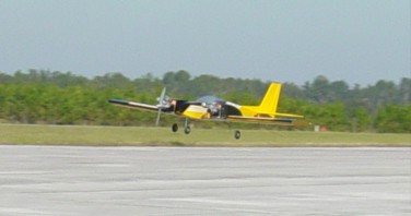

My Lomond O/D twin has a wingspan of 74" and is well over-powered by a pair of Irvine 36 engines.
The model flew previously on a single Jen 56 two stroke and was overpowered, but I used the 36s as I didn't have a pair of 25 engines, which would have been better.
I fly at sea level, so if you fly at 5000 feet it may be different.
