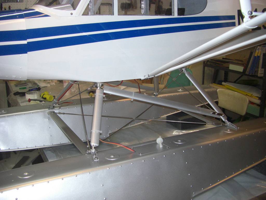

Old 02-02-2013 | 02:25 PM
Joined: Jul 2006
Posts: 872
From: , MI
Default RE: H-9 super cub
some photos

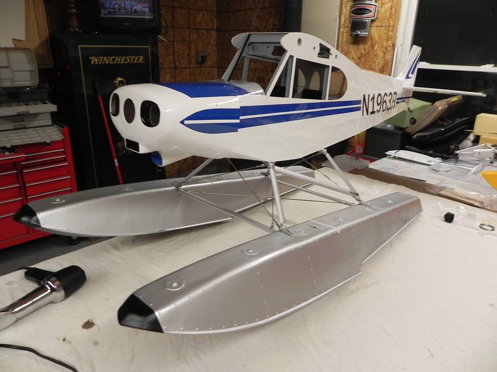

Old 02-04-2013 | 06:54 PM
Joined: Jul 2006
Posts: 872
From: , MI
I forgot what a piece of sheet the H9 floats are. Nice looking although

Wayne22 is probably right about the earlier version of the H-9 floats. I had a set on my Cub that split along the bottom after about 50-60 landings. The 2nd set I have on now seem to be a bit more sturdy. No reason they shouldn't last you quite a while as long as you don't slam them into the water. I have more than 250 flights on the 2nd set with usually several touch and goes on each flight and they are holding up just fine.

.I have been thinking about the Hanger 9 set....If you have had experience with them what do you think of them? Do they leak? I have had several sets of the smaller hanger 9 floats for the 1/5 scale Cub and they are covered with film...They dont stand up well...IGlassed mine and that helped a lot...I can build a set out of foam but its a lot of work..I just thought if these were decient floats it might be worth picking a set up...
In my opinion their floats are overpriced and not made very well. I've seen several sets on 25% Cubs in the last two years and they have had nothing but trouble . They split and leak, the tops pull apart, and one set lost both bottoms after a bumpy landing and they peeled back like someone took a can opener to them. I looked inside of those and there's hardly anything inside for strength. These aren't getting slammed around either. Just an occasional bumpy landing. I've had kit and scratch built floats hold up for years with no issues after some rough landings.
I took a 60 size set that were damaged in a bumpy landing , repaired and glassed them and are decent floats now. To spend all of that money on them only to have to rework them to make them strong you would be better off to build a set .or look around for a used set.

your right, they are ****tty and over pricesd, but they do look good with that scale rigging. I think that you could take the riggijng off thoise floats and bolt them right up to a set of sea plane supply foam jobs. Which by the way I have a set of 50 inchers sitting around

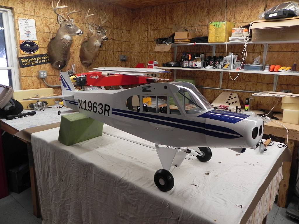

Here are a few pics of mine. There is a large thread on this model in the ARF forum.
Mine is electric powered... I sold my 1/4 scale H9 J3 and took all of the equipment out and installed it in the PA-18. I also added the interior kit.
Now all I have to do is wait for our lake to thaw!
Curt

looks Good. im kinda poking around at mine, not in any big hurry. Ive got a giant stick going on as well, and Im not a good multi tasker. Ive got the DLE 35 installed and its on floats but thats as far as I've gotten
