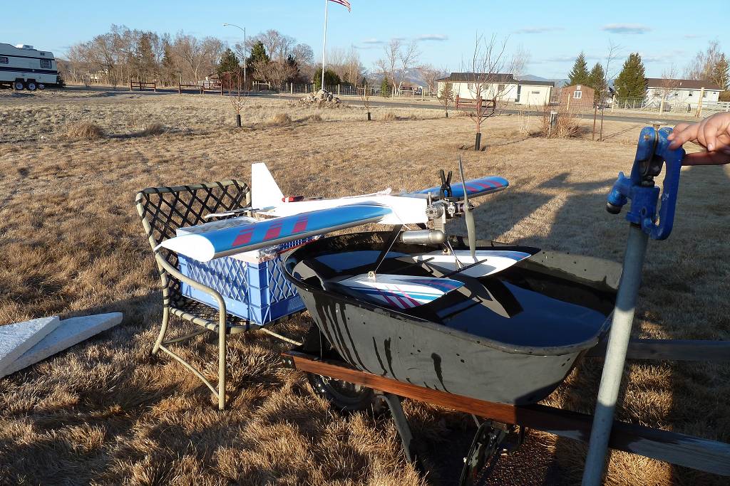

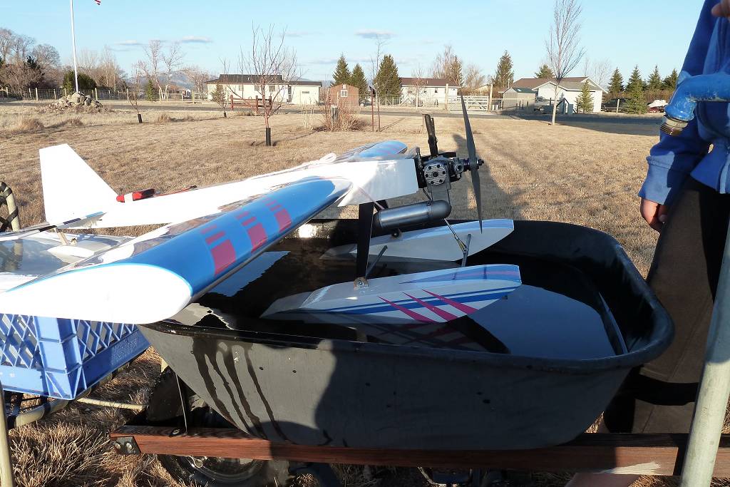

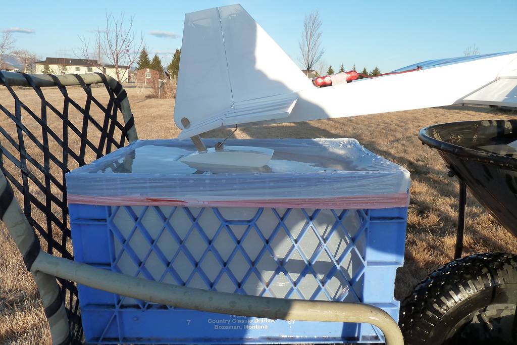

Float test complete. Radio gear is in and battery is strapped on to balance. It looks like it is going to be a bit tail heavy. I have several options, make a hatch in the rear to hold the battery, mount the servos in the tail on the fuse, or add a bunch of lead to the tail. I know I will have to worry about waterlogging the servos if they are on the back unless I can waterproof them. The battery in the tail will require a little reinforcement back there. And then the lead, well, I just don't like to ever do that.
Well, here are the float test pictures. Any constructive criticism I can get will help me out in the long run so have at it. I think there is plenty of floatation in the tail and main floats. The water level in the rear might have been just a little lower than the front float wheel barrow water so the tail will actually sit a little higher in the water and the front floats will have just slightly less angle of attack in the water.

First question is,, is this going to be water only or convert back to land some times?
If it's going to convert back to land, add the weight to the floats. A little weight all the way back on the float will make a big difference vs. the battery half way back like that
If water only, then relocate equipment for sure to save weight,, Hitec has a line of waterproof servos now.
Good luck

Thats a good question Scale only 4 me. I attached the floats so that it would convert to wheels in a matter of minutes, but I don't really need another land plane at this time so it might just stay floats only. I can pop the floats off put wheels on and then place the battery in the right location and then put the floats back on and rebalance. Looking at all the other uproar 40s it looks like they all come out nose heavy with a 46 engine needing sometimes 3 oz or more right in the tail to balance.

Well I bolted up the engine and balanced the plane again last night and now it looks like even with a 5 cell battery all the way in the rear, I will still need the equivelent weight of one and a half AA cells on the rear tail float to balance. I cut open the bottom of the fuse and had a look last night and I think I can mount the servos inside and use the current control rod tubes for the outputs. This would protect the servos from water. The battery pack in the rear with the servos should get me really close to balance.
