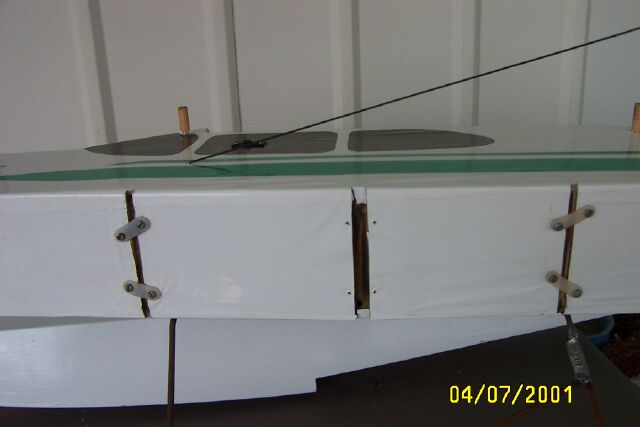

RE: First timer needs help-floats on lt40arf
This is how I set my wife's LT-40 up. I bent the 5/32" wires myself. I should have attached the cross brace high on the front wire and low on the rear wire. But it works.....Seaplane
Here's another pic of the underside of the fuselage. I cut 2 slots similar to the main gear slot, then epoxied in 2 hard wood blocks inside the fuse centered over the slots. I use nylon straps to hold the wires in the slots.....Seaplane
