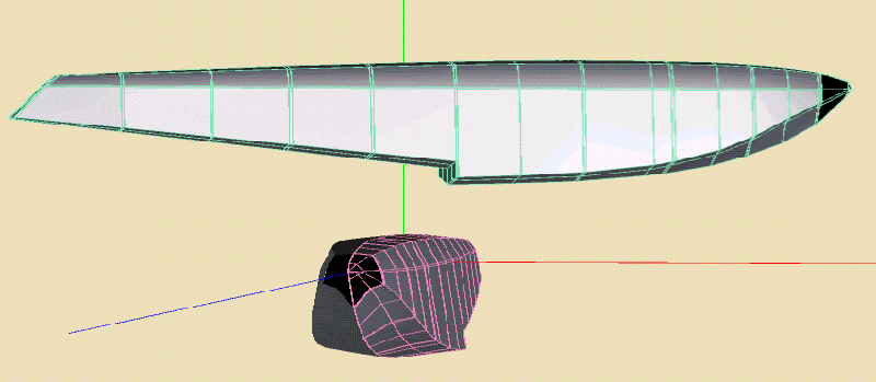

I'm trying to design a set of floats for the aircraft that i'm building and would like any comments or suggestions regarding the floats pictured before i commit to building.
Any foreseeable handling problems on the water? The floats have a small deep v section running down the middle of the forward section with a
step on either side to hopefully direct spray outward instead of upward onto the plane. The aft section has a regualr v profile.

goose:
The flat section in the front does not have to be that wide. 1/4" will do. Also the very deep "V" in the front will act like a keel and make the airplane harder to steer on the water. If you use the same overall profile but make the "V" shallower and the flat section narrower, your floats will ride softer and steer better without loosing any floatation or spray protection.

Default RE: Float design
I tend to agree with JRF.
The sharp keel at the nose might grab a wave if you have any crab angle going. It would make for a short, splashy landing. I suspect you might also find that the step is a little small, and you could have trouble breaking suction. Also with the changing V-angle all along the bottom, it'll be a lot more difficult to build these than it needs to be. But they DO look really cool.
You >>Could<< make the v-bottom angle constant. For arguement, let's say 20 degrees. Then glue some triangle stock at the outside edge as spray deflectors/chines. It would look almost the same when finished, but be easier to build.
That was my concern, the sharp keel making it hard to turn when taxing or a float really grabing especially when one float is out of the water and one is still in.
I was hoping the only thing it would do was make the plane a little harder to turn. I wonder if i was just to sand and round off the keel. These will be going on an original unproven
airplane design. I definetly don't want the floats to be causing me alot of grief before i know the thing flys.
I remember from high school something called "The Scientific Method". Only change one variable at a time.
If you have an unproven plane, it would be prudent to use a proven float design.
I usually post a link to Randy Linderman's website when somebody asks about float design, but I already gave you that.
Here's another link with Ed Westwood's article from Model Airplane News. Ed Westwood also designed the BEAST from RnZ models, and RnZ also sells John Sullivan floats which are widely regarded as good. Round on top, flat bottom.
Thanks for the replys, that was alot of good information. I've decided to keep the same shape looking fom the side but alter the bottom to mostly a very shallow v with it deepening a little near the tip.
Much better.
If the prop gets spray, you can always add spray rails.
You might want to square off the transom if you intend to mount water rudders. The Tapered transom LOOKS slick, but it's hard to fab a clean water rudder mount that way.
I'll keep the transom angled because I rarely ever use water rudders on my float planes anyways and i think the angled transom really looks good on the plane.

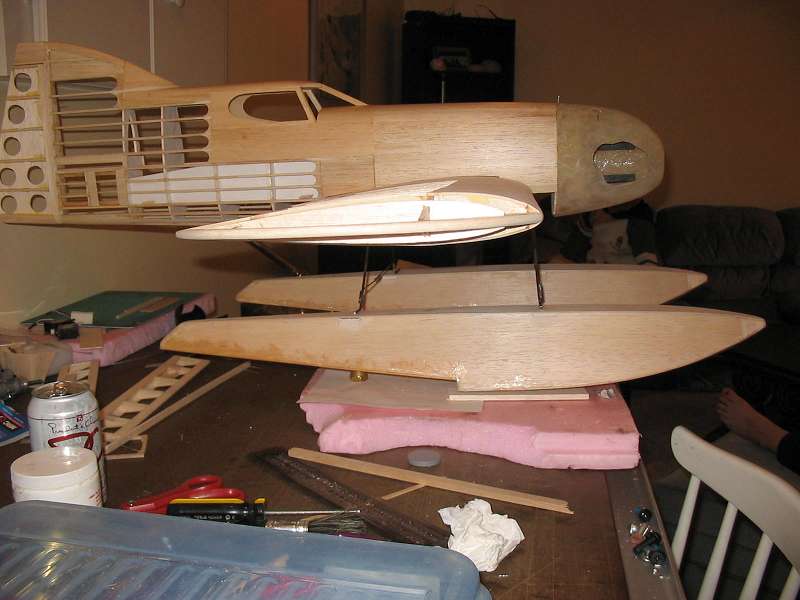

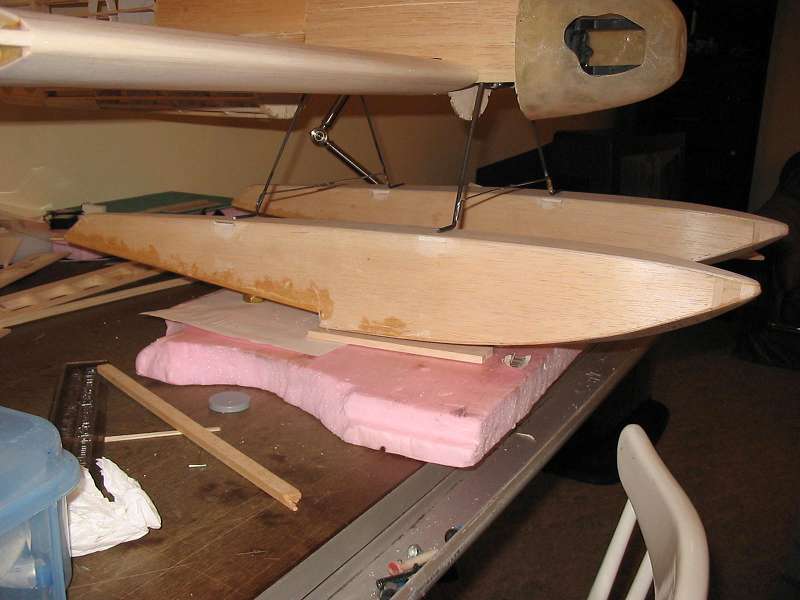

Here's some pics of the almost finished floats that were the reason i started this thread. I kept the angled transom. i just finished glassing the bottoms today. The top and sides are next.
ID:	113602   Click image for larger version
