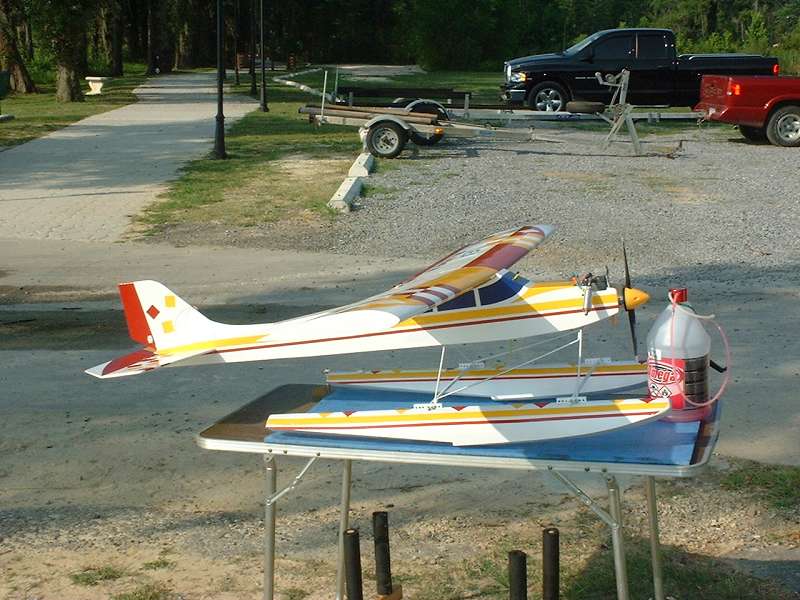

HI! I recently installed 33'' SF floats on my nexstar and cannot break water tension. I balanced the plane, reinstalled the stock extension for more lift and have tried different props. It is going fast enough that it should lift and I am afraid to go much faster as it's hard to control. The nexstar book shows me how to cut the airlerons and make flaps-would that help? I called Hobbico and they recommended a .61 engine bigger prop and then the advice from all of you as they have not had experience with floats. Thank you for any help you might have. JR.

The wing needs to be making some lift when its running along the top of the water. The floats are rigged so that the wing can rotate enough to get takeoff angle of attack. In the past I have always recommended people rig their planes so that the wing is 3-5 degrees positive relative to the tops of the floats. Not all floats are flat on top. But, if you set the plane on a tabletop, sitting on the floats, the chordline of the wing should be level-parallel to the planing surface of the float. The step is normally a little behind the balance point of the plane.

Here's what Jim is talking about. Notice how the floats are slightly nose down compared to the plane. This is a World Models Sky Raider Mach I trainer, about the same size as the Nextstar, powered by a Magnum .52 4-stroke.

Thanks for the info. My step is about one and a half inches in front of my cg, and the nose of my plane is down 3/16 of an inch in the front of the wing as compared to the back. I'm concerned that my floats might be a bit undersized, but it planes good. They are 33" long and 4 1/2" wide. They look a 1/4 smaller in relation to the plane than the floats do on all the other planes I've seen. Do you feel that my O.S. .46 is sufficient engine and would they addition of flaps help me with the short ponds I use. THANK YOU! J.R>

The 46 is plenty of power, and the floats are big enough. Just block up the front of the airplane so that the bottom of the wing is level with the top of the floats and you should have no trouble getting off the water. If that doesn't work, move the floats back an inch and try again.
