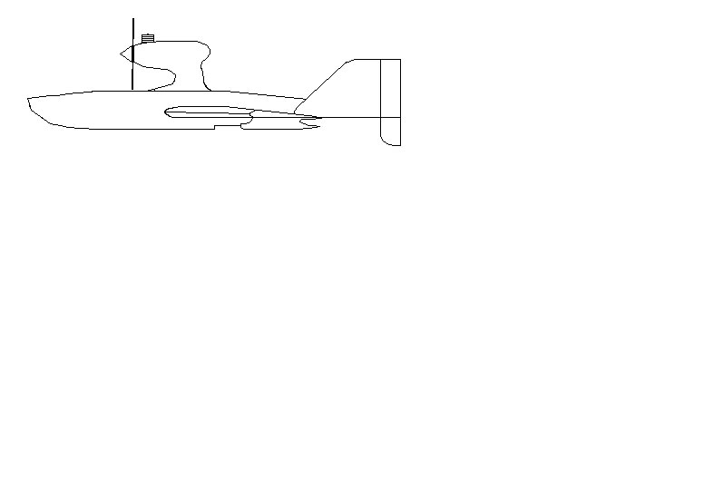

I put floats on a conventional plane. Due to time and weather restrictions I still haven't had a chance to test it. Now I think I want a dedicated float plane. I have a shrike sitting here that I'm pretty bored with. I thought about turning it into a seaplane. The picture give you a pretty good idea what I have in mind. I might also put floats on the wingtips if they're needed. I'm wondering how raising the engine will affect the flight characteristics. If the line of thrust is moved up, would I need to angle the engine up or down to compensate? I figured you guys with mariner-type planes would have some first-hand knowledge. The only other obstacles I have - other than moving the engine - is 1. the aileron servos are on the bottom of the wing. I'll at least need to move them to the top of the wing and maybe to the inside of the fuse. 2. I'll probably have some weight and balance issuses. I don't know if I can move enough stuff forward to compensate for the engine. Well let me know what you think. I'll probably just buy a kit or ARF, but it's just a thought I had "floating" around. One more question, for those of you that have an engine in a pod, is the fuel tank in the pod too? What about the throttle servo?

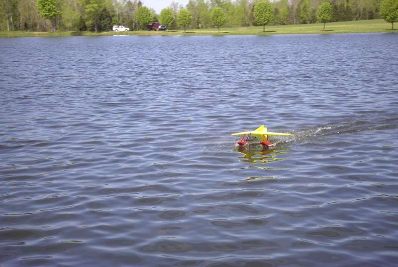

Hey, I'm not sure who's this is, but it's a shrike on normal floats.. I'm sure they will reply soon! Looks like moving the engine isn't really required.

It's not a shrike. I recently e-mailed the owner about the plane and it's a Jerry Smith Outlaw delta on floats, modified with a water rudder.
I see no reason why a Sea Shrike wouldn't work. You would have to be careful of the CG since planes with a pod mounted engine like the Northstar tend to build tail heavy. Adding 2 floats and a little more fin area would be an easier way to go, but a flying boat Shrike would be an excellent project.

I think you are correct about CG issues. I think it would be terribly tail heavy as the engine was designed to be up front. You could counter this by extending the nose and stuffing all the radio equipment as far forward as possible. If you look at water planes similar to your idea, like the Northstar and Arrow, you will notice that they have very long noses.

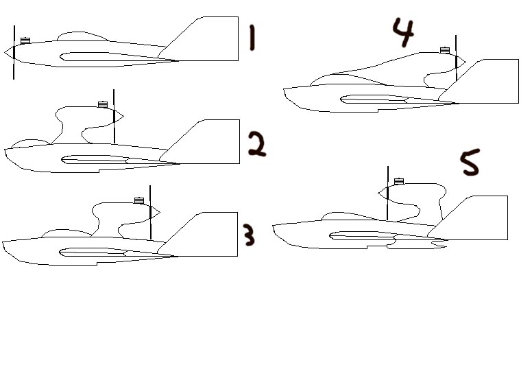

I did some tinkering in paint to get an idea of how this will work. The pictures are scale-ish. I took measurement off my shrike so its pretty close. The prop represents a 4" radius. #5 was my origional idea, but I decided to go with a pusher for CG reasons. #2 would probably be the easiest to balance, but its pretty ugly. I think #3 is a pretty good compromise.

Yep, three looks good to me too, remember that the fueltank will be forward to help with the CG..... I think the cylinder to prop distance will be farther than your pics...

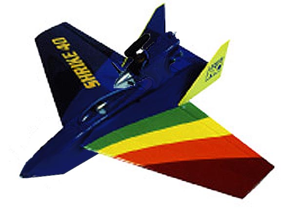

Here's my new design. I was planning on building the pontoon out of foam a fiberglass. This doesn't work well for mounting servos, but it'll be a good place for the battery and reciever. In this design, the engine is only moved back slightly and the battery and reciever mounted at the front should counteract that. I went with the tractor design so I could use a smaller diameter 3-blade prop.
