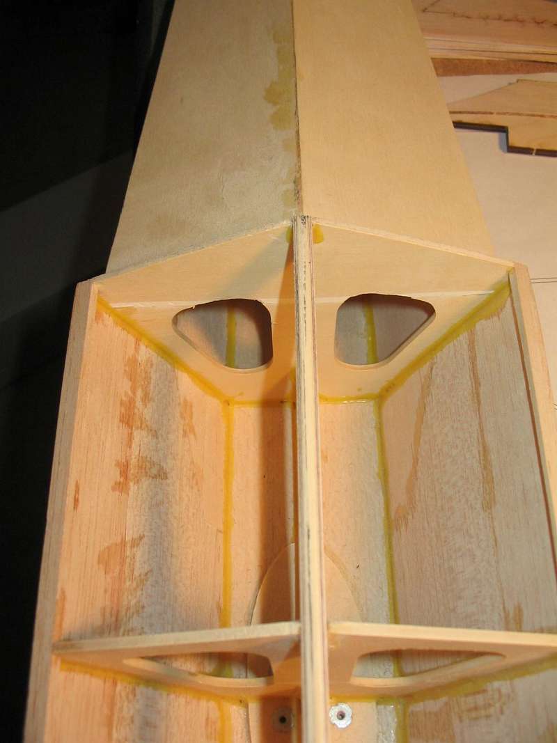

I have 1 float that is almost built (still see the inside) that I can take pictures of if you want...let me know

Yes! please post a picture of your float! that would help a lot especially the tip of the bow, the step, and the water rudder mount on the stern. I have one float framed up but dont know where the mount for the step (that piece that sorta looks like a long "W") goes or how the rudder mount lines up to the last former I was gonna go work on it after i checked here but now i will wait till you post any pictures. Thanks a lot, I will post here again if I run into any more hang ups.

I tried taking a picture of a page from the instruction booklet and it works really well....give me your email address and I can send the whole thing if you want.

Thanks a million!!! It has been a pain building with no plans or instructions! Your floats look great! Let me know if you didnt get my email

Manual photographed and sent to your email address. Turned out really well, think you will be pleased.

Mike,
Thanks so much for taking the time to send those pics, helped out a great deal. I was at a point where i didnt know what to do next and where a few parts went. Now I can get them finished in no time! They are a christmas gift for a friend.
