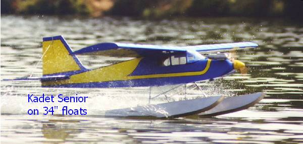

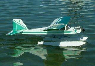

Default RE: sea master question
The Kadet LT-40 also makes a great float plane. In fact, any of the Kadets on floats are great. Here's a pic of my wife's LT-40 and my brother's Senior both on 34" floats.
ID:	208944   Click image for larger version
