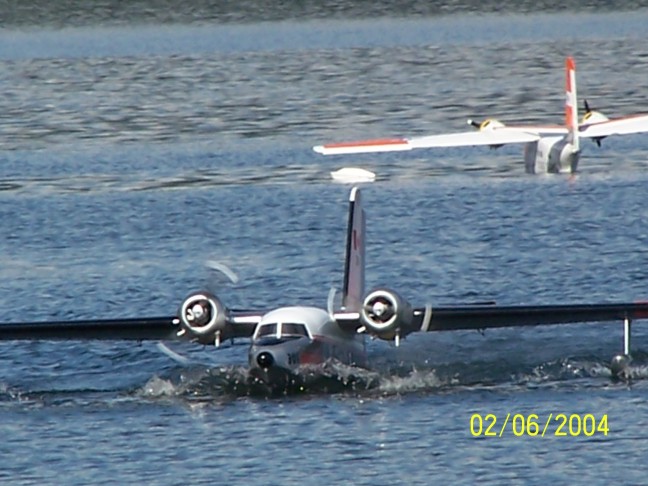

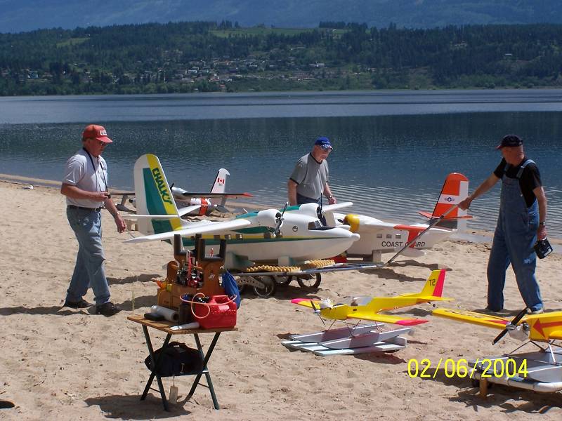

At Lake Shuswap in B.C., a pair of 14 ft. wingspan Grumman Albatrosses, with their long hulls, took of majestically. Ihave a film of them flying , which I may post on YouTube some day. The PBY had a relatively long hull, but I cringed when, on TV, Jacque Coustou's son took off in their modified PBY Catalina after much porpoising. He eventually killed himself in that aircraft.
