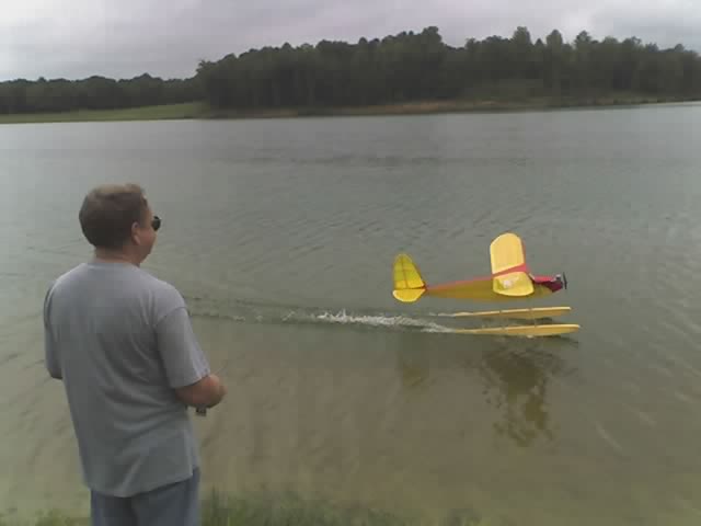

Good idea, I have four A-Texaco kits, already started building a 54" Quaker Flash and a Cleveland Cloudster 55"
I checked the fuselage lengths and without rudders, the QF is 32" and the CC is about 27."
If I remember my basic float plane layout, the floats should be about 75% of the fuselage length so that means I will need a minimum of 24" floats for the QF and roughly 21" for the CC.
As luck would have it, I picked up a nice pair of GWS edo style floats for ten bucks in a local hobby shop that have foam tops and a vacuum-formed plastic bottom half, They are 21".

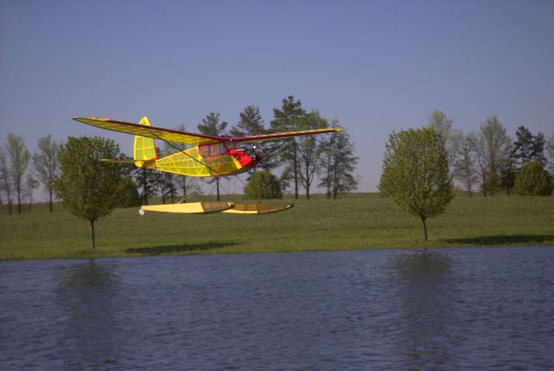

I have a strong love of Quakers so I would say get a set of floats on the Flash... 21" sounds good. My calculations say around 22" but 21" is very close. The problem with a lightly loaded airplane like this is that most floats are too bouant. Each float should dispace the weight of the aircraft. In other words if you have a 2 pound plane each float should hold up 2 pounds before sinking. With a plane like this most floats that are the right length are too wide (and heavy) because they are designed for a normal airplane. When I built mine they ended up very narrow and look elegant like the Quaker. They also ended up very light. I built mine up from balsa and ply and used .5 fiberglass to seal them. This is on a 105" Quaker, almost exactly twice the size of the flash, and my floats are 50" long. I would build them a couple of inches shorter if I was to build another set. I've built many out of foam and fiberglassed them and that's what I would recommend for you.

I agree fully with evan-RCU about normal floats being too bulky for light planes like the old timers. I've built over 100 pairs of foam core floats and just this last week I built my first set of "slim" floats for the lighter planes. These are 42" long and would be for planes like Kadet Seniors, Telemasters, and other light planes. I think I'll do other sizes as well........Seaplane
