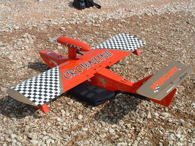

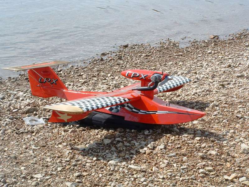

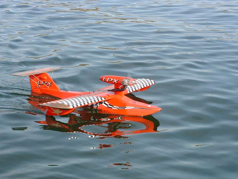

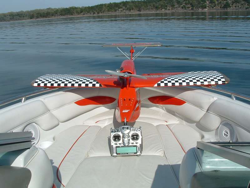

Here are so more pic's of the Neptune that I recovered. Hope you enjoy them. These were taken in March at Table Rock Lake MO.

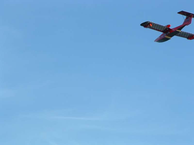

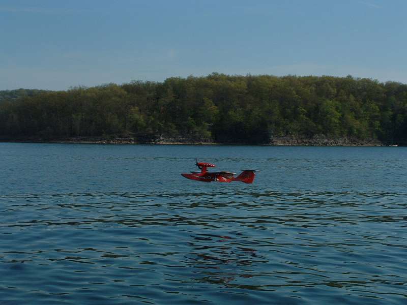

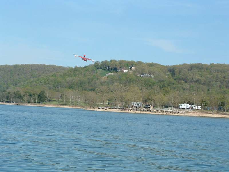

Some air pic's.

Looks great. Nice colors and graphics. It might could use some false cabin windows in black, white or light blue.

Thanks Ed. I'm not quite finnished with all the graphics yet. I will be adding more later. Can you see the side force generator below the engine pod?

I saw the side force generators in your other photos. How do they work?

Your boat looks very nice, with leathers, audio, and so on... Do you have a pix ?? This is the best way to fly seaplanes !!

Ed........The side force gen just adds more side area to the plane at the C.G. You've seen the small foamy 3D air craft like the tenser and others. They can fly knife edge for ever. Same concept, but mine has a control surface to make it even more effective. It moves opposite the rudder. If the rudder moves the tail to the left, the SFG will move the nose to the right. Both work together making rudder comands more effective. It also helps hold knife edge with less rudder deflection or yaw. I read about these in an issue of 3D Flyer magazine a few months ago and thought it was cool.
Strykaas.......Thanks! We love our boat. It's a Crownline 202. 5 liter Merc 20ft. It will do mid 40's loaded with coolers and such. We go to Table Rock lake most of the time. I wanted an air plane to play with on the lake and the Neptune fit the requirements just right. Even with the boat at full throttle, the Neptune only needs about 1/4 throttle to keep up. That's some fun stuff flying the plane down the lake right next to the boat. It's really cool to see the plane that close in action. Here's a picture of the boat.
