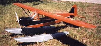

All you float guys out there I could use some help. Im building a LT 25 and I want to put some good looking floats on it. What are good floats and how big do they need to be. The plane is 50.5 inches long and weighs 4 to 4.5 lbs.
Any help would be great.
Alan
Alan

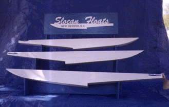

Try 36 inch Slocan Floats . You can get more info by e.mailing [email protected] [img][/img]

Floats should be 75-80% of the length of your fuselage. Most "experts" suggest locating the step a little behind the balance point, but there are those who are proponents for putting the step under the balance point or a little in front, even. Just get them both the same and it will probably work. The nose of the floats should be a little (20% of the prop diameter) in front of the prop. If nothing else, it helps keep you from breaking the prop when you taxi up to the dock. There is also added resistance to nosing over. If you have the right size floats, and you put the step in the right place, the nose length will take care of itself.
With the tops of the floats level, on a Kadet, the bottom of the wing should also be level to a couple of degrees positive i.e.: Nose-up. Do NOT raise the nose of the floats in some misguided attempt to make them jump up on top of the water faster.
Mount your floats parallel to the centerline of the plane. Some advocate a little toe-in but I have never found it necessary. Wheels, yes. Floats, no.
