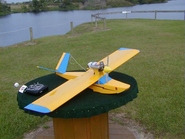

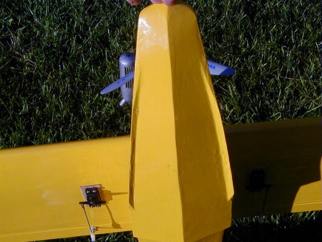

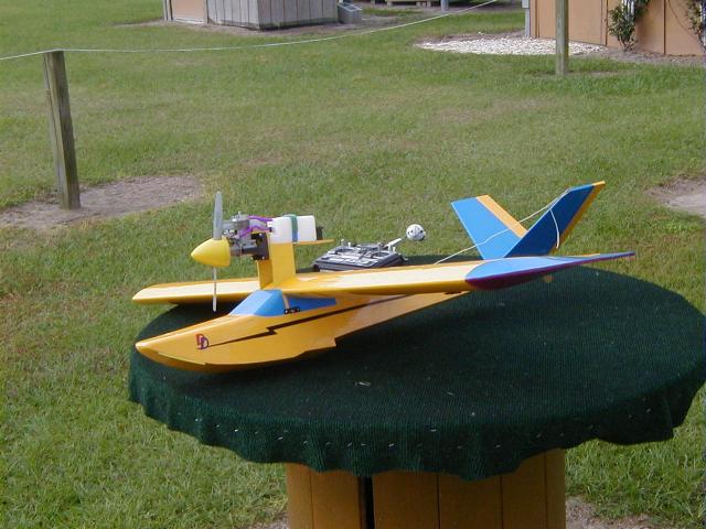

I just designed my own seaplane, and after initially having a flat-bottom hull I changed to a v-bottom hull. As my Dad used to like to say for emphasis, "It is lots more betterer!"
Pic attached. I have extended the spray rails all the way to the nose, and it made a big difference.
