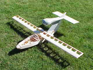

I am the Seawind guy!
Flyfalcons, good to see you!
Wingwiz,
I built two electric Seawinds from Anton Eisels plan that was in S&E modeller April 2000. The plane is not difficult to build but it does have some tip stalling problems that the designer told me about (after the crashes) and has told me personally that a new design will be in the works in the near future.
As far as I know, I am the only one in the U.S. who has botherd to build one, let alone two from scratch. I flew both my planes from a hand toss and plane #2 flew flawlessly. Plane #1 crashed on it's maiden from lack of power and a severe tip stall after rotation.
Here are some pictures of my Seawind. If you would like more info, email me directly at [email protected].
Perry

Rubberman98, Your not the only one in the U.S. "who has botherd to build one, let alone from scratch." I designed, drew, and scrach built a .46 powered 62" model. I designed out the bad stall characteristics. Simple realy, Just a mater of the right washout angle along with angle of attack. Flys well.
