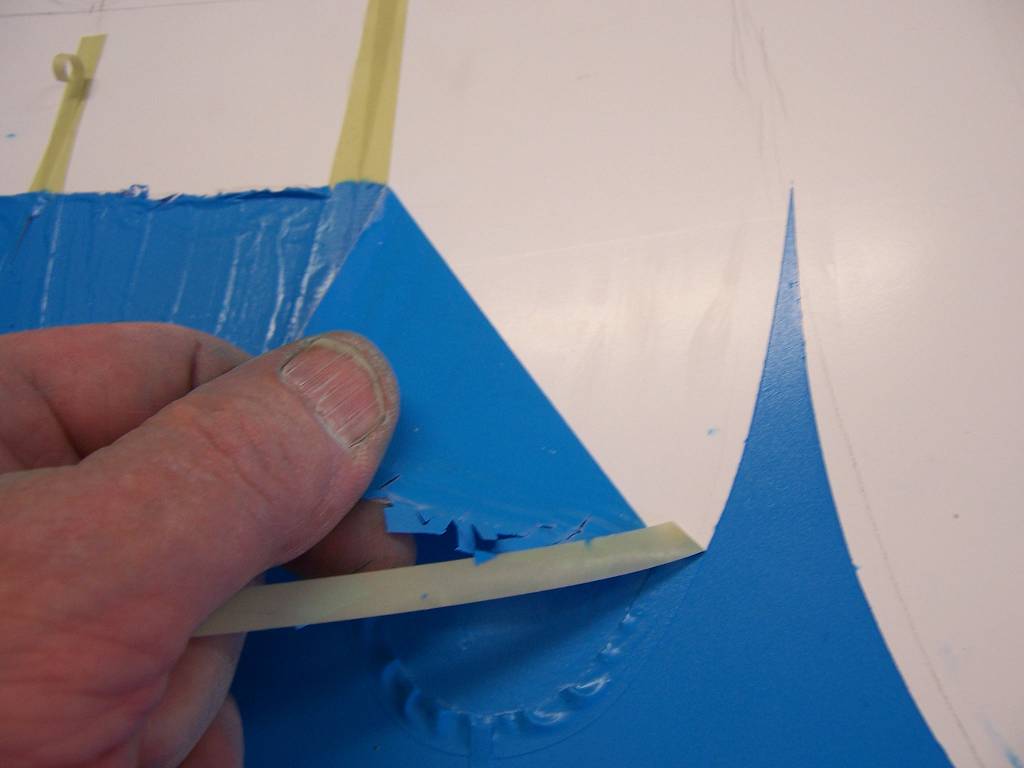

Got first color on today - pics show paint strippable mask and fineline tape being peeled back and general views of overall effect - did get some bleed thru especially around tighter curves as plastic fineline tape puckered trying to resort to original tension - but hey! this is not easy, it's time consuming and fiddly - oh well, when paint hardens off I'll go over the bleed thrus with a small brush and paint them out.

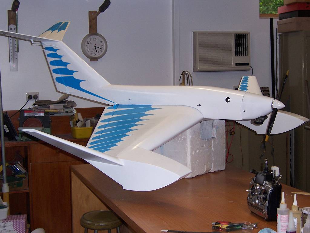

Here is the 'first' color version ready to fly for this weekends event at Lake Hume, Albury, Australia - weather permitting - the forecast is not overly good! - got the blue paint on and have run out of time for the other two colors - but at least it's flyable for this event.
Pics show general views plus the hand drawn outlines for the next colors which I'll leave on - saves doing them again - I think it looks ok as is - however I will do the other colors and report later.

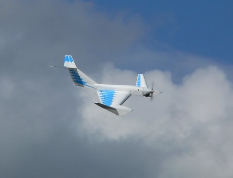

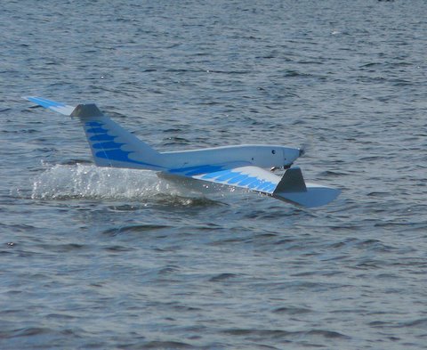

Here are some pics of Aquabird committing aviation w/e Oct 17-2010 - sorry didn't get around to movie making - next time when it's got all it's colors.

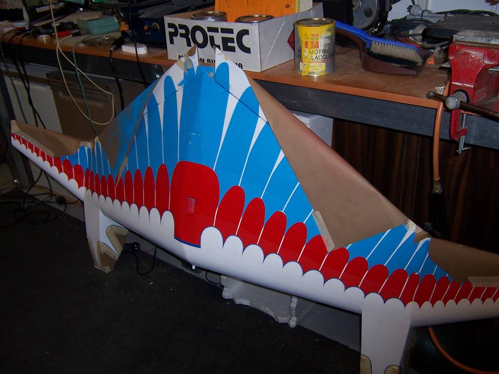

Finally got around to adding more colorlast week - weather for next few days is wet and windy so no painting the next color until ??? - pics show red color applied and masking for next yellow -Albury float fly event coming up end of month so I wanted my Aquabird to look a bit 'prettier' - cheers - maxiemac

Well, I didn't think it was going to happen so soon - the weather was not so goodthis Sundaybut the clouds parted long enough forthe sunto beout, the air temperature went up a bit, the plane was masked and ready for paintso I thought, it's now or not until 2 days before the next float fly soI went for it and got the third color on - at least the next 2 weeks will allow the acrylic paint to harden off before the paint 'hits the water'.
I'm toying with the idea of a 4th color applied with an air brush. However I've not used an air brush before, so I will need to practice, and I'm thinking of using a 'darkish' green color (my most least favorite color) and infill between the 'feathers' just for more color balance - I like Laddies yellow, red, green color scheme but I just don't like the color green in any quantity - it's for grass, trees etc - but that's just me, maybe a teal color as a compromise!!! - we'll see.
