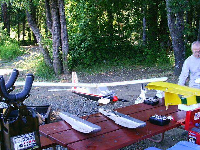

Last year our club put together a SIG Kadet LT-40 ARF with an OS 46AX and Great Planes Fiberglass ARF Sport Floats. We use this plane to train the area kids how to fly off a local lake and also use it to give kids a flight during our float fly, which by the way, is July 14-16 at Lake Selmac, OR.
It's a big easy flying plane and since we used ARF stuff it can be assembled very quickly. The kids think it's great. It flys slow, handles great and even though it's got a 70" wingspan a .46 will fly it just fine. We'll fly it all 3 days on less than a gallon of fuel.
