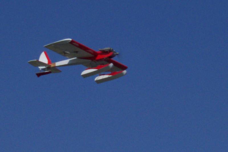

My buddy and builder, Flaps Laffert and I were brainstorming about designs or configurations we hadn't tried on floats. Has anyone tried any of these and can give us advice or point us in the right direction. We do have all the old articles on float flying.
I do have a TwinStar on floats so we've done a twin on floats. Flies the same, really.

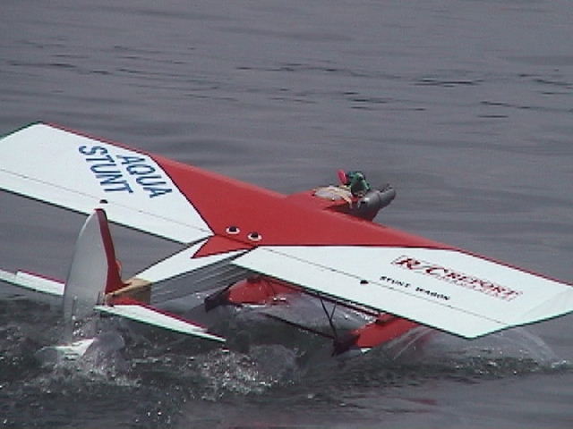

I also tried some "tri-gear" or tail dragger floats. I had these on an old Stuntwagon. I never did work with it long enough to get down how to best take off and land. I recently dragged it out and did a refurb. I wedged in a larger tank, it originally had a 4 ouncer for a .46.
1. Big single float. (Not a flying boat-they are too easy.) I have read that float length is equal to fuselage length. Step is at 40% of MAC or just behind the CG. Anyone have experience with these?
2. Canard on floats. We have a tractor canard and a pusher canard. The CG is way back in the middle of the fuselage compared to a normal plane. Would we use the same size for twin floats, but put the step back in relation to the CG? I guess so, but this would leave the rear section of the float pretty short. Any ideas?
3. Flying wing on floats. These guys are short and the floats may be longer than the fuselage. I have a Beast kit, but haven't started it.
4. Delta on floats. I have seen photos of a couple. They may work out OK. They are longer than a flying wing and usually have a low wing loading.
Who has experience with any of these type planes on floats? We are open to ideas and looking for a project.

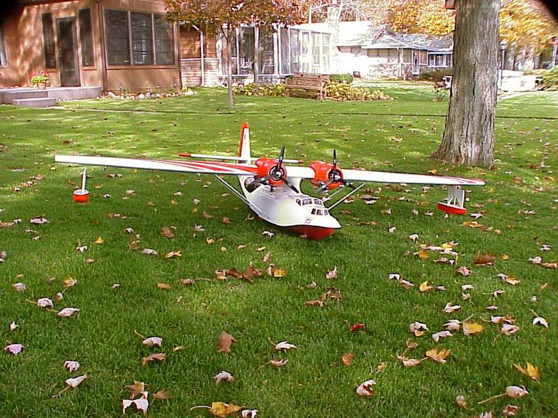

My buddy and I are on our 14th seaplane. That one was the TwinStar on floats. We just wanted to try something different. We never under power anything and, you're correct, seaplanes do like more power. Besides the water, you have the extra weight and drag of the floats.

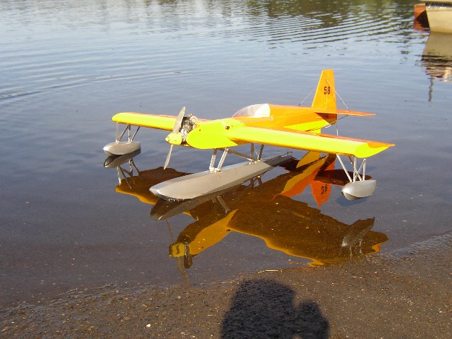

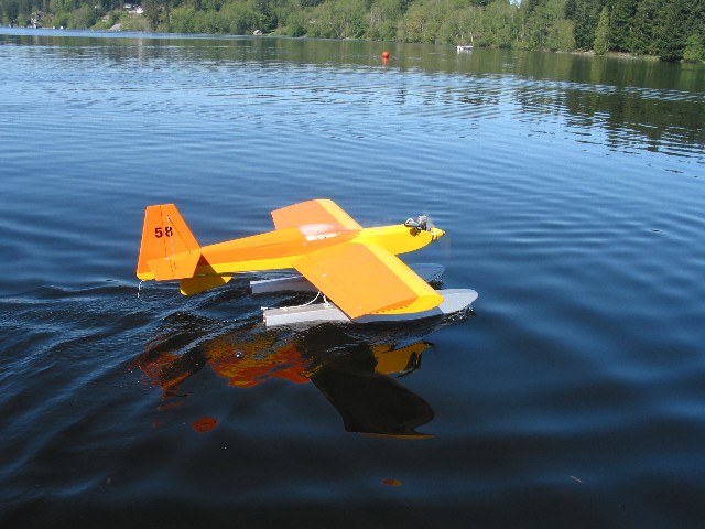

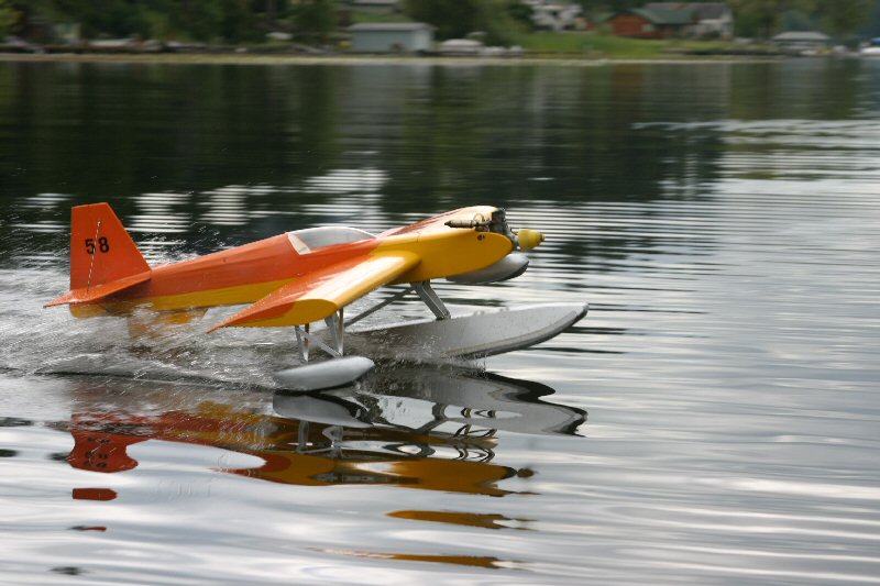

Ed, Here are a couple of pics of the same Somethin Extra on two different float setups. I flew it for five seasons on a pair of .40 size Great Planes Sport Floats. Best float flyer I ever had. Finally tore one of the floats off (dumb thumbs) and it sat for a year. I missed it a lot and remembered that it always sat pretty high in the water. Insterad of fixing the beat up float, I remounted the good one in the center and carved some tip floats. I flew it most of this summer and got another couple of dozen flights and another hundred or so landings.
The single main float rig worked OK but it was some different. The all up weight was about a half pound less but the water handling needed new technique. With the V bottom main float and the tip float bottoms set a half inch above the surface of the water with the A/C static, one or the other tip float would drag in the water. During the takeoff run, due to a long ingrained bad habit, I was using only rudder for laterl/directional control until liftoff. These tip dragging takeoffs were really ugly. Of course the answer was to get on the ailerons right away to fly the wings level as soon as possible. Even old dog's can learn new tricks.

Ed, on the Somethin'Extra/Great Planes .40 single float combination, the protrusion of the float was dictated by the shape of the pieces. with the step located 1/2 inch aft of the spar (CG), the nose of the float ended up 4 inches in front of the prop disc. Another aspect of the single float rigging was to shorten up the float struts so that the 11 inch prop cleared the top of the float by only an inch. I reasoned that lowering the thrust line would minimize the pitch down moment on throttle application. Splash rails on both fwd chines have made spray through the prop not much of a problem. In rough water with higher swells, the two float rig with the floats 2 inches below the prop disc did work a bit better. The single float setup works very well on calm to 3 or 4 inch wave water.
I had thought some about a retractable float machine also, and have some concern over extra weight and CG shift during retraction. Will be real interested to hear how your experiment works out.

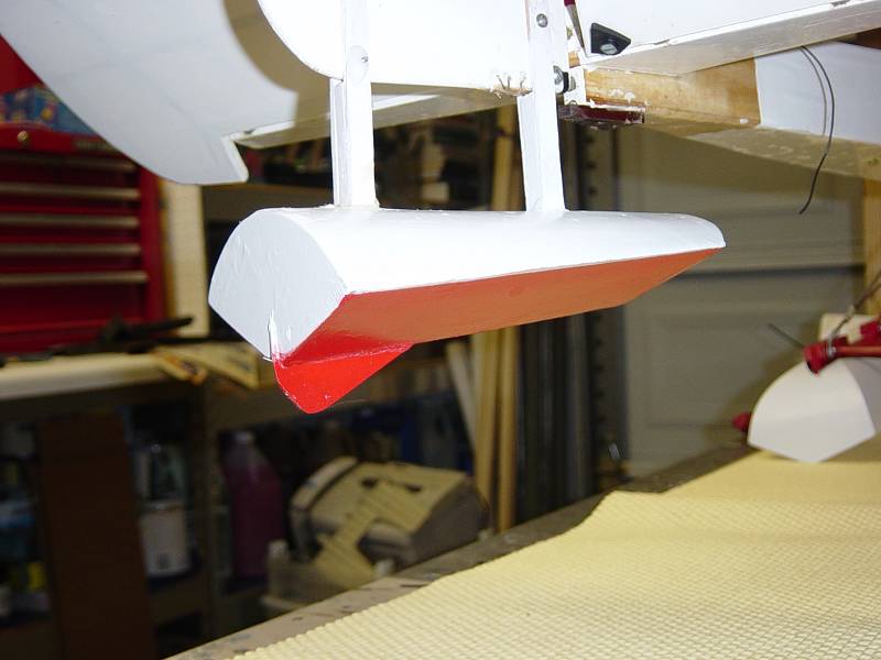

We were actually talking about a Somethin' Extra as the basis for our next plane if this one works out. I feel you need a high wing or plug in wings so you don't have to go between the float and the fuselage to get the wing on as you would for a low wing plane.
The modified Heckler isn't going to be pretty. The float is a wide, built up float about 2 inches wider than the Heckler fuselage. The Robart retracts are being mounted on hardwood rails glued to the underside of the fuselage. Nothing is going to be faired in or anything cosmetic. This is just a "house mouse" or working demo. The fixed tip floats are going to be screwed to the flat tips.
If this works, we would design a new fuselage and float, or buy a big float cut to our specs and widen the fuselage to match it so that when the float is retracted, it looks integrated with the fuselage. I figure we could use the SE wing and tail and make the fuselage 5" or so wide.
We have looked at mechanical retracts for the tips, but given the direction from where they actuate, the retract servo would have to be out next to the wing tip. It might be easier to just get another Robart set for the tips. It also might be necessary to jump up to .61 or .91 size to carry the extra weight. It ain't going to be a lightweight 3D plane, but float planes are heavy anyway.

The plug in wings do make a relatively compact transportation package. See SE in the back of the Mini-Cooper.
With the center of the flotation volume of the float well forward of the aircraft CG, you can see the thing floats quite nose high when static.
Early in the T/O run (still haven't got the low tip float out of the water) spray isn't a factor.
Attitude right at touchdown. Ah that was fun.
After these pix were taken I did make a 3/8 inch longer rear float strut to reduce the wing incidence relative to the main float and that did seem a bit better.
