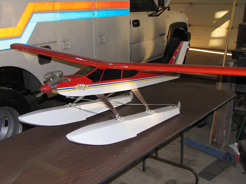

I am putting my Tower Trainer 60 on my Goldberg Superfloats. I am using two dural landing gears attached to the floats on the factory original location. I noticed the fuse bottom is 1/8" ply and the landing gear lines up with the main bulkheads in the fuselage, front and rear. My question is do I need to double the ply between the fuse and the aluminum gear. My guess is no, but I'm not a pro at this.........yet....haha

Only if you don't want it to break

Yep. Put in at least a 3/4" wide strip of 1/4" ply, extending all the way to the sides of the fuselage. Having the 1/4" ply reinforcement as wide as the landing gear is better. Epoxy it in, and be sure the epoxy is glommed up on the ends as well as the major face that touches the bottom.
You'll be happier if you drill it a little large and use Tee-nuts. 6-32 screws are usually about right.

Heres an alpha 40 (I think). My Tower 60 turned out nice. I located the dural gears where they needed to go. I cut the balsa sheeting from the fuse bottom exposing the rear bulkhead and plywood side edges. I built a 1/4" ply panel from 1/8" mahogony ply with blind nuts installed and epoxied it to the fuse frame flush with the bottom. Its waiting to be covered. For the front gear, i simply removed the battery/rec. tray and epoxied an 1/8" ply doubler that extends to the sides to the existing 1/8" ply bottom and installed blind nuts. If that wont hold I dont know what will.
