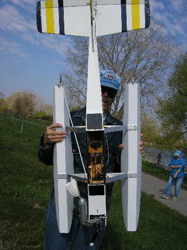

Can't help you with the size & shape of the floats but here are a few pics of an easy way to mount the floats to the plane. They are made of 1/8 x 1 aluminum purchased at Home depot and bent to the proper angles.
