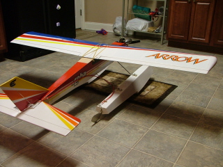

thanks jrf, i'm trying to figure out a good sport plane for floats. i have an arrow trainer with gp floats now and love it. i was looking at the kyosho calmato, wm super sports 40(narrow w.s.), tiger 2(wing monted servos?), or four * 40 etc. for a second float plane.
the tiger 2 does look like an excellent plane.

just an update: i put an offer on the tiger 2 here in classifieds and was rejected so i bought these from ultimate hobbies, free shipping
calmato sport 40 94.95
thunder tiger pro 46 84.95
this package is 70.00 less then the tiger 2 arf. w/tt pro 46 @ t.h.
here's what i been flying an alprow
thanks for all the reply's. i had to inquire about the tiger 2 before i made an offer, after i was rejected i found great prices and free shipping at ultimate hobbies.
now i have to get the floats
thanks again.
craig
