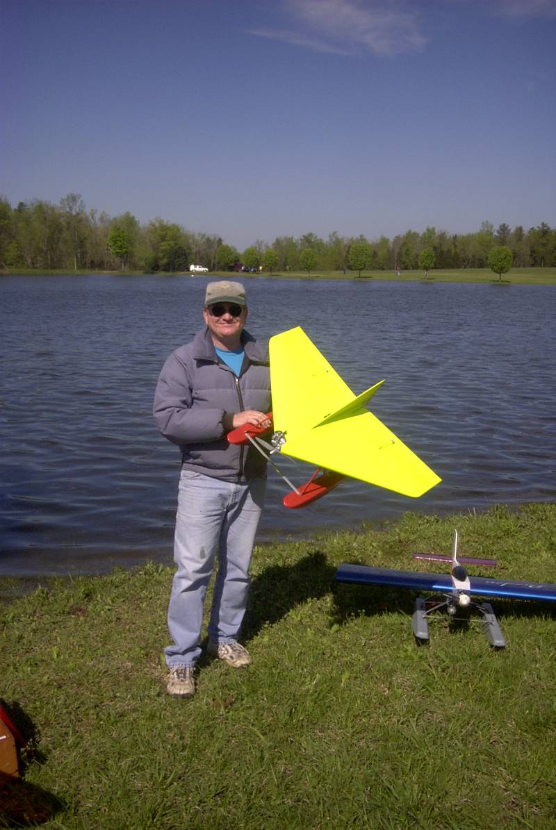

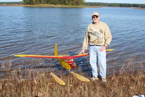

Jim, yes there are other floats that work better in some applications but the GeeBees work good, best, in certain applications. In some applications you have to design and build your own...
The Quaker needed long skinny floats to match a light big plane. The Skeeter needed short buoyant floats because of it being a delta.

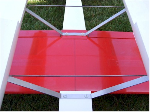

A simple way to mount the floats on a low wing. This is from http://www.pacaeromodel.com/Knockabout/Float/struts.htm
The floats swivel around the spreader bars. To remove the wing, you remove the wing bolts, tip the floats forward and lift the wing out. You can take the front strut off also, or just tip the floats back and reinsert the wing bolts to hold them on the wingless fuselage.
Jim
