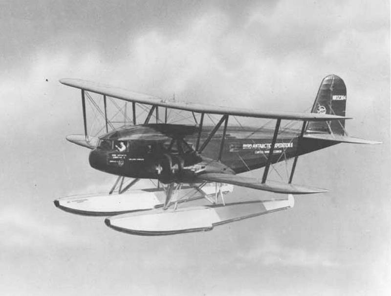

Another scale plane "in the works" that will also be fitted with floats is a Curtiss Condor:
Thanks, all...
--Bill
