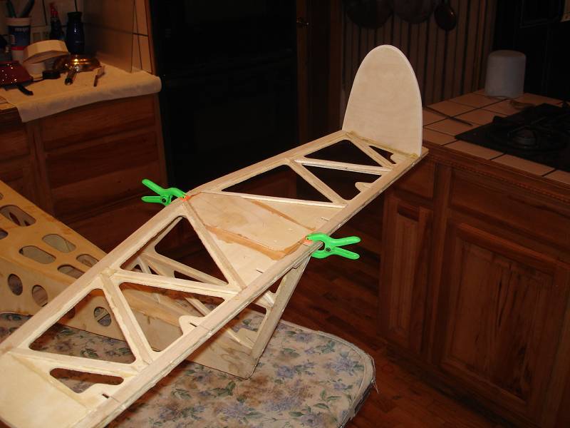

Jim
Is this kinda what you had in mind. Putting three of these across the stab.
Gene
Old 03-25-2008 | 10:11 AM
jrf
My Feedback: (551)
Posts: 2,903
Received 5 Likes on 3 Posts
From: Burbank, CA
Default RE: Help with servos
Yes, that is it. I would make one that follows the shape of the kit fin for the center. You can put the outer ones above or below the stab, or centered, whichever you think looks better and make them any shape that pleases you, just as long as the area is sufficient. (With three that size, I would think it is.)
