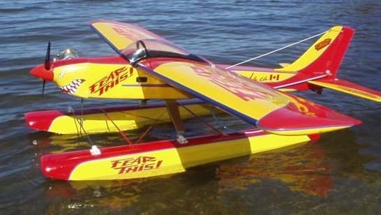

Hi Guys
So proud of my new float bird thought I would share before I turn it back into a kit.
Thats a Sig Kavilier
on a set of Balsa USA floats
GMS .47
10 oz. tank( flies about 25 min if not always running wide open)

Default Tried it out
Hi Guys
I took the kavilier out on the lake yesterday...
she flies like a dream but had some trouble on step
when it gets on step its kind of scary it wants to skid all over the place ......I've spun it around on the water a couple of times....anyone have any suggestions?

Default stability
If you can "cant" the floats out a bit it will help a lot with stability.
Picture a vee hull boat with the center section missing. This will also help to keep spray out of your prop as well.

If the toe-out doesn't work try some toe-in (like on your car). If that still doesn't work you can try a ventral fin like you see on some cubs.

Default fixed skid
Hi Guys
I spoke to one of our local float gurus and he said to try reducing the wing incidence slightly. that seemed to keep a little more float in the water. Now I can use full throttle for take offs with relativly little yaw. flys great quite aerobatic fun fun fun .

ORIGINAL: Spadhawk
Hi Guys
Hawk63
Before you make any changes, try a little up elevator trim, while on step, which will drop the rear of the floats a little. The problem you are having is caused from too much float ahead of the step in the water. You need to raise the front of the floats and lower the rear. This will allow the rear of the floats to slightly drag in the water which will stabilize the situation. While on step, you want just the step and the rear of the floats in the water. If the little bit of up trim causes the situation to settle down, but the plane tends to take off too soon, then you will need to make some changes to the float struts.
Hope this helps........Seaplane
