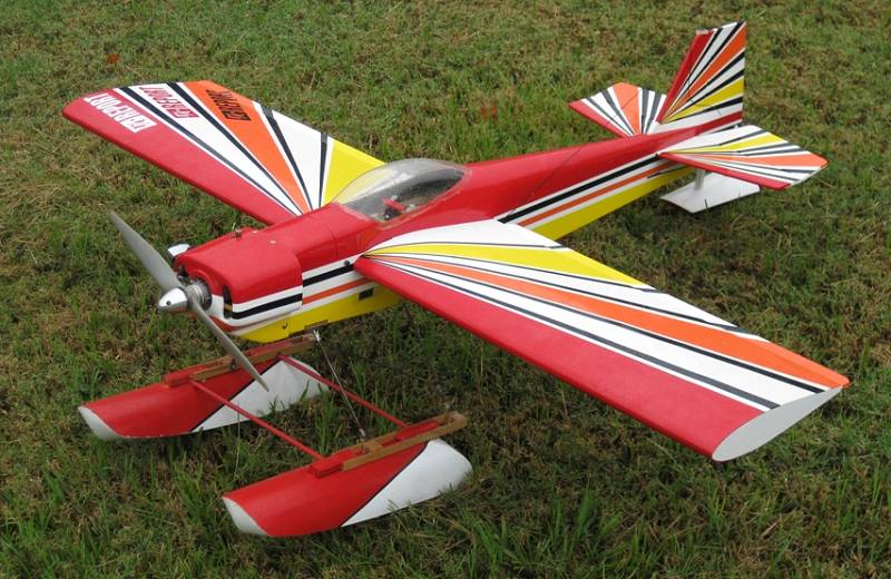

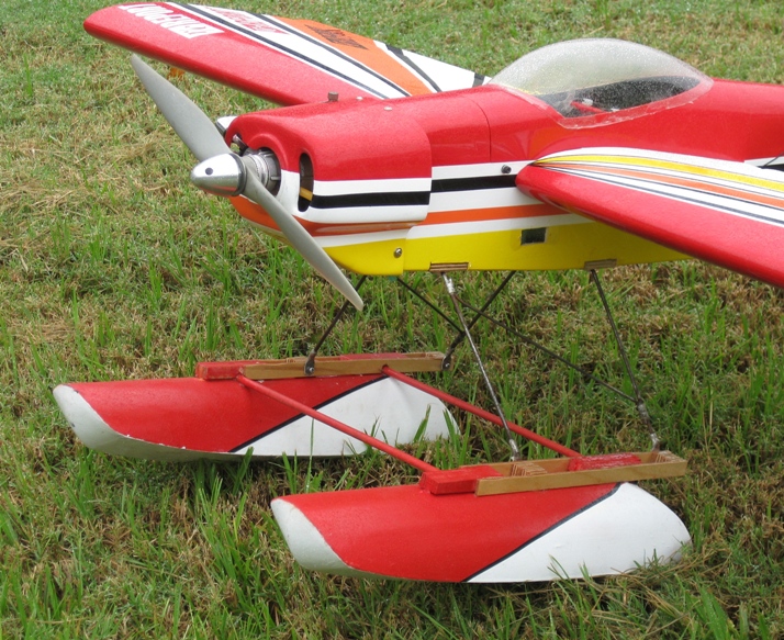

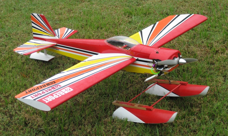

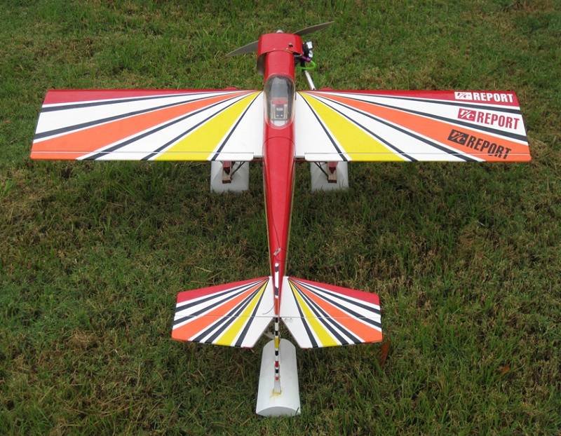

Here's my latest seaplane conversion, a Stringer 40 on old timer style, tail dragger floats. I haven't flown it yet from water, but have several flights from land. I have flown the floats on another plane that has been retired so I don't expect any problems.

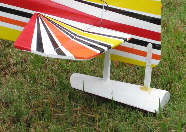

A couple of things of note about tail dragger floats:
1. The tail float acts like the water rudder. In this case, it is attached to the rudder.
2. As soon as you hit power, the tail is up and you are on the step, so to speak.
3. The original plane skimmed in very nicely, then settled back on the tail float. I have also brought it in very slow in a head wind and sat it down 3-point.
4. The rear of the main floats is in the location of the step on conventional floats.
Sea Stinger Specs:
Stinger 40 ARF
Saito .72, 13-6 prop
Front float: 15" long
Rear float 7" long
The floats were made from a pair of Niagara foam floats.

What kind of hinges do you use in the rudder? My only worry would be that the rudder hinges would be taking a beating. Any problems there?
Paul
Old 08-24-2008 | 09:40 AM
Ed_Moorman's Avatar
Posts: 4,059
From: Shalimar, FL
Default RE: Sea Stinger
Just regular CA hinges. I've had more problems with fun fly & 3D planes breaking hinges than I ever had on seaplanes. The previous plane with these floats did not have a hinge failure.
If I ever have a hinge problem, I sew the surfaces together with figure 8 hinges using Kevlar thread.

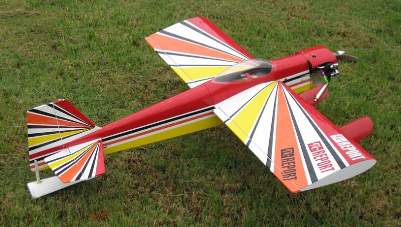

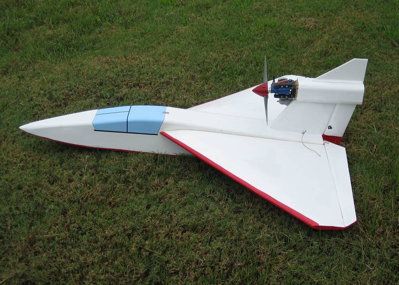

I hope to get up to the lake next weekend or the one after. Next weekend is Labor Day, so skip that one. I also have a new Arrow delta to test fly. Right now we have a bind in the right elevon that we are trying to get rid of. And it needs some trim on top. JBA .56 for power.

Figure 8 hinges date way back to my CL days in the 50s and 60s only we used carpet thread.
I get the Kevlar at a sporting goods store in the fishing section. It's Kevlar leader or something. Yellow colored. Never breaks.
I get big needles at a sewing place.
I usually drill 1/16" holes opposite to each other in the surface and the control. Go down through the surface, then up between the surface and control, then down through the control, up between and back and forth a few times. I usually hit the holes with medium CA.

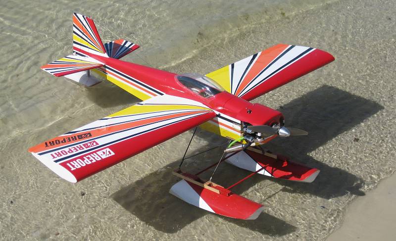

Here's a shot of the Sea Stinger on the shore of Lake Jackson in Florala, Alabama, our usual float fly place.
In my opinion, the tail dragger floats are outstanding. As soon as you add any power, the tail comes up and you are skimming along on the step. Steerng is with the air rudder. The plane lifts off easily, much more so than my Sea Roar (Uproar on conventional floats). Landings are great, too. The plane skims along on the step until it slows down. I could do touch and goes with this thing all day long. I would say they handle better and are easier to take off or land than any of my conventional floats.
I made these tail dragger floats by cutting down some conventional floats, but I am gettng ready to order some from Seaplane Supply. Their Hot Timers look good to me.
