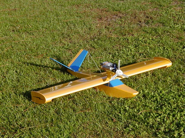

I have been designing my own seaplane. Once I'm happy with it, I will offer the plans. It's the Dover Darlin'. (Our club pond is in Dover, FL) Symmetrical airfoil, v-bottom hull with spray deflectors, and this week it has a v-tail to get the tailfins away from the water without the fragility of a T-tail. It has an OS.46LA now, thinking if it flies well with this, it'll really go with a "real" motor. The OS is beautifully friendly and reliable, but not very powerful.

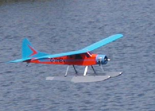

Hello; We have at least 4 Beavers flying at our local lake flying site, two big ones, one with a Saito 50 one with a OS 40LA, they are maybe the second most popular float plane here ( second to the cub). I have a Bingo on Floats with a Saito 80 in it. I am building an Otter on floats, the unionville one, I saw one fly in our annual float fly and was very impressed.[img]i/expressions/face-icon-small-tongue.gif[/img]
