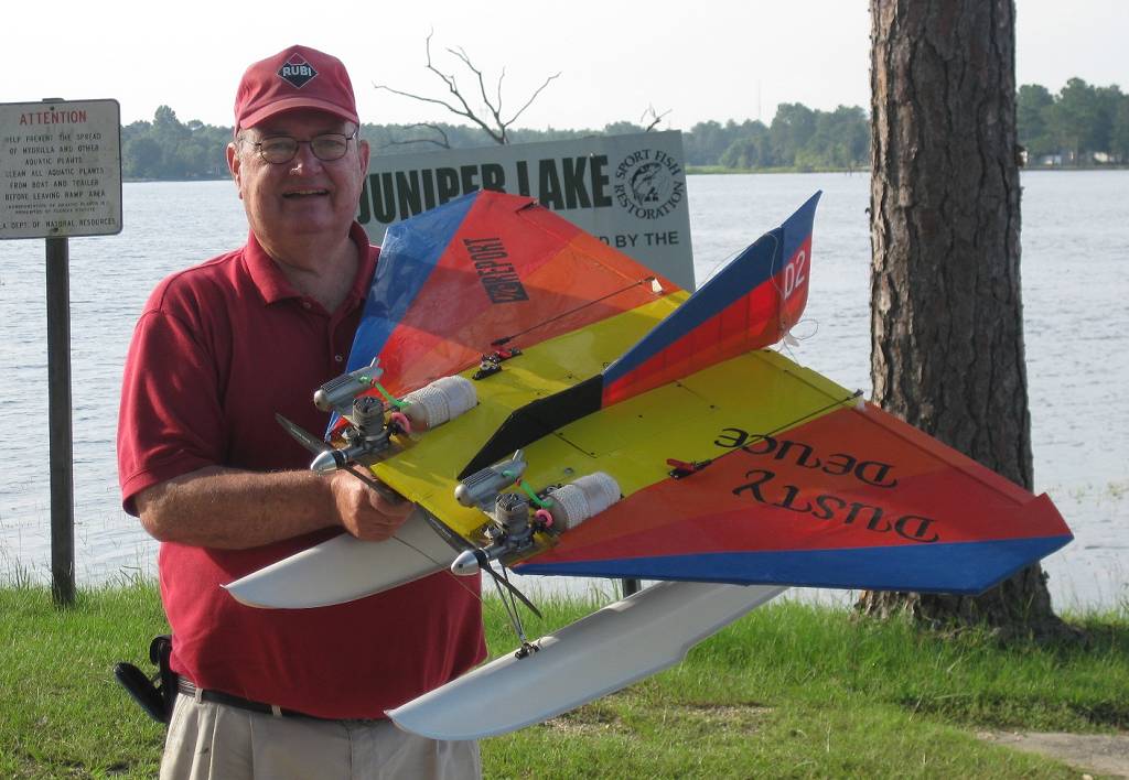

First, I had a Diamond Dust delta. Flew great. I decided to do a twin.
Second, came the Dusty Deuce, a twin Diamond Dust made by widening the center by 12 inches and using 2 OS .25FXs with Jett tuned mufflers. I did change to a single fin with a workable rudder. You need one of those on twins. Dusty was fast and nice to fly, but I finally grew tired of it.
Idea: I was taking the engines out in preparation for giving it away or trashing it, when I had this idea. Why not put it on floats!

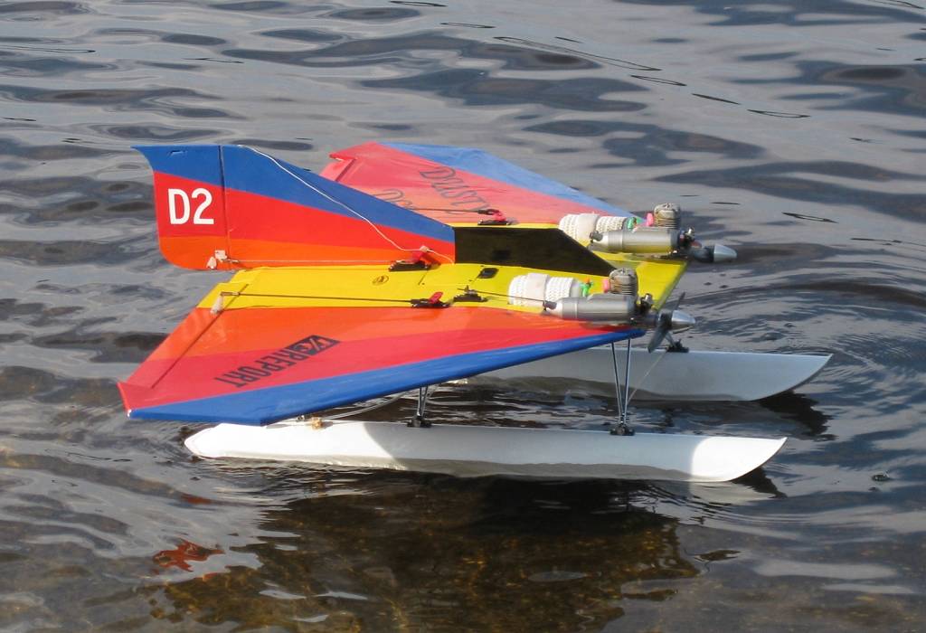

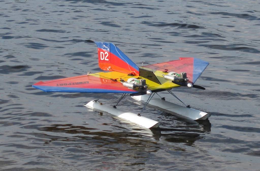

Third, is the Sea Deuce, the Dusty Deuce, twin engine delta on floats. I had some fiberglass floats that someone had given me and they looked to be the right size. Flying buddy and builder, Flaps Laffert, took the plane and added internal bracing and installed the floats.
I was also leery of flying my OS .25s and Jett pipes over water in a delta. I had available 2 OS .46LAs that I had originally bought for water flying. Plain bearings-no ball bearings to rust out. I checked and the LA .46s were not much heavier than the .25FXs with the Jett mufflers. In went the plain bearing LAs.

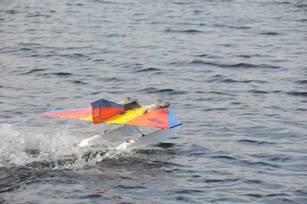

More pictures. I really flew the thing. It took a long run to get off. I finally figured out that deltas need a pretty high angle of attack on takeoff and landing and when I rotated, I dragged the rear of the floats, slowing my speed. Finally, the power yanked it off-see first picture. I have since raised the nose a few degrees more compared to the top of the floats.

Yes, deltas do need a higher AoA to take off. Float's designed for "ordinary" aircraft will not work well then, either you drag the rear of the floats or you need a much higher speed to take of.
To remedy this i sugest you increase the uppward angle on the flaoats aft of the step to make it possible to rotate more. A ordinary plane need to rotate 8 to 10 degrees on takeof, a delta might need to rotate 15 to 20 degrees. An unwanted by product of this is that the plane will ride nose high when taxing, as flotation is lostaft of CGas the float is cut away to allow rotation.
A taildragger type tri float set up, two front and one rear, might be a good idea as this can be arranged to allow enough rotation. Or go for two front floats and one on each wing tip for more stable platform

The same photographer with his long lens Nikon also caught me on takeoff. I was dragging the rear of the floats. I finally went to full up elevator and let the power yank it off. I have since added a 3/16 ply shim to the front struts. Hopefully, this will give me a little better takeoff.
