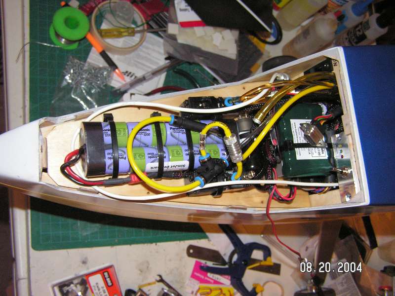

Are there any known issues with using 50 MHz radios with the Simjet 1200 SP?
I am seeing a large reduction in range. Antenna down checks with the ECU off are over 200' with the model sitting on the ground. With the ECU on, I get 20 or 30'.
Two different receivers on ch. 7 50.940 MHz.
I'll be trying another 50 MHz channel just in case it's a spot frequency problem, as well as the usual moving of things around.

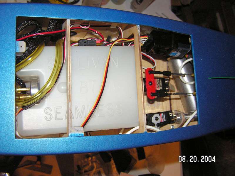

It's in a Facet 1200, with the Rx battery on top of the ECU. The ECU, pump, solenoids, ECU battery are roughly in the positions shown on the plans.
The battery and ECU switches are mounted in the positions provided on the first full-height former.
The receiver is mounted to the side of the rear compartment, next to the rudder servo. The antenna is strung to the top of the fin.

Phil, your installation looks alright. It is almost identical to every Facet I've done with the exception of the Rx battery, so I don't think it's that. Kevin or Ed should know about the 50 MHz, but I have not heard anything about it.
Trying another channel is a good idea and you may also want to try the test with 72 MHz, (may be a pain to borrow another radio, but may be worth it from an informational stand point). It wouldn't need to be anything fancy either as it is only for reference.

After spending some time walking back and forth with transmitter in hand I found that disconnecting the throttle lead from the receiver got the range out to something acceptable (10% reduction of the ECU-off range), provided I was on channel 9 (50.980 MHz) instead of channel 7.
I then tuned my scanner across the 50 MHz RC band. There was a general low level noise right across the band which went away with the ECU off. For the scanner to hear this it had to be within inches of the ECU. However, there was a peak at around 50.942 MHz which easily be detected by the scanner when it was placed near the receiver.
I had a look through the 72 Mhz band as well. There was low level noise similar to what I found at 50 MHz. There were one or two peaks as well, and a really strong one at 72.000 MHz.
If I listen to the noise detected by the scanner it does reduce somewhat when I disconnect the battery lead extension going to receiver. Disconnecting the throttle from the its extention significantly reduces the noise at the scanner.
I'll try a ferrite bead on the throttle lead, and see if I can arrange the Rx battery to be further away from the ECU. The ideal spot for the battery for balance purposes is an inch or back from where I have it, anyway. I did try moving it back by the receiver, but that didn't do anything for the range.
I also have a 72 MHz PPM receiver that I can use to see if the range reduction is less pronounced on that band.

I moved all the extra cable length to a bunch just in front of the ECU and put the receiver battery beside the top fuel tank. That way I could get acceptable range provided I didn't connect the throttle lead from the ECU. An optical isolator might work here, except that it would be a bit of a pain to have another battery just to power it. If I could get power from the ECU, or knew what the ECU input circuit was like I could figure something out.
