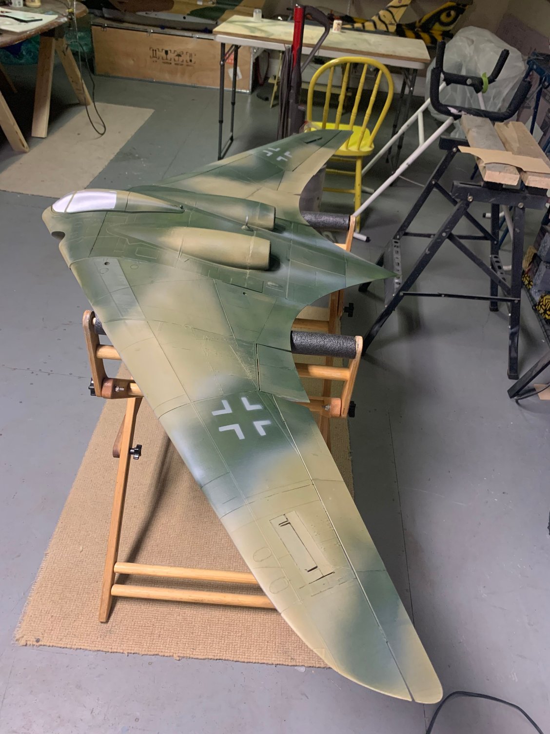

Anybody have any experience with this model? Not so much the building but I'm more interested in it's flight performance. Thanks.

I am not aware that any models have been successfully flown from these plans. There are no videos on Youtube. I would go with Gary Hethcote's Horten which has flown successfully and there are videos to prove it.

And if you want a bigger model, i have a 150% enlarged version of garys model. Garys model can be found at

Tell me more about your 150% version of Gary's model. I would like to use twin 90mm fans. Do you sell plans? Kit?

The prototype is flying on twin Jetfan 90v2's on 12s. Www.twmjets.com/ho229.html

Fresh from a talk from a friend considering building one of these. Have you wondered what would happen in case of a engine flameout? (and believe me, no matter wich brand you use it will happen sooner or later)

They dont fly... For long I know from first hand experience!

Guess that a Horten would be more or less like flying a Zagi flying wing without winglets, and with twin engines... Or a B2 without a flight control system.
Not an a easy task in my opinion too, unless some gyro magic is applied. Even so, the assimetric thrust issue in case of a engine flameout is still unsolvable.

It actually flies better than a Zagi. The model has very unique characteristics, but nothing really odd. It is very stable and a stall is very benign, in that you can pull full up elevator with 30* of deflection and the wing maintains wing level and begins a decent. No gyro's necessary!
I have even flown our prototype with the CG 1/4" aft of the calculated recommended point. It was still very stable and the only bad habits it picked up was that its coordination during turns began to suffer. As long as the CG is at the correct spot or forward of this point, it requires little to no drag rudder for coordination.
the engine out situation I had was with the VERY first power system (only 12lbs of total thrust in a 36lb airplane!). That power system required full power just to maintain level flight and had a very nose heavy CG position (1 1/8" further forward than the calculated position). The one power system also failed after a moderate speed pass. I'm pretty sure with a better power system (such as what is installed now) and the correct airspeed being maintained (and some altitude for extra assistance), It could be flown back around for landing.
It is a very unique airplane and gets allot of attention no matter where it goes. Its an amazingly good flier as well once you figure it out, which we have already figured out for future customers.

Easy to get hung up on worrying about the asymmetric thrust. I believe all those that have made large Horten ho229 either with or without turbines still have them. The engines are very close together and the plane was developed from a glider. The only problems come when lowering the retracts too soon and we never drop ours till we are over the threshold. a 6" diameter nose wheel acts like a rudder! We have twin MW44's in ours. We did have an engine run out of fuel on the first flight so we simply cut the power to the remaining engine and glided in.
Gyros are not needed, though we have one on ailerons on our Horten.
